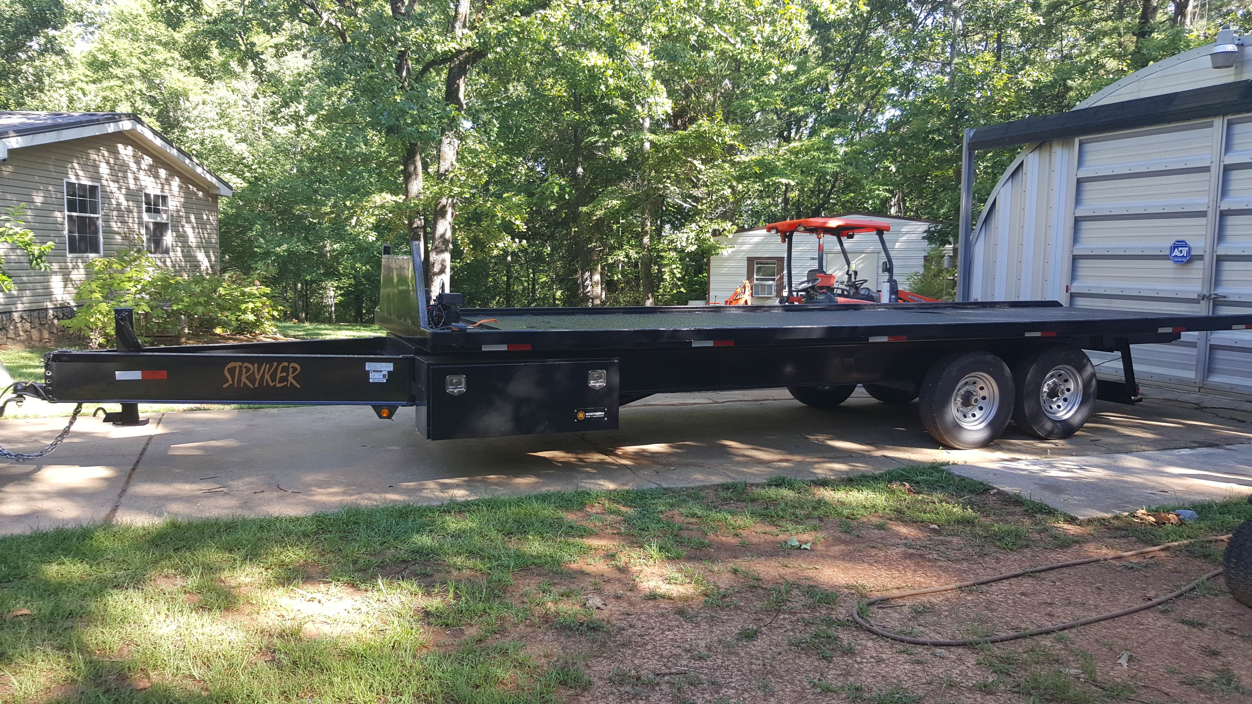

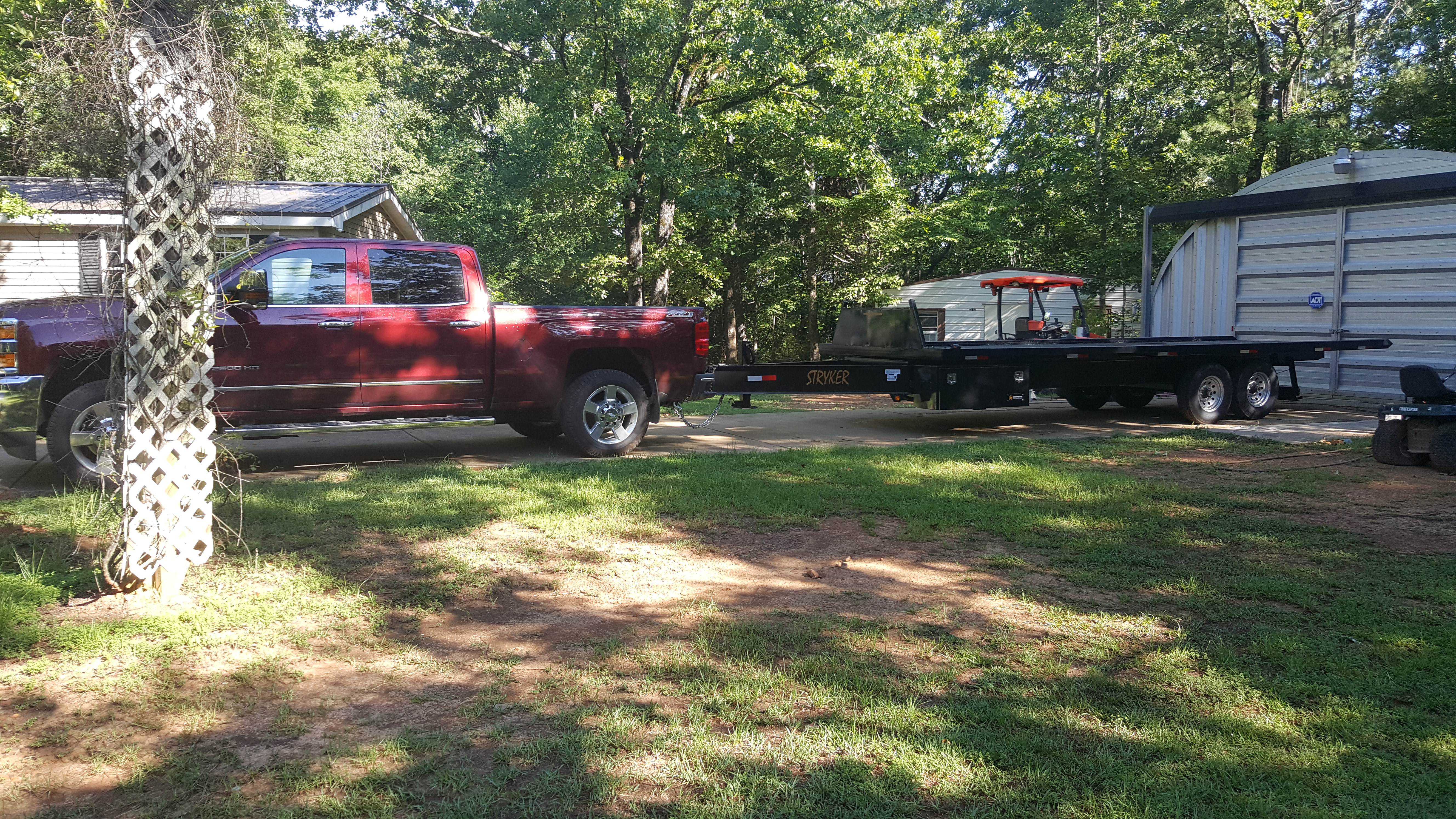

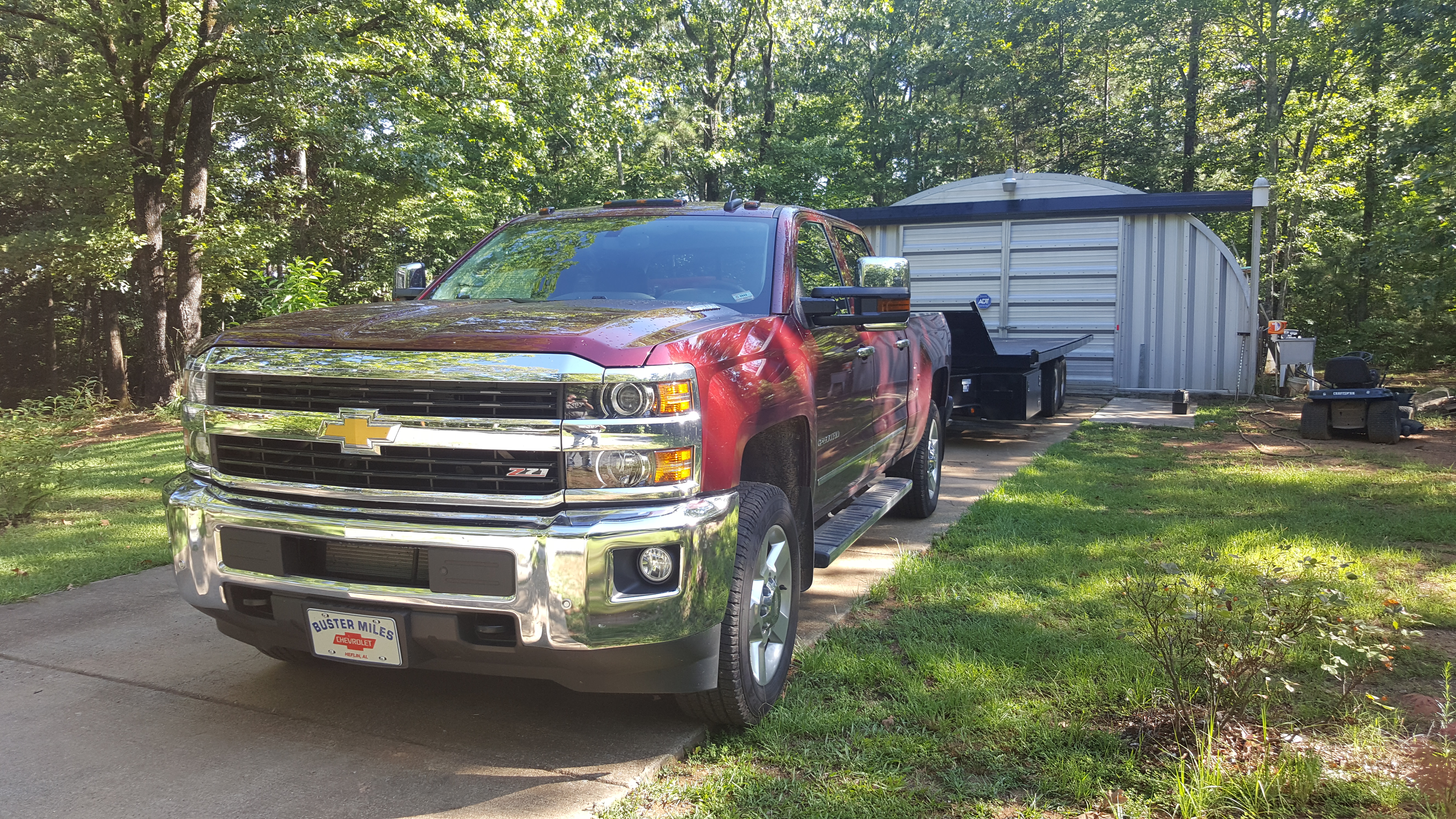

according to builder the trailer is 5000 lbs but I have not gotten a chance to weigh it yet. I have mixed numbers on the truck one place I read 18,000 lbs and another place says 14,800 lbs but it is a 2016 Silverado 2500HD with the Duramax and Allison combination.

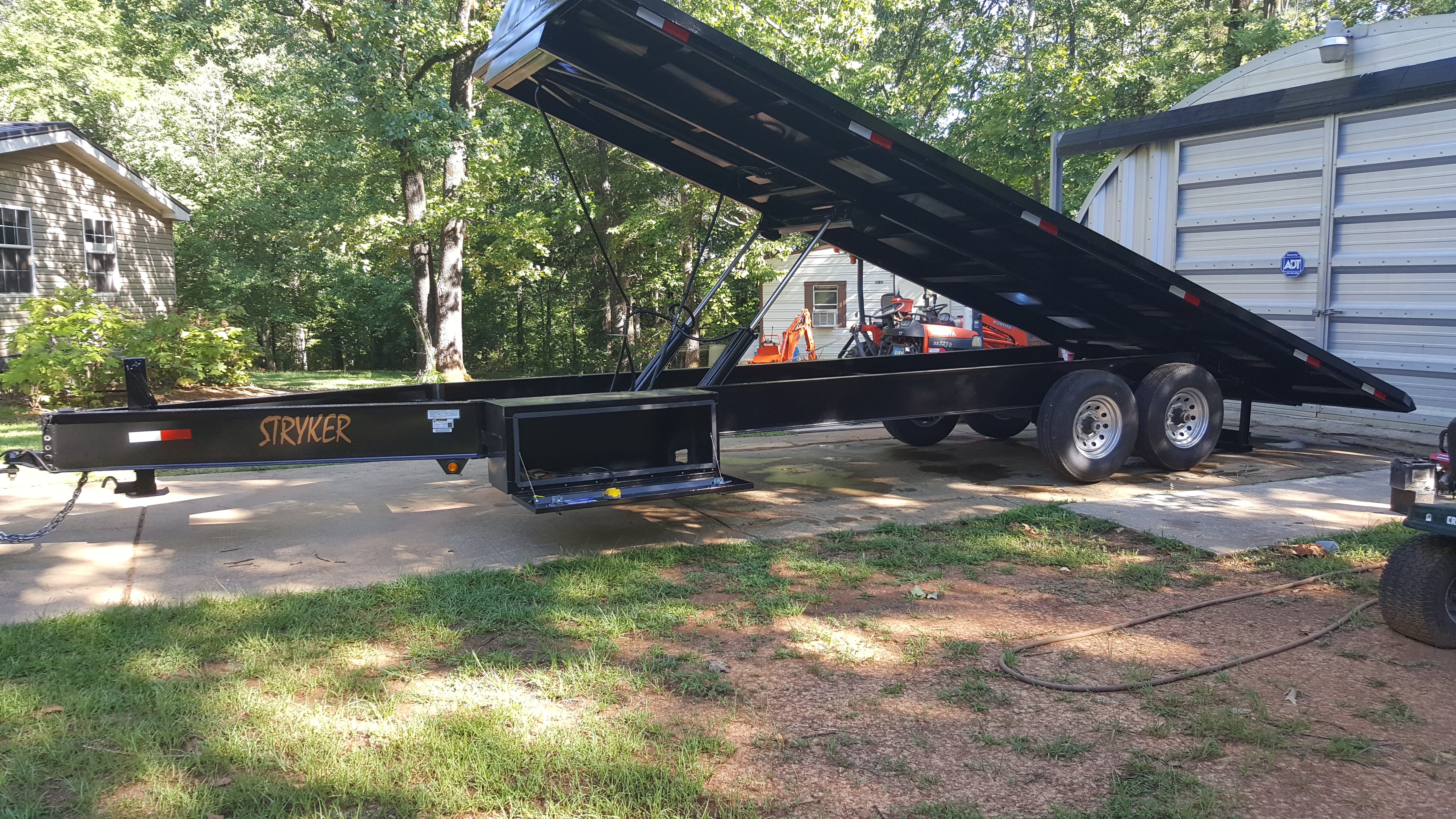

I bet there is a degree of pucker factor when loading and unloading equipment on that thing.

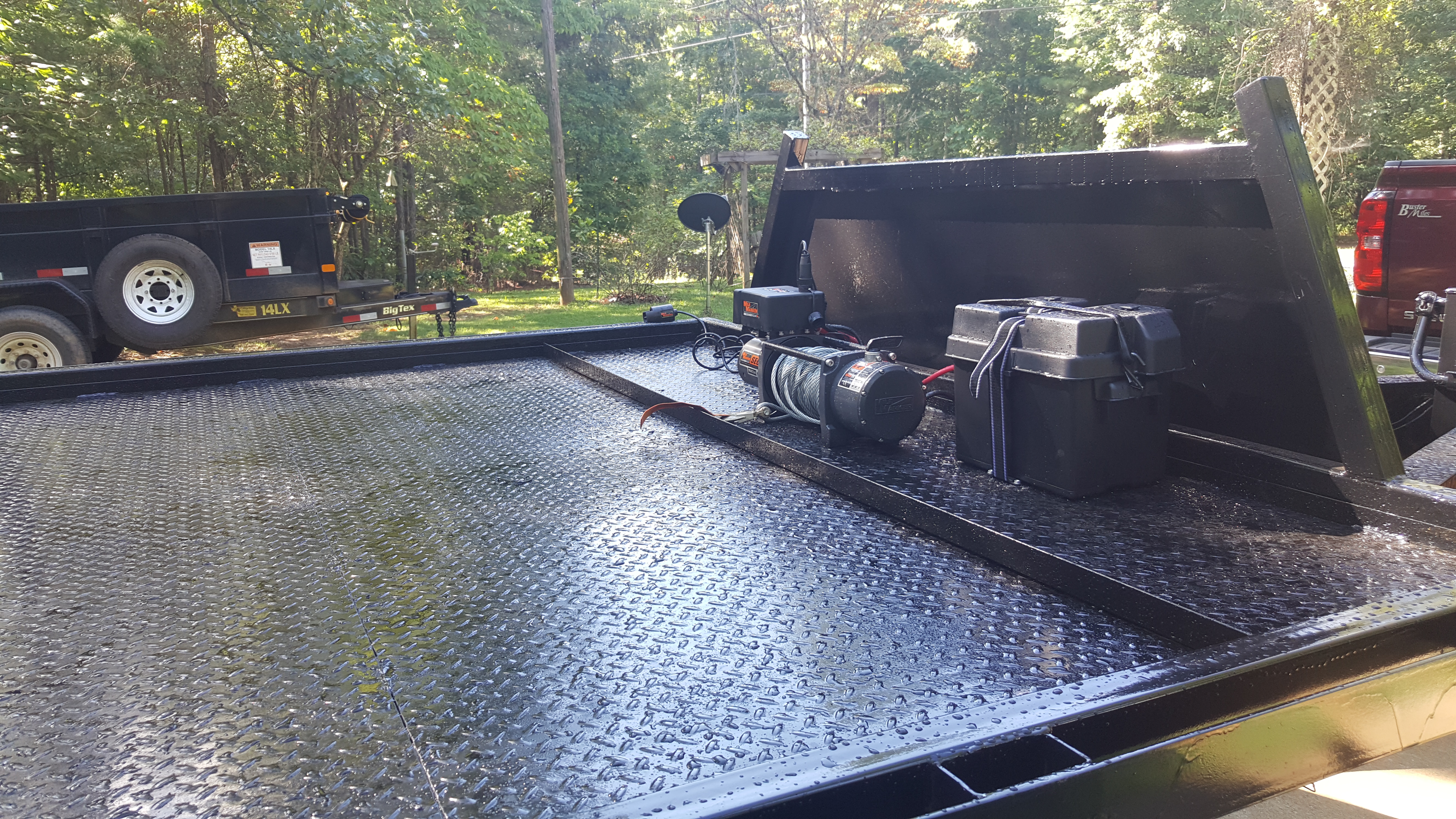

as soon as I got it we loaded my grandsons van and carried it to the transmission shop it was the easiest I ever load and unloaded a vehicle that was not drivable. He done the steering as I was running the winch and lowered it as soon as the tires cleared the bed. I have not had a chance to load the tractor yet.

You should have s manual, but you should of also received a duramax manual. Numbers are all posted in there. It should be listed as 5th wheel and bumper pull.

I believe I read 14,200 in the book

That's pretty slick but I would strongly consider a pintle hitch setup and 2.5" hitch shank. As far back as the axles are it looks like it would be quite a bit of weight on the truck.

the trailer is tongue heavy and I pointed that out the first time I saw it, when I brought it up he said to slide the bed back a little if I had it loaded to heavy in the front so on my way home I felt like it was heavy and I slid the bed back about a foot and it pulled like a different trailer. I am considering sliding the axles forward or shortening the tongue.

So max capacity is 9200lbs. That should cover all three of your listed machines. Sounds like a good photo op to me... :)
