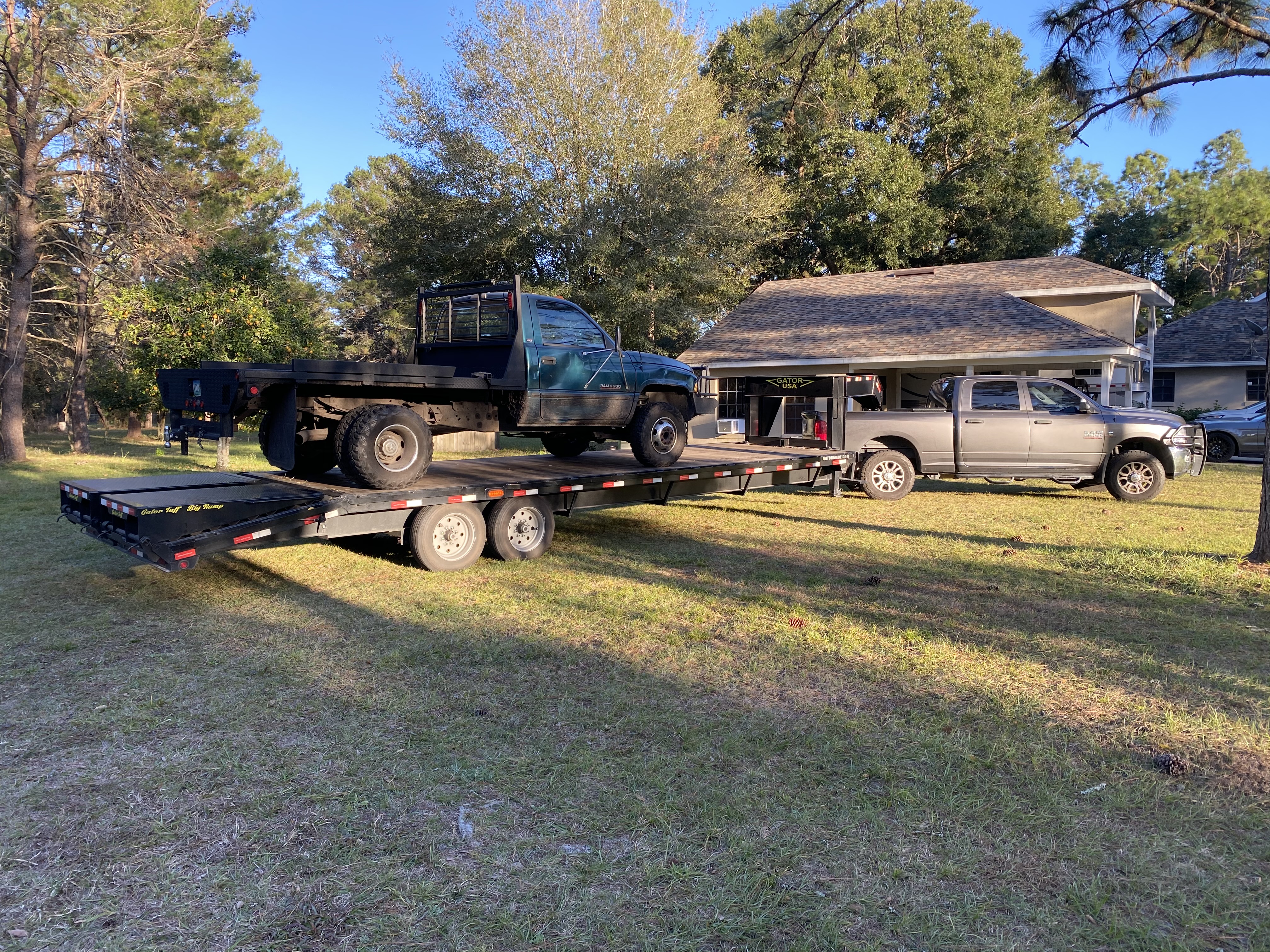

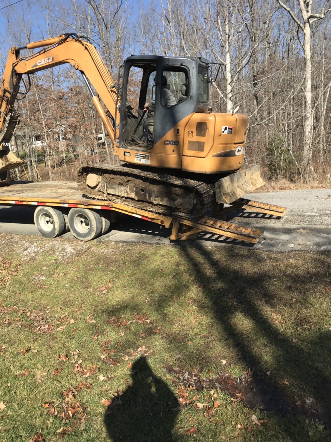

My deck over trailer is already bad to load. You’d need 10’ ramps to reasonable load without a dovetail. IMG_9482.JPG

My deck over trailer is already bad to load. You’d need 10’ ramps to reasonable load without a dovetail. View attachment 685416
I got a lighter duty equipment trailer (14k) but it has roughly 55" ramps. Even with the dove tail my SCUT feels like I'm climbing Everest. I'm debating what to do. I want a minimum of 6' but I've looked at some 8'. I also need to figure out how to handle my narrow front end tractors.
   / Your towing rigs and trailers #3,726
I think it normally feels a lot worse than it really is. We went away from ramps a few years ago for our delivery trailers. We can justify multiple trailers as a business, I realize not everyone has this luxury. For our everyday deliveries of compact tractors, we use 14.9k GVWR tilt trailers. 6' fixed deck in front, 16' tilt portion. That allows a couple of implements to be set up on the fixed portion, and it gives us a fairly gentle ramp angle. And we aren't messing with ramps. We rarely approach the max GVWR, but it's just nice to have a bunch of margin when hauling daily. 17.5" tires, oil bath axles, hidden winch. For the heavier or bulkier loads, or doing multiple tractors we have a 32' hydraulic dove gooseneck. We use that much less and it is a chore to get into most driveways.
For times when we need a really shallow ramp angle, like hauling a car for a friend or something, we built some 4' long ramps that taper to nothing on one end are about 8" tall on the other. Made out of 2" thin wall tubing and angle iron cross pieces, so they aren't a chore to carry. They have a notch so that the tilt trailer (or hydraulic dove) can set down on them. That extends the ramp so to speak and makes a very gentle ramp angle.

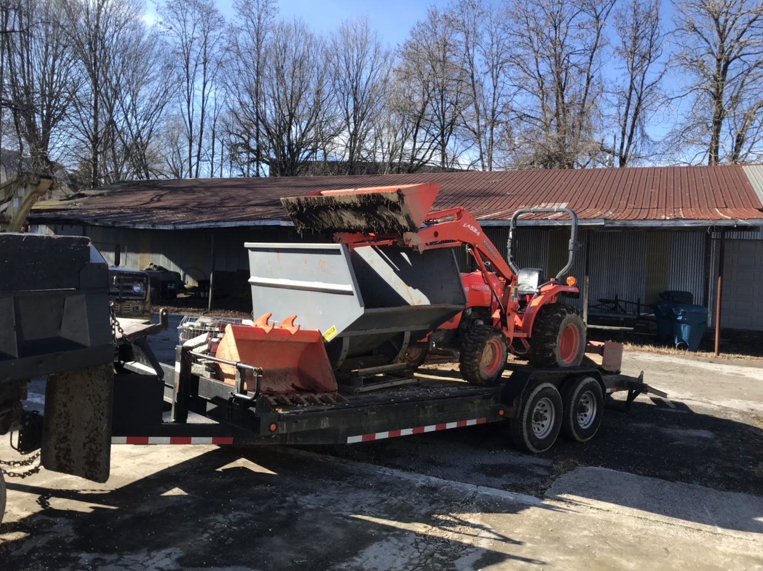

If you were delivering tractors everyday a tilt trailer would be a definite advantage. But the downside is they weigh more and cost twice as much and are more limited for loading stuff and then driving on. IMG_9434.JPG

If you were delivering tractors everyday a tilt trailer would be a definite advantage. But the downside is they weigh more and cost twice as much and are more limited for loading stuff and then driving on. View attachment 685463
It's all a compromise. The 6' fixed front deck on our tilt trailers helps with some issues. Tilts aren't so good loading an excavator or Bobcat in slick conditions either, ramps work best for that. And your point on the tilt being heavier is very true. As mentioned, in California if your trailer is over 10k GVWR it requires a CDL. Trying to stay under that with a heavy-duty tilt doesn't let you carry much. I gave up long ago and got my CDL.

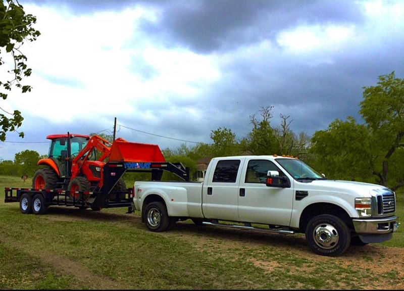

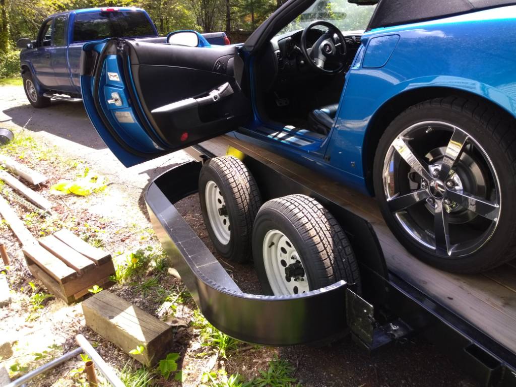

I have 4 trailers. A large camping trailer, A dump trailer. A tilt deck, and a deckover flat bed. With a dump trailer that has stake side there is no need for a utility trailer. It dose that job well. A tilt deck is the best way to go for equipment and low cars both. Mine has a fold down left fender so my Vette doors open on the trailer. I added hydraulic lift and a winch to my tilt deck. The hydraulic lift makes it so you can drive up and set something on the front and still drive off. Also if you load a pickup it won't tilt before the rear tires get to the deck. The one I use the lest is the deckover. But when you need to load from the side it is the only way to go. I keep all under cover. I store implements on them. The deckover is the easiest one to load and unload them from. It has stake holes and I have 2 foot high sides for it that are easy on and off. But for a bundle of lumber or some other large object it is the best way to go. Plus the deck is 8.5 feet wide. The tilt deck is 8.5 feet wide at the fenders but the deck is only 7 feet wide. Just enough for a pickup between the fenders. A friend gave me a 16 x 8 fiberglass green house. The deckover is the only trailer I have that was able to haul that safely as it has a 20 x 8.5 deck. It's the oldest. I built it myself in the 80s. The travel trailer is a 2001 I have had since new. The tilt deck and dump trailers are 2019 and 2020. I bought the tilt deck on my way to pick up my John Deere. I could get my old grey market tractor on the deckover but I was not comfortable driving a Larger TLB up those steep ramps. A trailer place had a sale on their trailers at the beginning of Covid and I have always wanted one. I was making a delivery there and saw the sale sign. So I clocked off for lunch and picked one out and paid for it. When I went back the following weekend to get it they had sold all of them. You never find them on sale so I grabbed one. I don't know how I got by without it for so long. Well I do, I shoveled stuff out of my truck. But I am getting too old for that now.
View attachment 685582View attachment 685583View attachment 685585

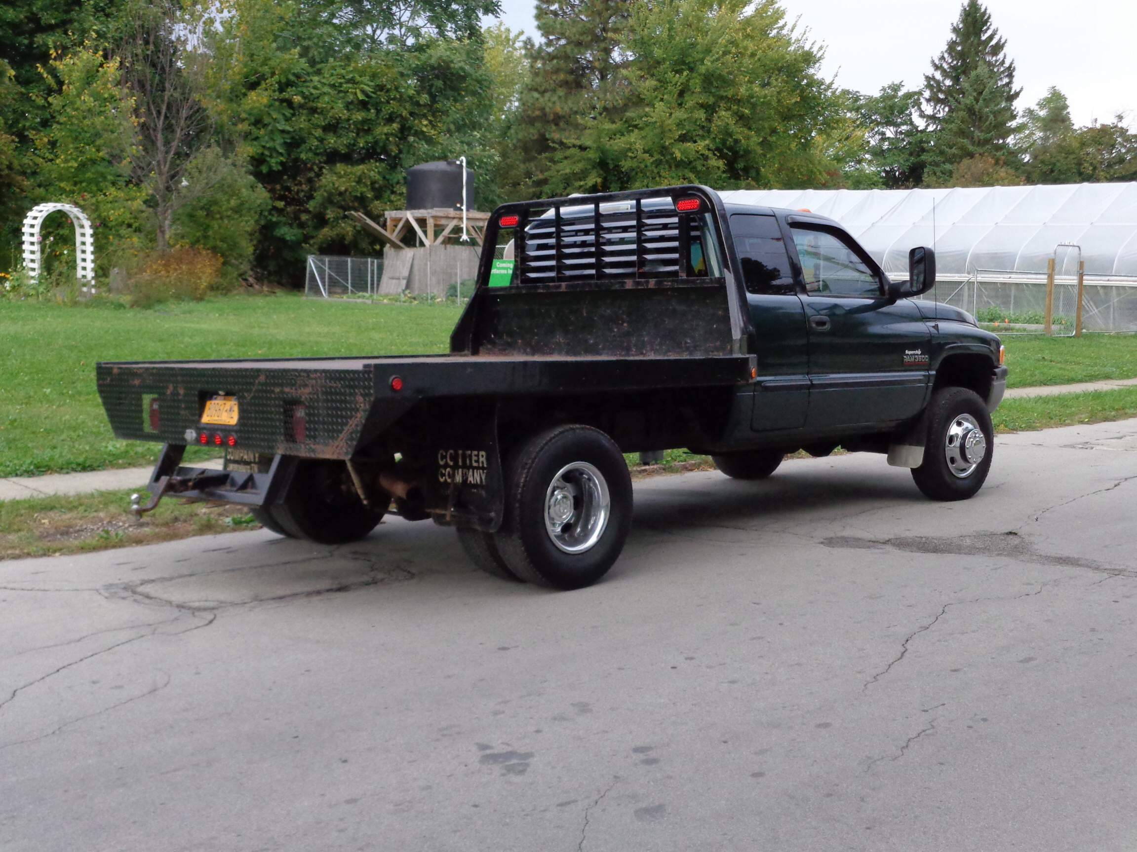

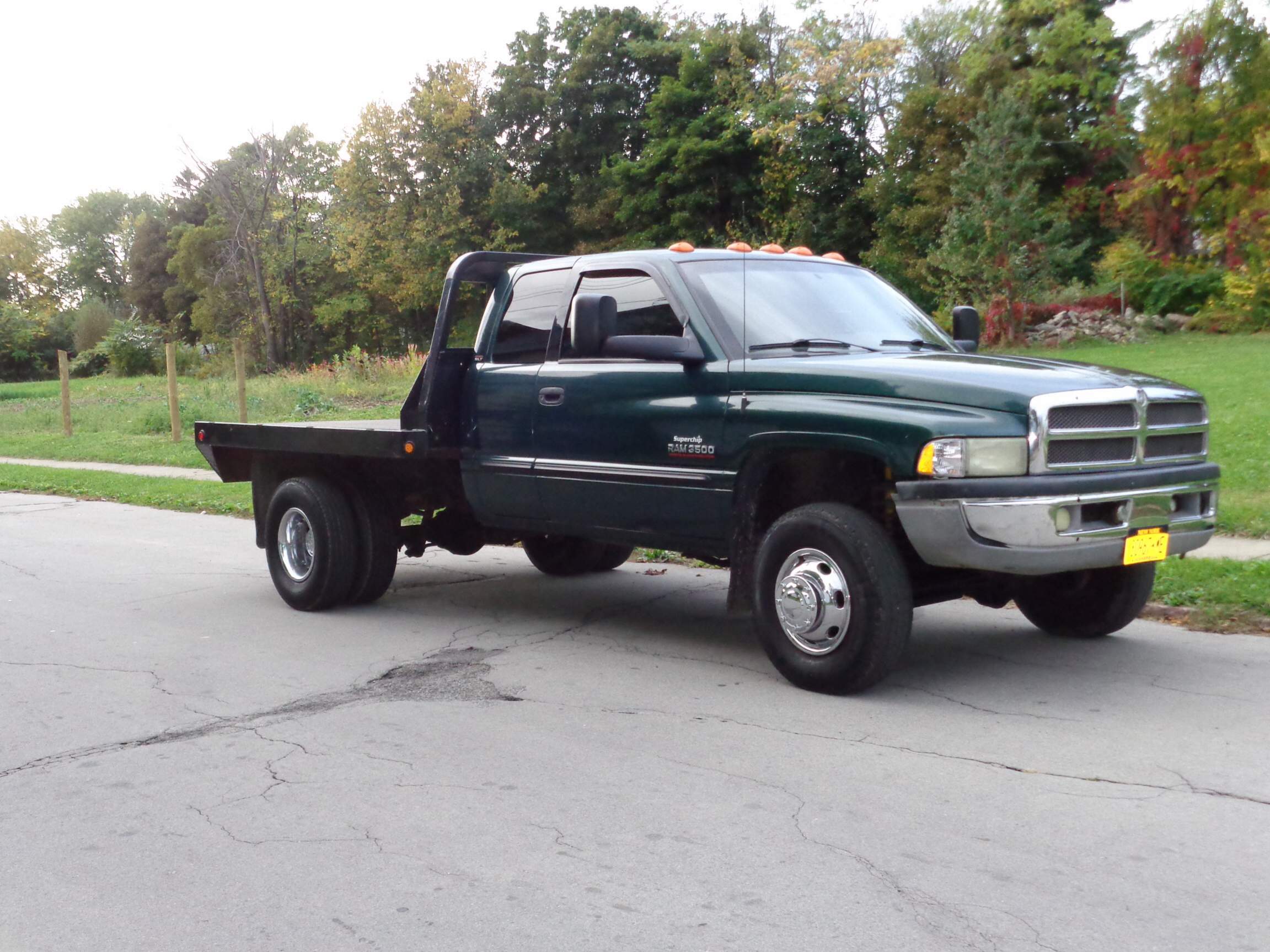

I hauled my '99 dodge up to Georgia to get a new flatbed installed. While there, I picked up a used squeeze chute off of Craigslist. I had the trailer pretty well packed heading home. The trailer handled great and the load was at the limits. I don't think this load could have been any better positioned or any heavier without exceeding the limits (technically the trailer was 400 lbs over).

My ton dump scales at 7200 pounds. That trailer looks like 8,000 pound axels. How were you overweight?

Very neat! Are those fenders hinged? I have removable fenders on my Diamond C but they they don’t tilt over like that.
Just the left one is hinged. The right is fixed. The other photo that didn't load is here. 20201022_172610.jpg
