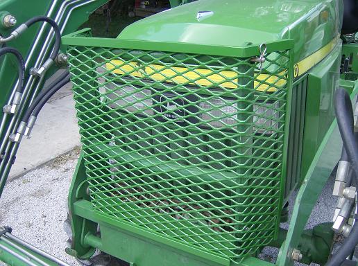

Nice looking grill guard for a total protection situation. Not much will get by that and the easy on-easy off feature very nice.
/ Your towing rigs and trailers #2,442
Thanks!
I made the grille guard myself: View attachment 469439 On/off with one long pin.
I'll second Pappy's comment! Nice looking grill guard. I have been inspired by a lot of your all's great grill protection setups and need to get to work fabricating something up for my machine too. A couple of close calls already using the grapple, so I better do it sooner than later!

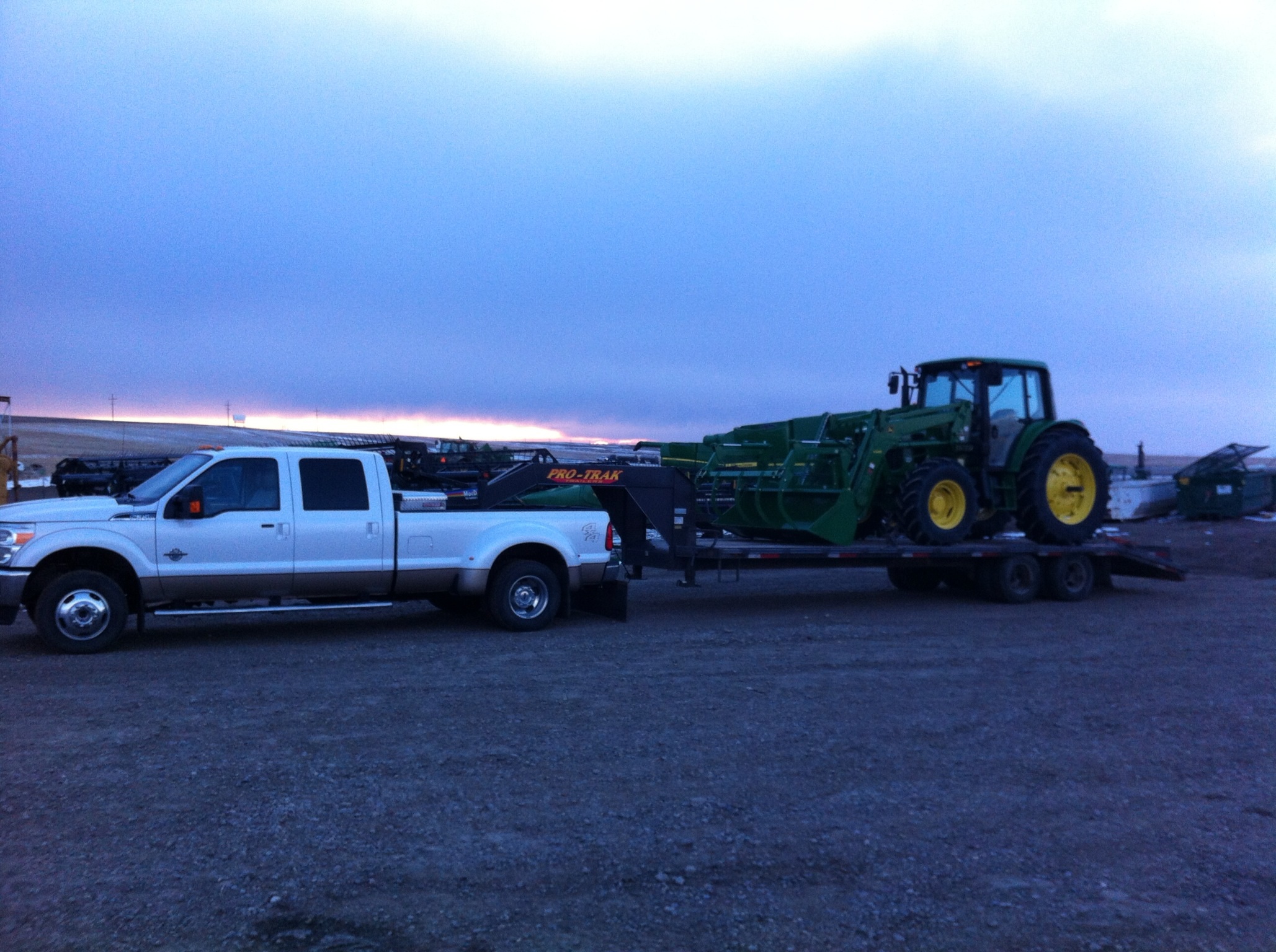

I borrowed the 7.3 for a 800 mile trip towing a 6k trailer in one very long day.
Nothing bad to say about the truck... got on the Highway 5, set the cruise for 60... never missed a beat.
I was going to take my smaller 1/2 ton gas pickup and my neighbor came over and with his keys and said I should take his Diesel... said why go over the mountains maxed out with a 15 year old truck.
It was very nice of him and his wife as I never asked.
I help here and there when he has some tractor work... mostly leveling a pad for water tanks and such.
