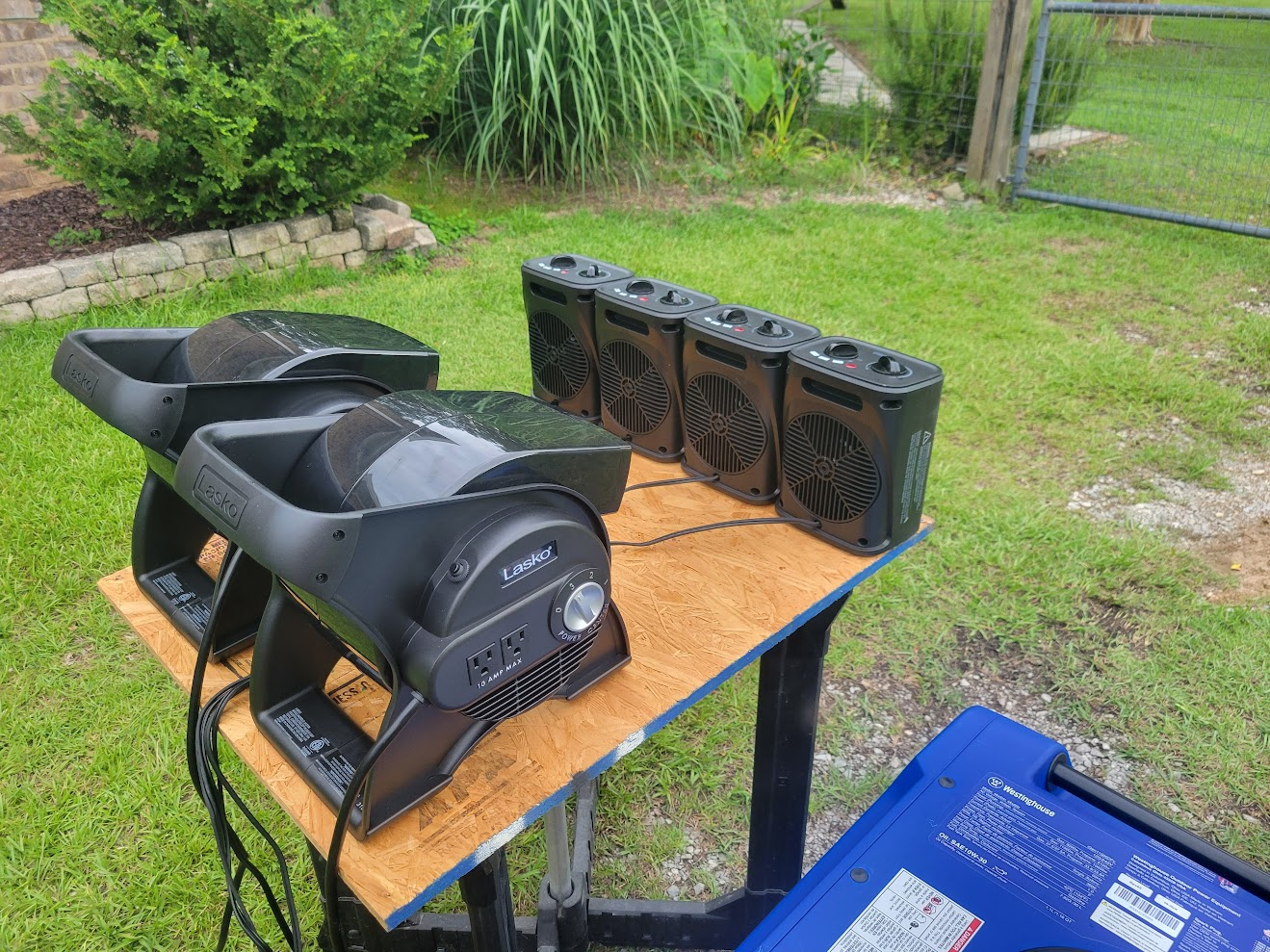

DIY 0 - 6.6kw load bank, selectable in 500w increments
Will touch 7kw for a few seconds when they are first heating up if you energize them all at the same time.
$32 for the 50a splitter Amazon.com
$18x4 for heaters. Can find cheaper ones, but I already had 2 and wanted everything to match. Amazon.com
Had the floor fans, might not need those depending on your climate.
Not bad for $104, and multi use for those heaters.
I do the same thing, you really don't need the fans, but it will ultimately pull more wattage on the ptc elements.
I guess these have crude thermostats and in the heat of the day here, they were cycling off intermittently without the fans.
Watched the waveform with a scope while under load running a big hammer drill and the serage grinder pump, no change.
Break in done, tested hooked to the house and running the sewage pump, oil changed, carb bowl drained, batt charged and disconnected. New gen ready for hurricane season and/or storage until next year.
