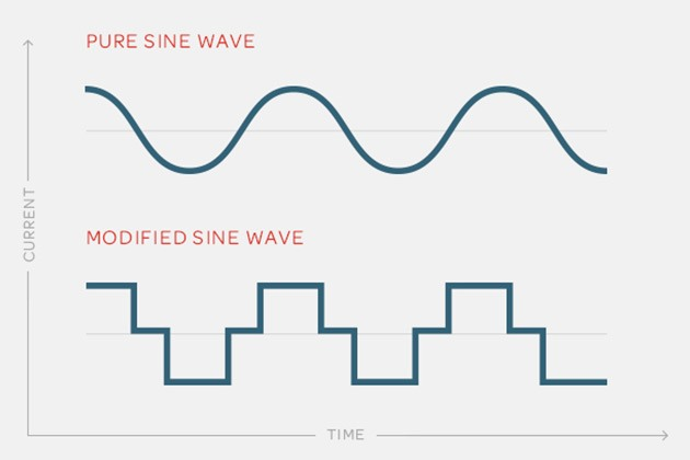

yeah, you want a pure sine wave inverter, not a modified sine wave.
A lot of UPS put out a modified sine wave, that's junk!

Depending on the quality of the inverter they can and have had issues with electronics as they are a modified sine wave and depending upon how many steps they make to make the full modified sine wave is important.
They are generally not modified sine wave. I haven't seen a modified inverter generator sine wave, most have THD below 3%
Modified is what my 1990 inverter is and it runs all my power tools and light boom but it will not run a Mikita or Dewalt cordless tool battery charger.
Exactly. "Pure sine wave" is pure marketing bullsh*t. There is no such thing, other than in theory. Check the THD spec, that's the proper metric.

I know that many inverter generators and power supplies advertise pure sine wave power. I have not stayed on top of the latest and greatest power systems but I know of no way to get pure sine wave except from a rotating field any "solid state" device is going to be a modified sine wave it may have enough steps and buffering to be almost indistinguishable from a true sine wave but it is still a modified sine wave.
