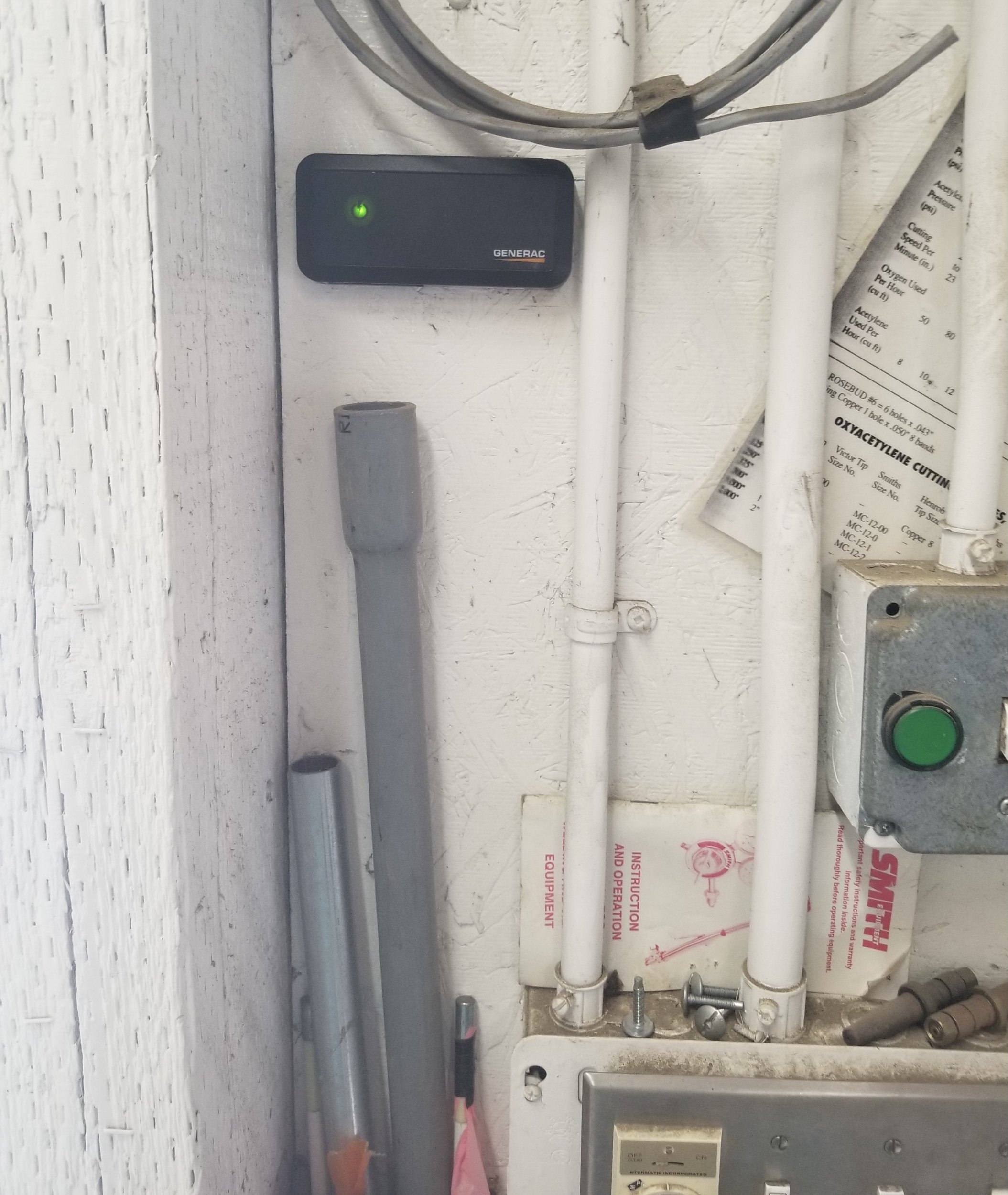

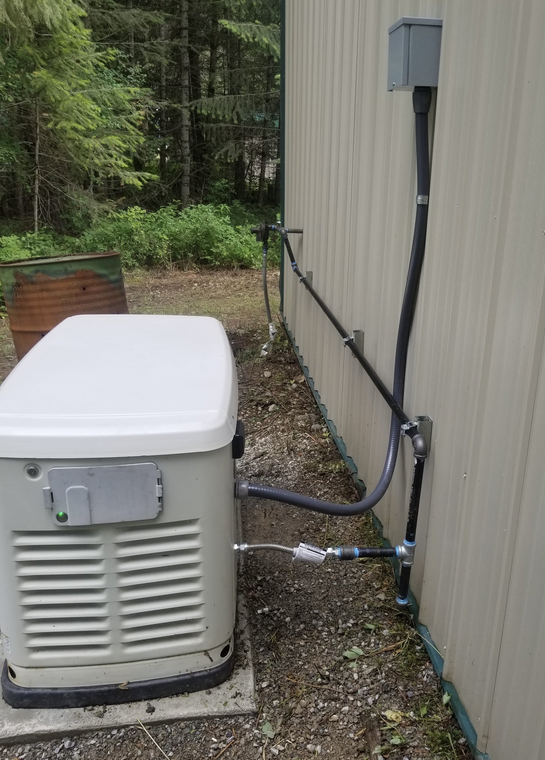

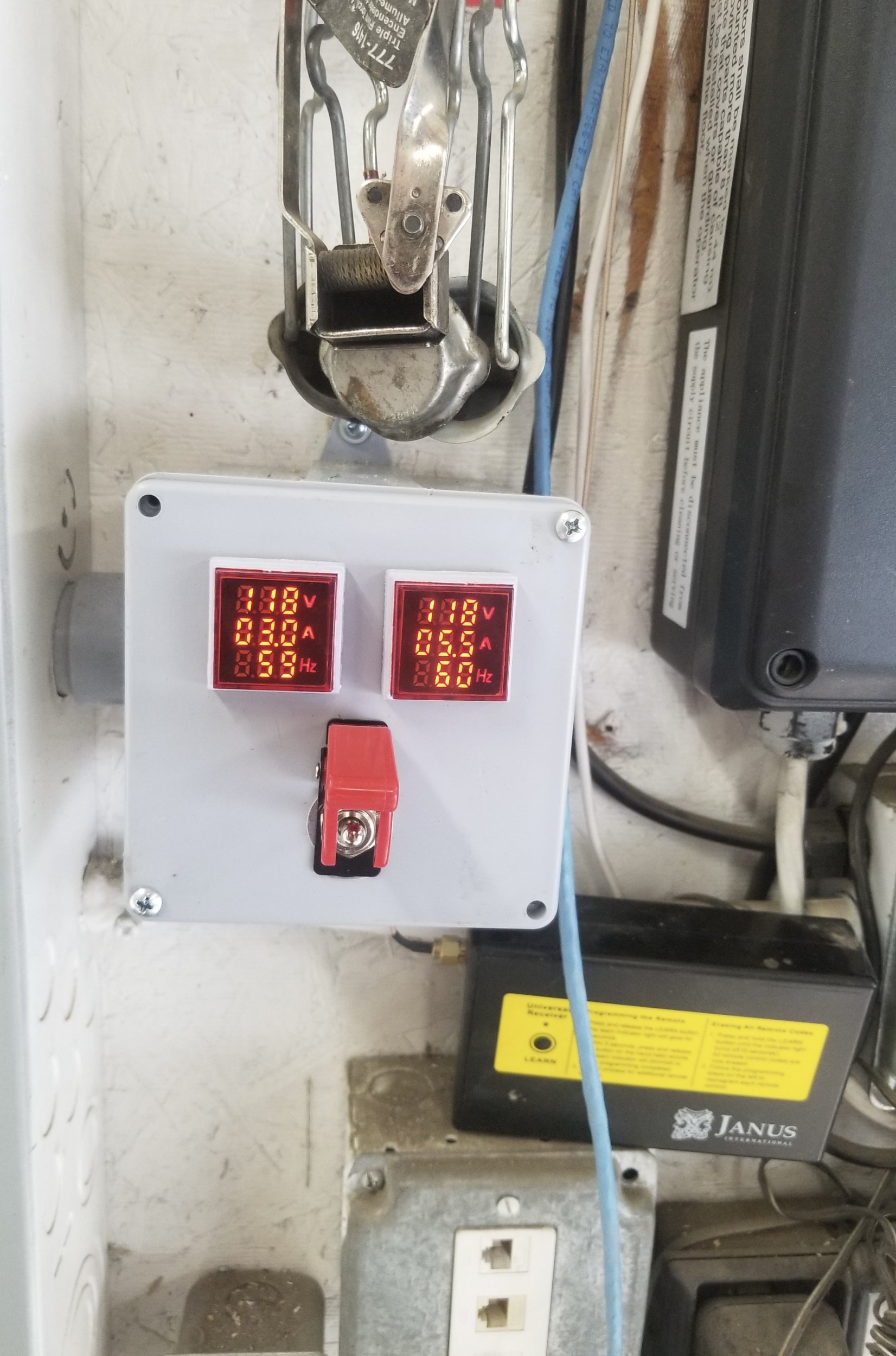

Got shop generator working today. Works great. Can turn it on and off from inside shop.
Installed a wireless monitor on it also to monitor faults.
