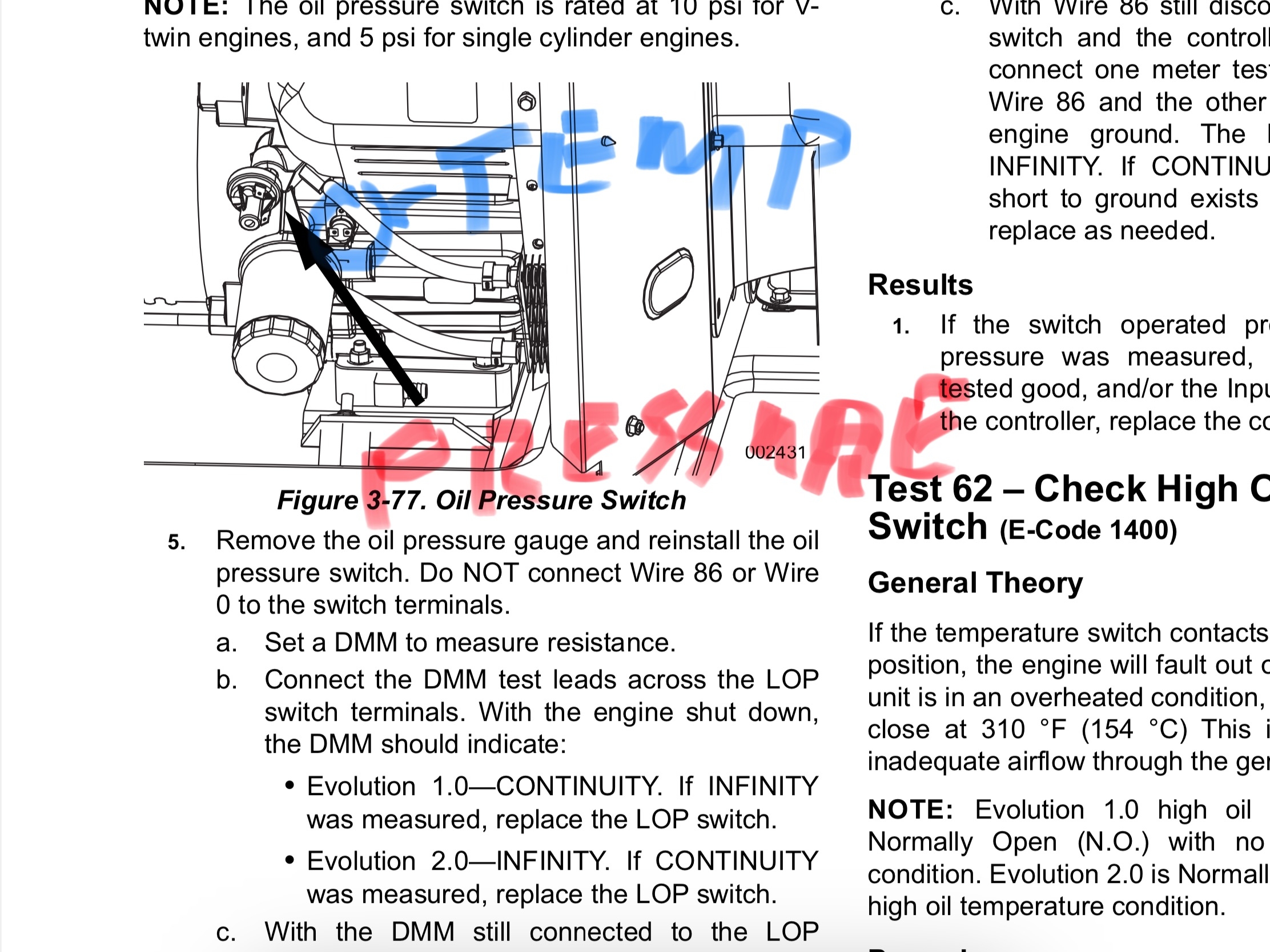

Here are the 2 sensors

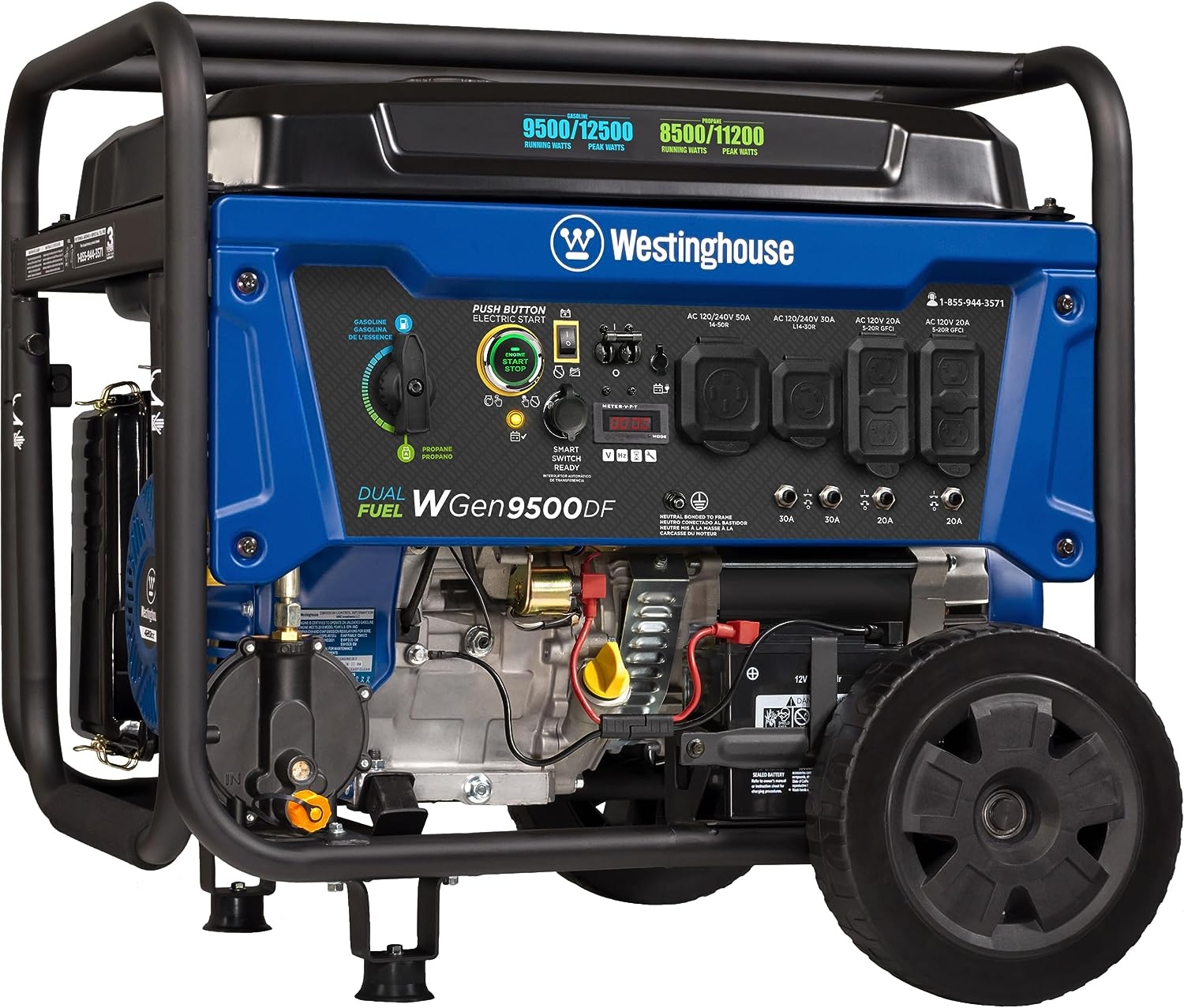

thanks, I'm impressed by this.
My Westinghouse sure doesn't have that.
I wonder if a conventional Briggs Vanguard say 30hp has a high oil temp sensor.
now the real question is how often have you seen these sensors do their job, or not?
if an engine blows, was it always due to low oil?
I'm curious how the low oil sensor works when it is positioned well above the oil fill line.
no oil pump, ?

My B&S whole house generator has low oil pressure and high oil temperature sensors. High temperature sensor did its job last year when muffler broke and overheated engine compartment. Generator is 18 years old. First repair needed except battery and normal maintenance.

Haven't played with the guts of small engines enough to be certain, but w/o an oil pump, I'm suspecting that crank-splash may be creating some low pressure baseline @ normal oil level.
^ Total guess though.
