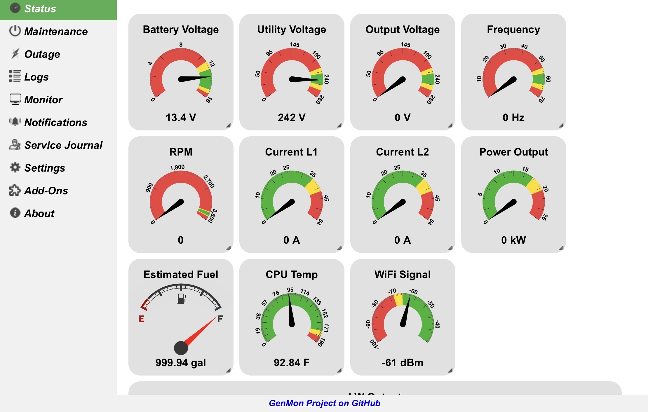

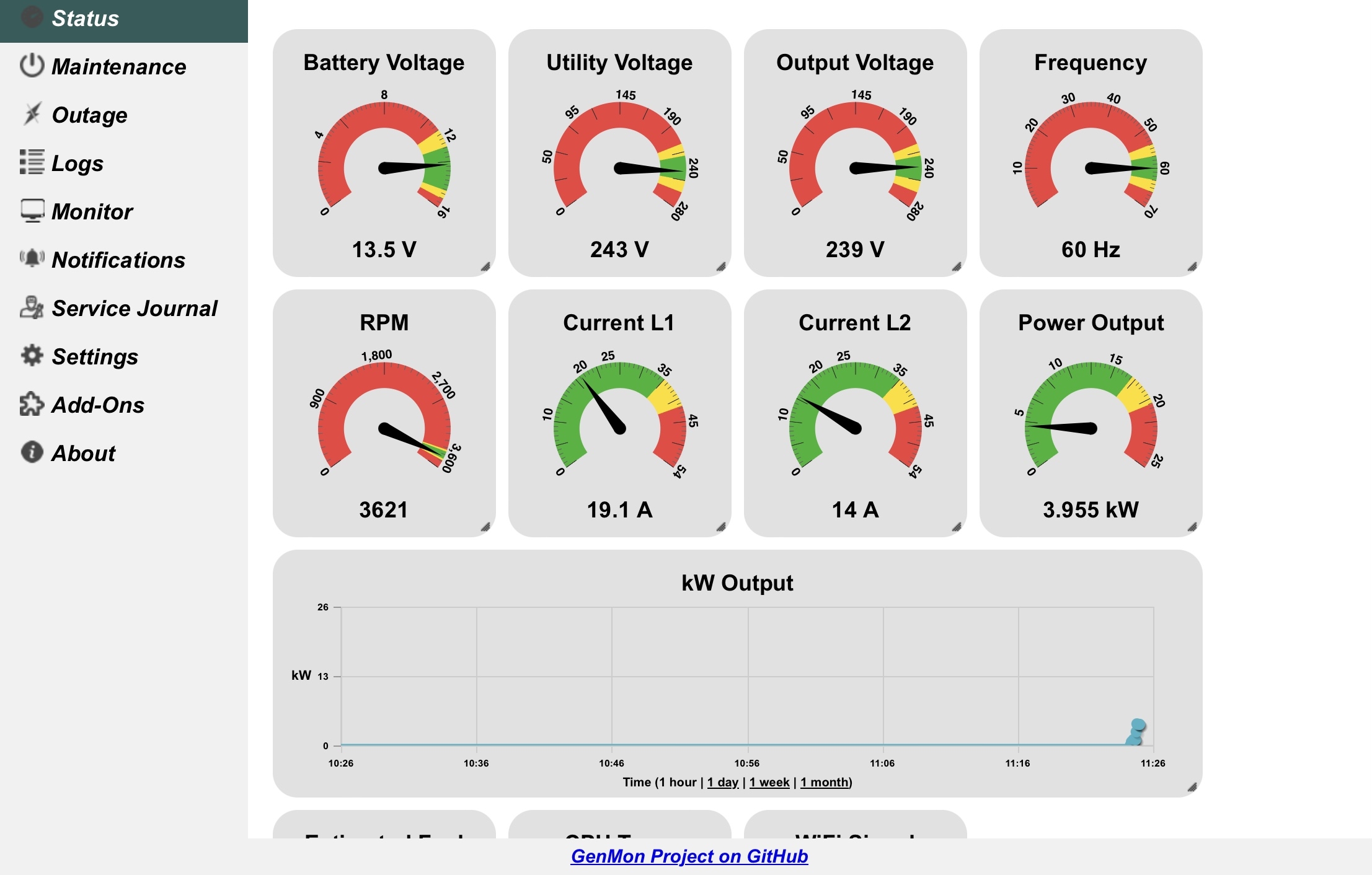

Had another power outage today. Got to watch the updated genmon controls. They added more monitoring functions. I took my wifi fuel monitor offline due to it faulting out after 3 years. To replace it i would need a yearly contract now due to generac buying the company….. im now looking for another brand of monitor. Plus, it should have lasted longer. Im going to stay away from tankutility brand. I did rearrange screen to show more gauges. I happen to do a screen save right as utility power came back online.

Telematics, done well, are a beautiful thing.... thanks for posting those g. Business "factors" can mess that up pretty quick though....
Subscription.... it's a great scam. Vehicles - why give you a keyfob or 2 when you buy a vehicle, when you can bang the customer with subscription fees for the same function on their own phone, AND you can turn around and sell the world all the data you pull from customer's phones !
Let us know what you pick for a new Fuel Monitor pls, inquiring minds are watching !

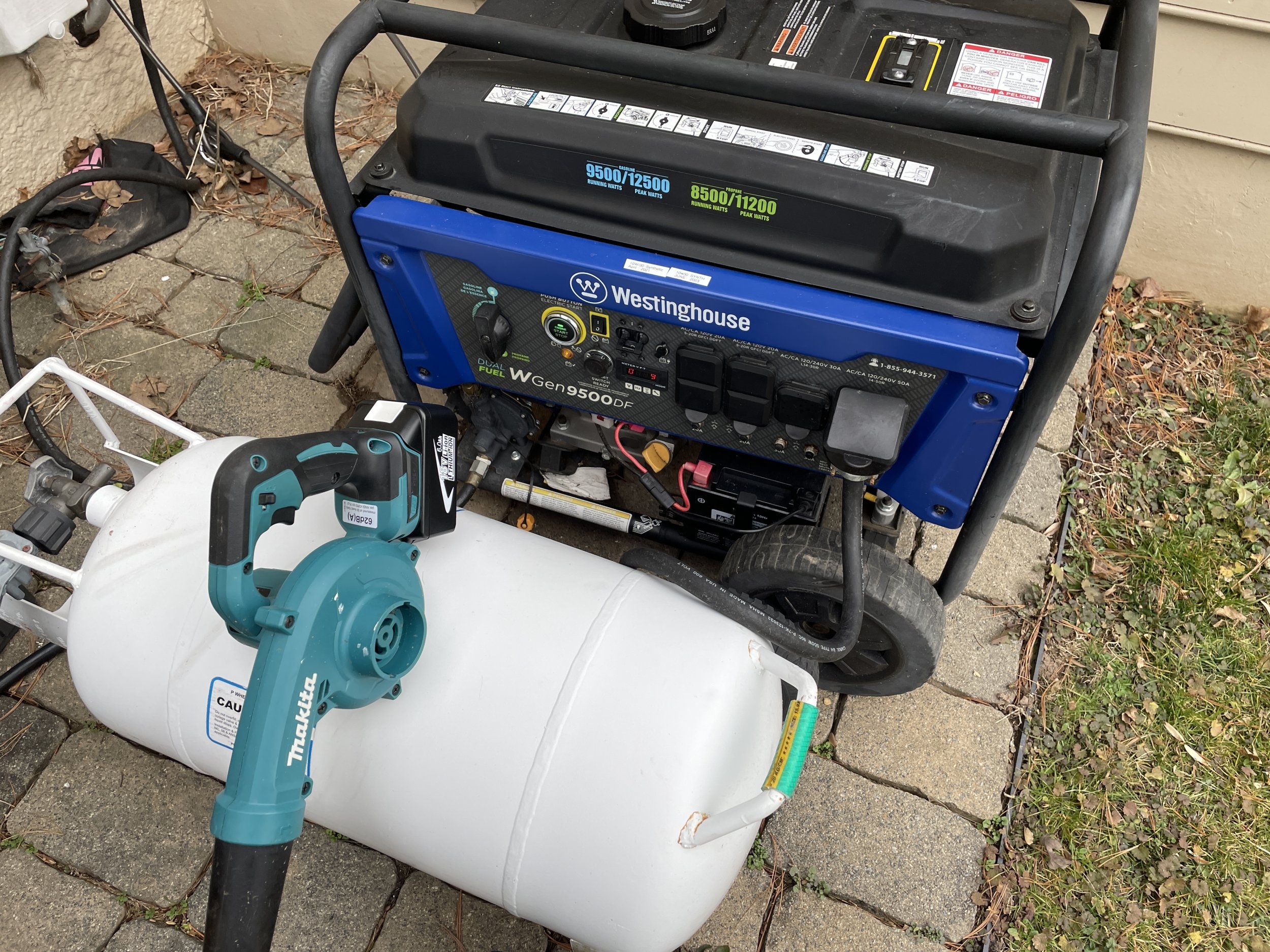

the afternoon before this last snow, decided to fire up the gen.
It started right up, and peanut shells and other stuff flew out.
immediately shut it down, got air blower and cleaned it out thoroughly.
I guess squirrels had decided it was a good spot.
it had been cleaned only a few months back, I guess winter time and a nice cover makes the
gen a happy spot for critters.
the little Makita blower works perfectly for this, one of my favorite tools

Ive been told if you place a few moth balls in a sock and stuff it under unit…you will keep them critters out.
might be old wives tail though
   / Your last generator Maintenance Run #6,526
I bet that would work great GRS, lots of critters don't like smell of naptha or whatever pungent smell that has.
I thought about spraying some peppermint oil I use for ants and keeping critters out of my motorhome. Cats don't like
peppermint apparently; I use it where my neighbor's cat comes and stalks my bird feeders. It works. Washes off of course

Critters tend to crawl under most any covering. Pondering your situation...... w/o going to a full shed, a box with a floor, slightly larger than the gen would be the minimum enclosure.
Obviously could be built from scratch. Depending what is around you (or on your travel paths) for equipment dealers, a non-returnable Shipping Container for "something" might be close to what you need. Might still need light mods, for a door/ramp, but wanted to float the idea..... Lady Luck may provide something on your travels this Spring.
