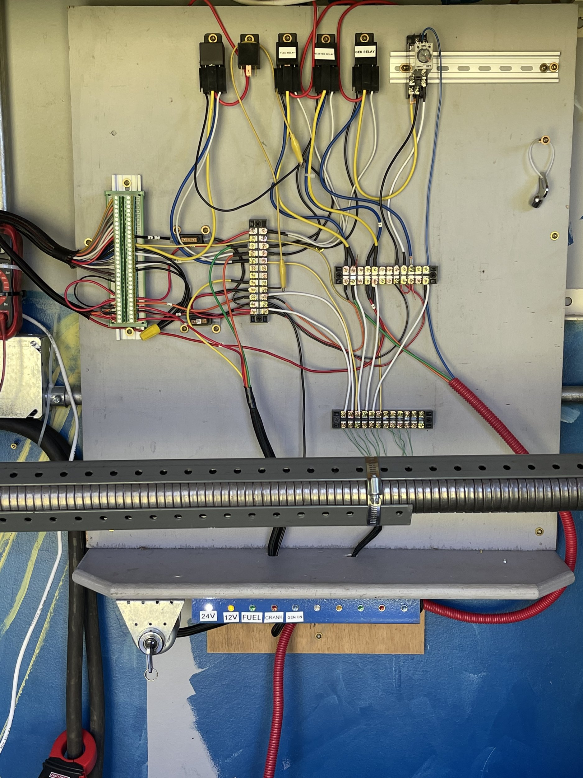

I just finished transferring the control wiring to a larger board so I could tidy it up. First time I’ve built anything like this any suggestions?
90cummins

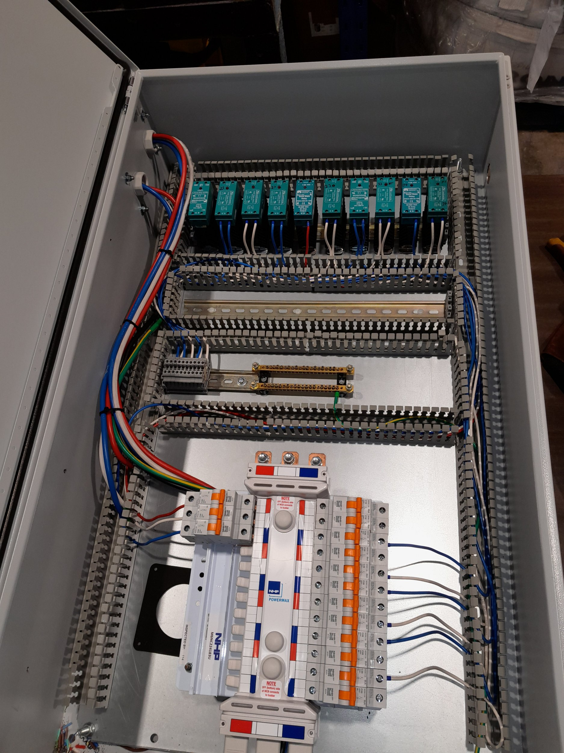

I quite like using finger trunking to keep the panels I build organised:
Above is a work in progress (one of the few non commercially sensitive photos I could find 😂) capping not yet installed on the trunking.

Patrick you are out of my league!
Beautiful work!!
I’ll look at the finger trunking that would work nicely.
