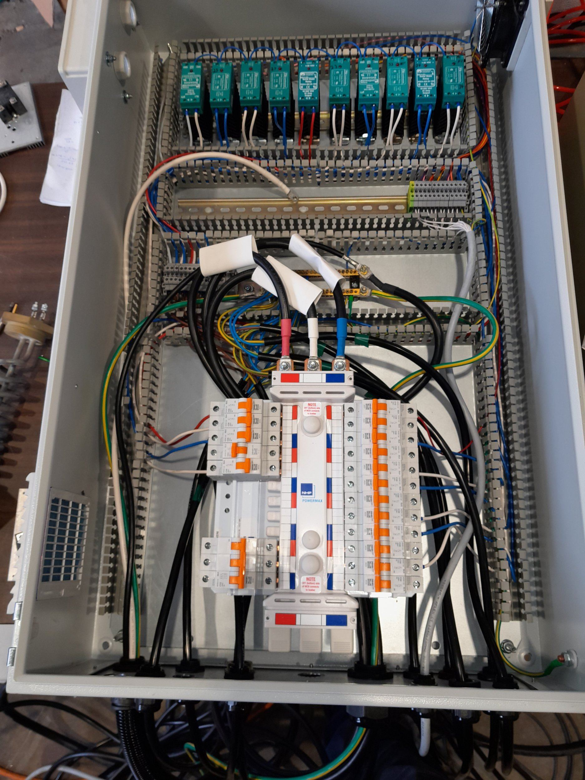

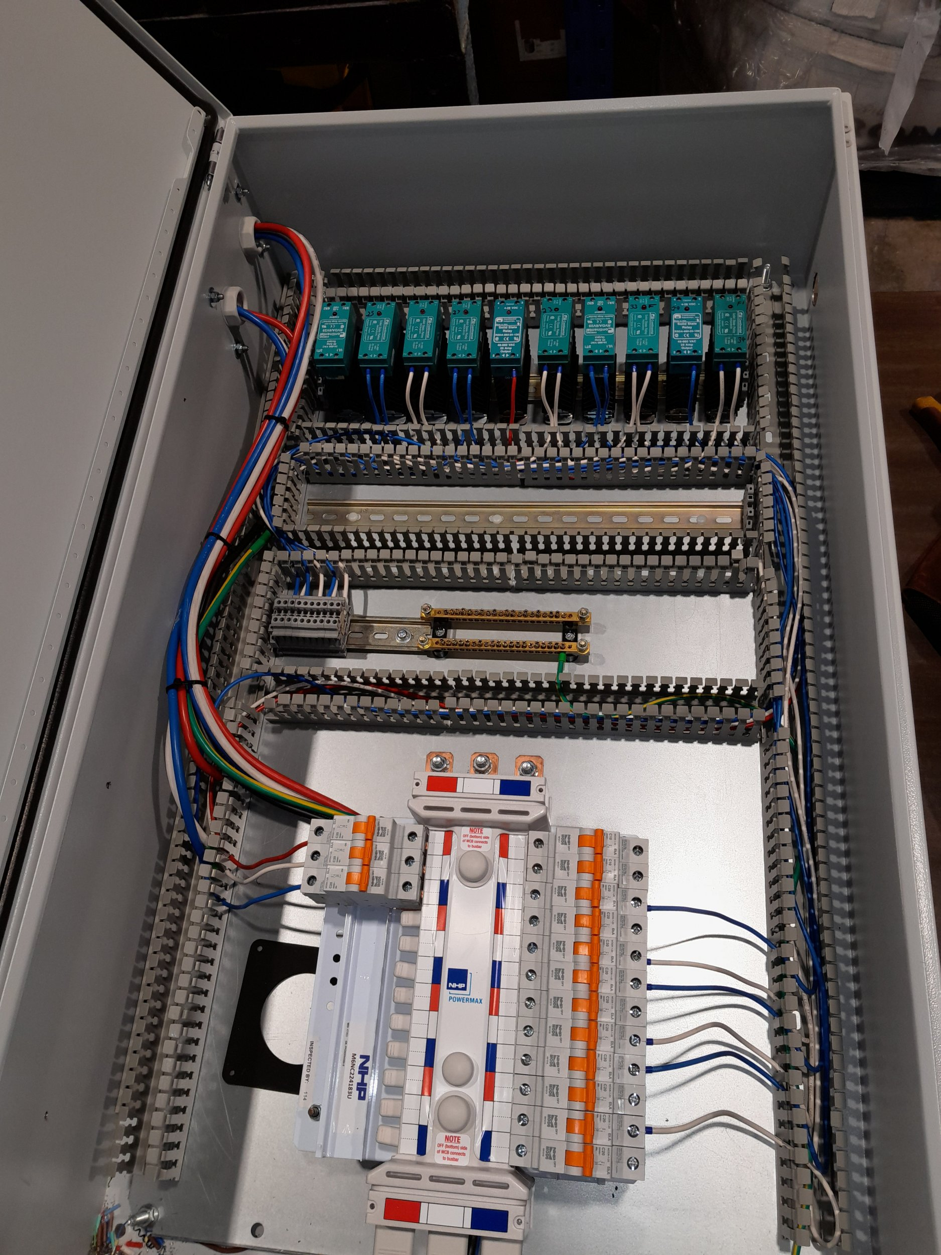

I quite like using finger trunking to keep the panels I build organised:
Above is a work in progress (one of the few non commercially sensitive photos I could find 😂) capping not yet installed on the trunking.

Nice looking panel.
   / Your last generator Maintenance Run #5,704
Nice looking panel.
Thanks, ruined by me installing it temporarily 😁

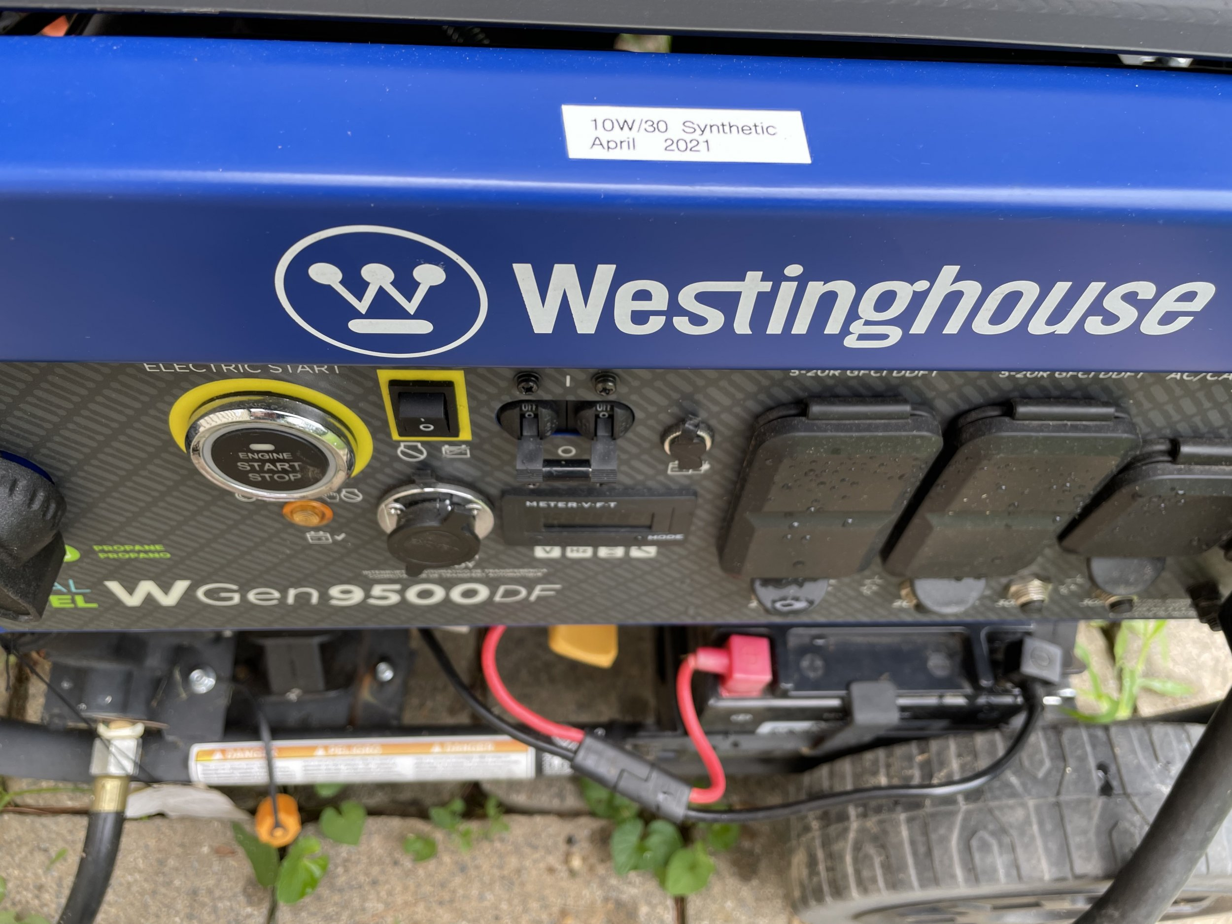

ran the Westinghouse for a few minutes this afternoon, just a follow up test after the bad on off switch replaced.
Oil full. Propane on. Press button. 1001 Vroooom
all is well
because of almost no hours on this, going to wait one more year on oil change. Full syn oil isn't going to wear out.
I'm just changing it to get rid of any condensation. Was changed once at about ten hours, and now likely around 25.
couldn't get the display to show hours, I'm sure op error. 246 volts thank you, but how many hours?

Good catch on the switch D..... not what you'd want to find out, start of a multi-day outage.......
I'm not a fan of non-intuitive instrumentation..... kinda defeats the point of a piece of equipment that sits a lot, then needs to be used NOW in an emergency....
I think I've posted this before...... Briggs is one that had hour meters listed on their site, for 3600 rpm units.... IRCC, they were non-contact, non-wired - I think they detected vibration. If your stock meter is a pain, you might consider a stand-alone one.
