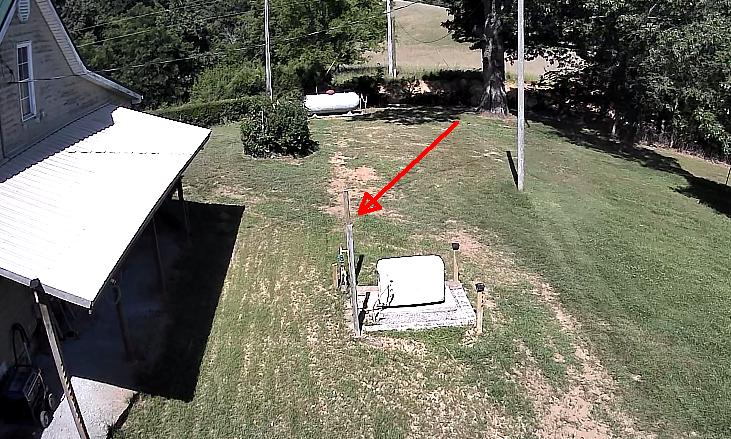

Generator is about 15 feet from the house, exhaust end pointed away and out into an open field. Intake (battery, status light, etc) end faces house. Due to terrain it cannot be further away. It's not terrible on the weekly test runs, but still noisy enough that it will be annoying on longer duration runs.
Considering setting a removable wooden fence panel a foot or two back from the intake end in hopes it will be effective in diverting/deadening noise. But I'm also concerned it might somehow do the opposite and pick-up/echo/amplify the noise.
Not sure how yours is enclosed now, but you may want to build a complete shed/enclosure - some nice designs on here, and countless on Ytube.... poking around on there, I notice Paul Short posted a multi-year update on his - one of the best compact ones I've seen.
To your panel question - I think you will get some reduction. Roughly in the middle of the vid below, the guy instruments a crude panel test, dropping about 10 db :
Rgds, D.

Dave, good video, funny how 10db less can be four times quieter. OSB board is heavy and dense; sheet rock doesn't seem very durable being used this way.
I wonder if there is a lighter equivalent to heavy plywood or OSB. Usually one wants to trap air inside which deadens sound. Above my pay grade.
And it shouldn't blow away in a storm too...I'd put handles on each piece and then run a strap through them.

Not enclosed at all right now, other than the factory enclosure. I put the 4 x 4 posts in as sacrificial bumpers for the tractor, mowers, etc. The two at the house end are still around 6', so the thought is some 5' dog ear boards as a sound baffle. No air flow issues at all.

Biggest issue is that there are two windows under that awning. One I'd like to keep at least partially open. The other has a window A/C mounted, so it doesn't fully seal which lets quite a bit of noise pass, even road noise (road is just beyond the LP tank). I'm looking at doing something to seal it better since I don't plan on taking the A/C out during the off season. Maybe that will work well enough that I won't need the fence.
