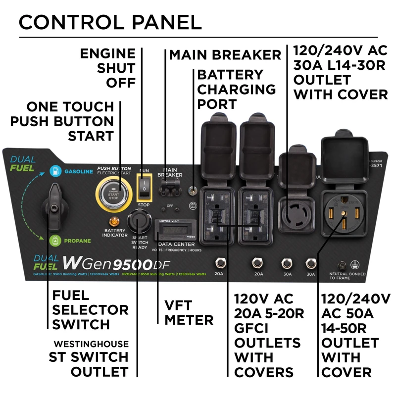

went to start gen yesterday and no joy. Dead. Battery was fine, but I charged it anyway. Light below electric start switch does not come on when rocker
switched to ON, so somewhere between battery and there is an issue. Need to pull panel off and look behind, everything seems tight and clean from what I could see.
Plus the one inline fuse looked fine, not blown, no corrosion. My friend Paul (Popgadget) is coming over this afternoon to put a meter on the wiring to figure out what the problem is.
Going to spray all connections with DeOxit while we are at it.
I was able to manually start gen and it ran fine but starting a very cold 457cc single is not easy and not smart for my bad back.
