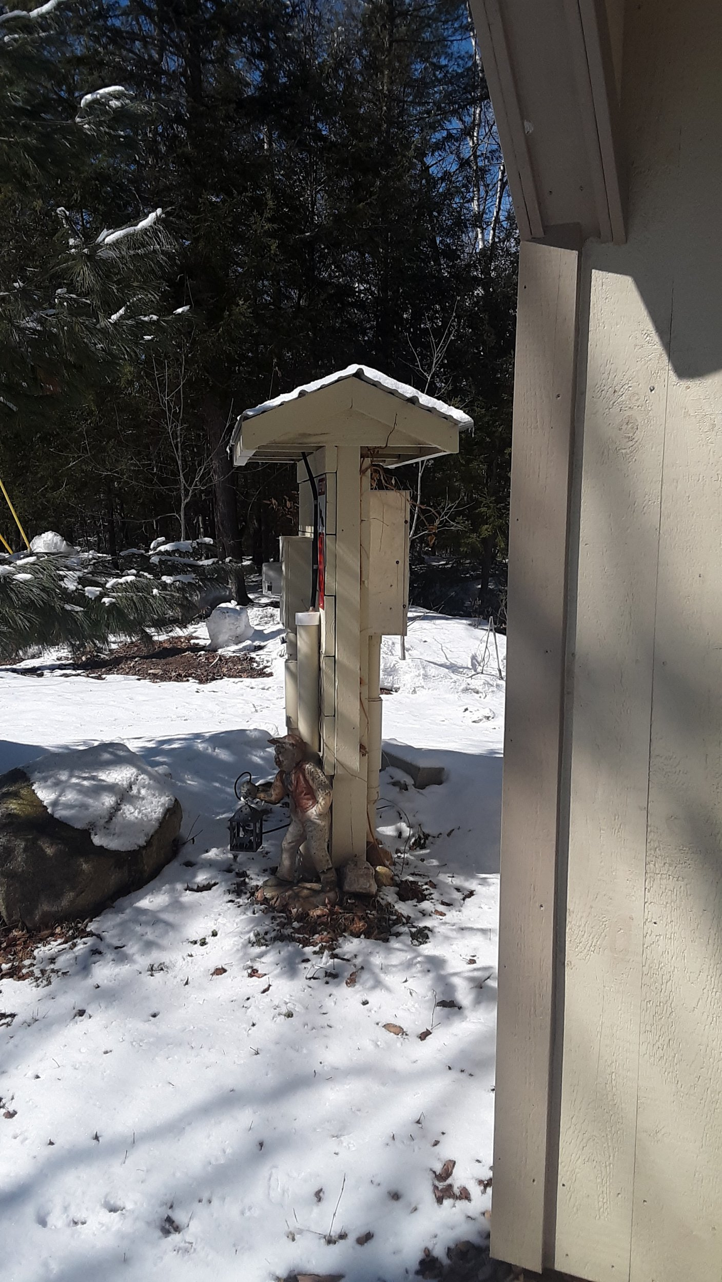

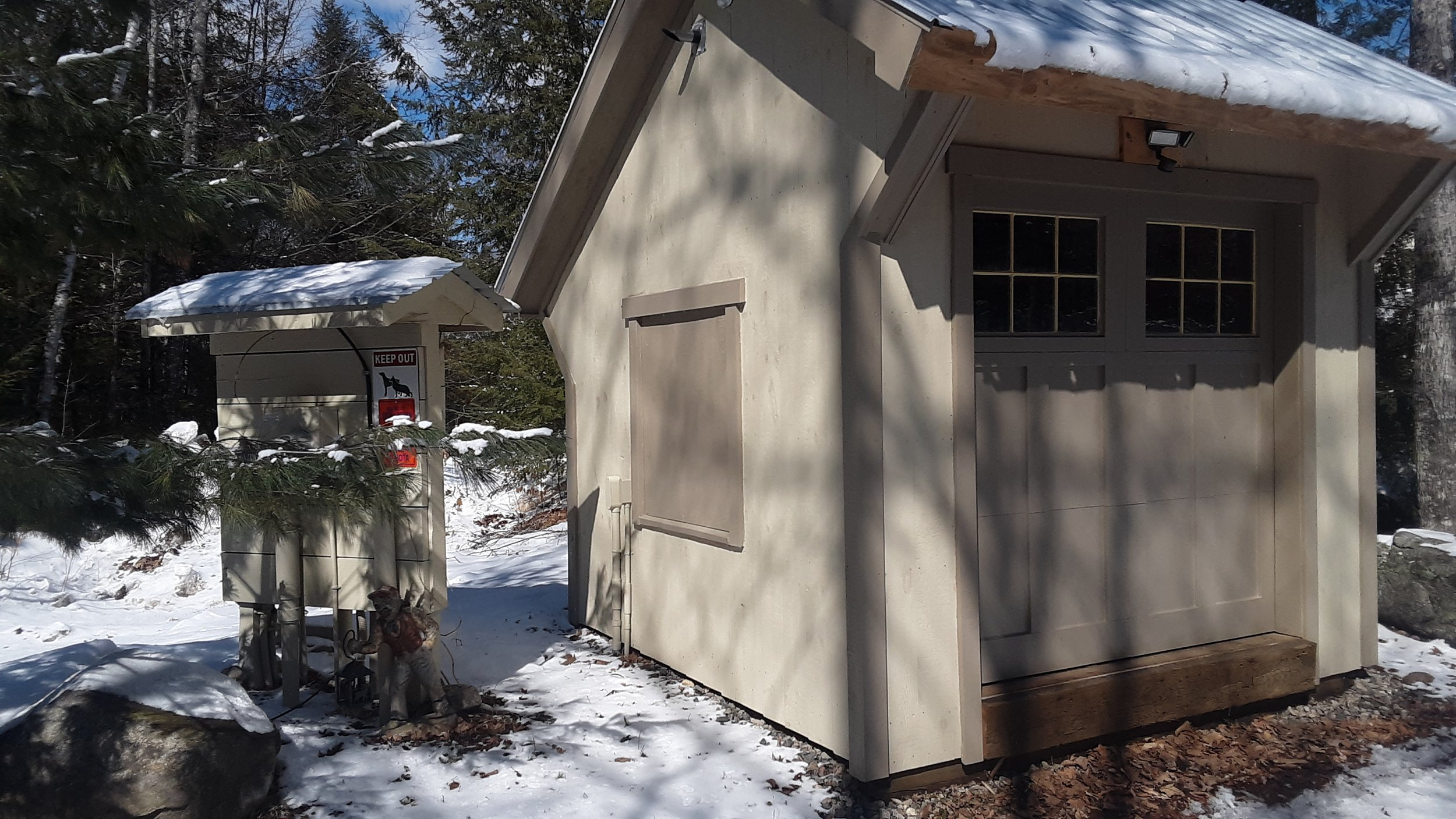

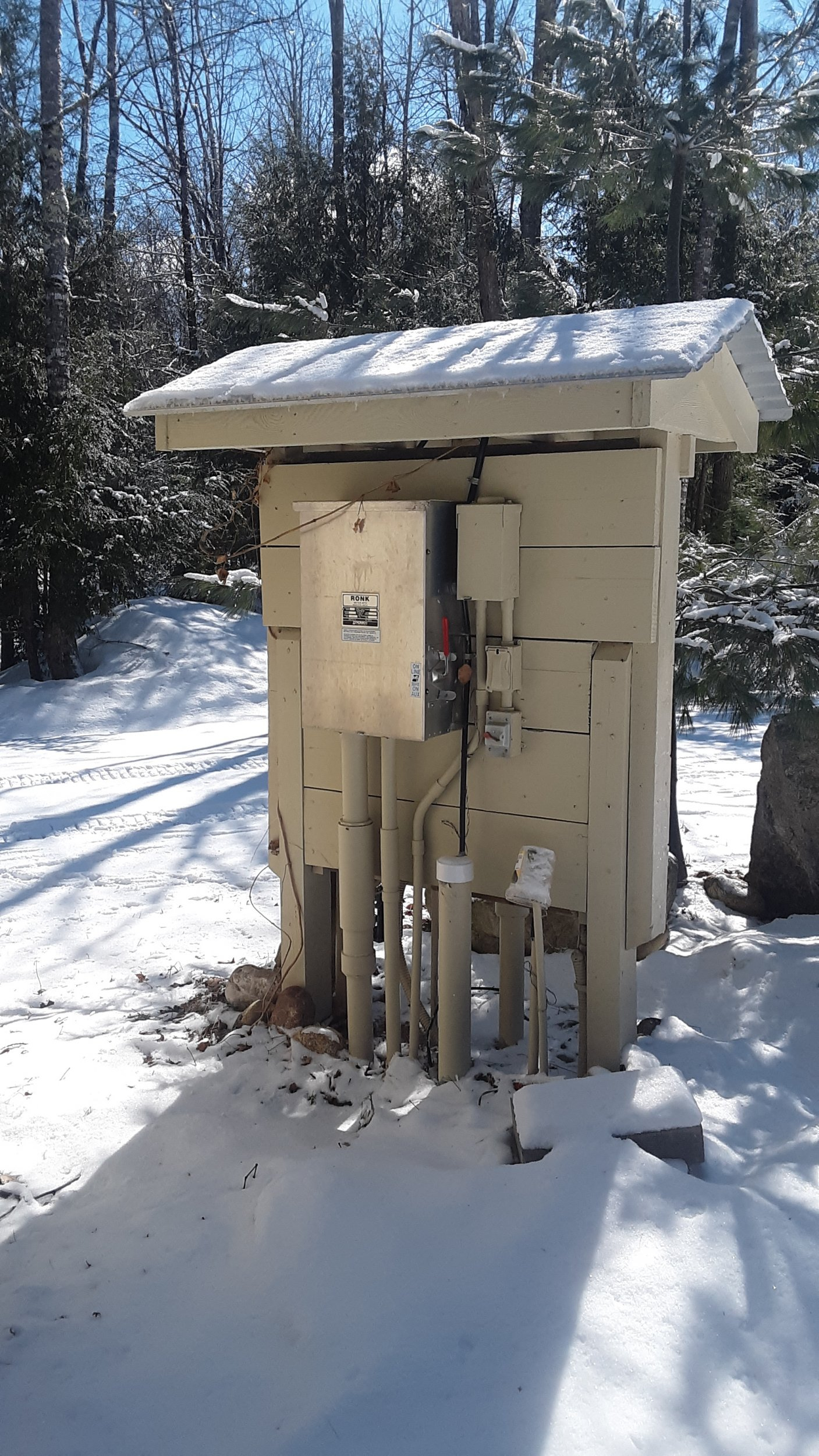

Thanks, I did a poor job describing my set up. My meter and disconnect are freestanding mounted back to back on a pair of posts - 200'+ away from the house and the generator is directly next to it.
My service "pedestal" with the meter on the left side and the xfer sw on the rt. That corner is the generator building.
Transfer switch.
Relationship to the generator building.

Ok, i see that the transfer switch is also out there, that makes things alot harder. This switch needs to be set just before the transfer switch.
with your setup, you may need to install a 120 volt light, hooked up before transfer switch, with a switch out there, that can be seen from the house. Then when power is out, flip switch. Light will reamin off until utility is back up.
i did not realize what your setup was like. Youll never hear that alarm 200 feet out.

My old habit of throwing in a
few spare conduits once the ditch is open will pay off. I've got 1 or 2 open at that pedestal that goes back to the house to operate a light off of the street side of the transfer sw.
