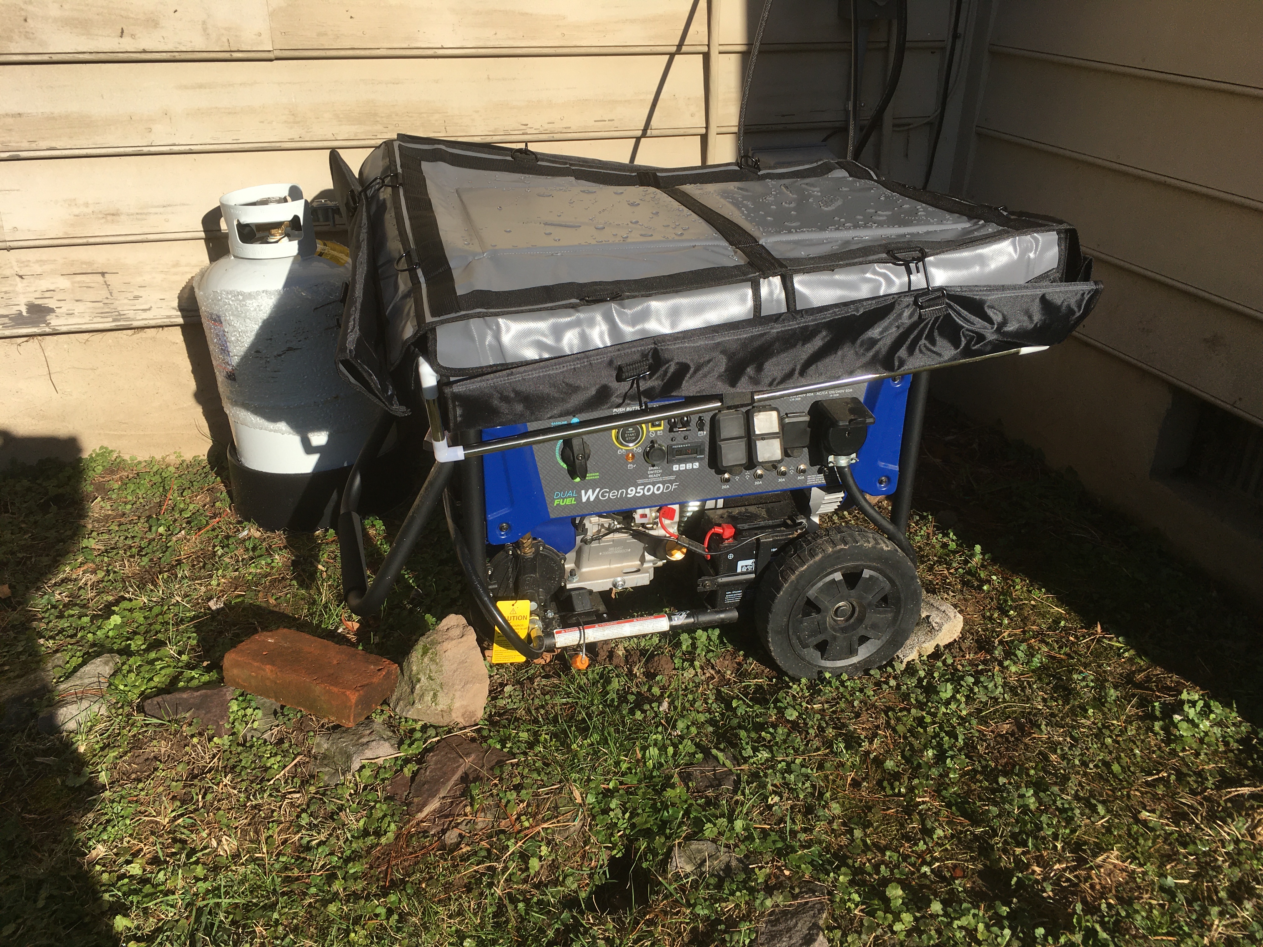

48 degrees out and sunny, gen started right up, 246 volts, let it run for fifteen minutes on propane, turned it off and checked the oil which was
full as before. Hook arrangement seems to work to keep side panels off hot spots, though I didn't run it that long.
Guessing the exhaust is on back, so that corner should retain a bit of heat for the tank. Max load would be the best test (re. propane flow), but your Winter lows are mild enough, with a bit of luck you won't have to resort to gasoline. 30lb tank gives you a bit more vapourization area too....
