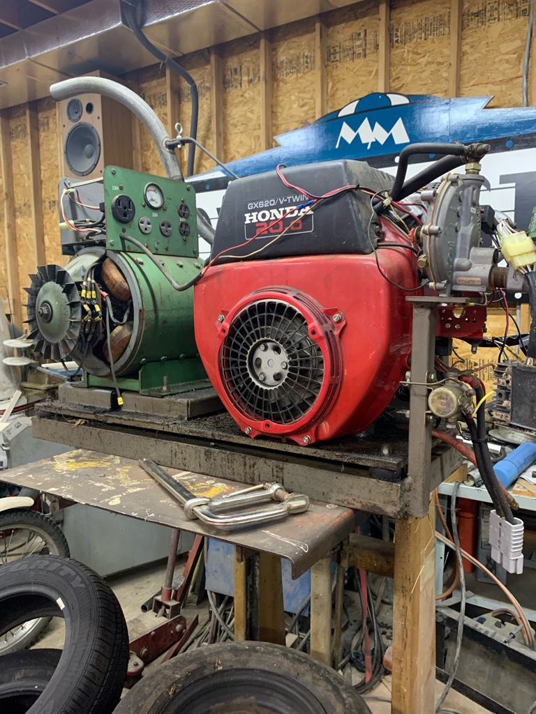

This was the automatic standby generator that I put together about 20 years ago, the generator end was a 4 pole Dayton that turned 1800 RPM, I used a belt reduction to let the engine turn fast enough to power the generator, ended up at about 2800 engine rpm to get 1800 at the generator.
After 20 years the generator failed. The engine was still fine, it ran on propane it痴 whole life. Now it痴 burning gasoline and powering my friends lawn tractor. Honda engines are hard to beat.
I doubt I値l get twenty years out of the 22kw Generac that replaced it, but you never know......
