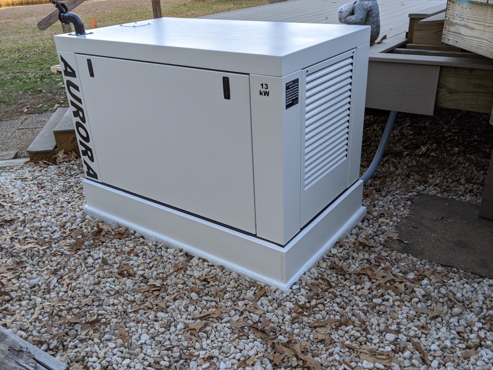

Diesel Tq.... covers many sins :thumbsup:. Thorough test; liking the shutdown timer.
Nice setup you built.
Rgds, D.

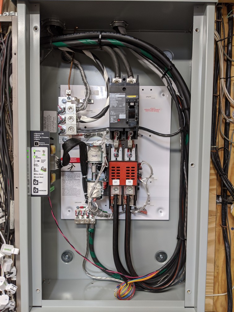

Thanks. It works well, and between the DynaGen programmable controller (supplied with the generator), and the Thomson programmable controller in the ATS, there are programmable schedules to run without load, other can be set to run with load; relay functions to control equipment such as remote alarms, remote gen controls, remote fuel pump operations, real-time displays of all engine and generator parameters, history log, and more. So far, I'm pretty pleased. Still tweaking the settings.

Will, nice looking gen and setup.
GRS, sure is nice having your knowledge here
If Generac can sell modules and relays for load shedding,
couldn't they have a soft start module that is remote installable at the hvac power input line?
This is why most of us should call electricians...

I just ran across this thread earlier today, and saw your comment about the engine temperature. I hope I'm not stepping on anyone's toes coming on here. I mean this only to be helpful to those not aware.
If a diesel is running lightly loaded (not really working) it doesn't reach normal operating temps (about 180-190). The engine could be experiencing wet-stacking, and prolonged running like that can cause damage to the engine. As a reference:Wet stacking - Wikipedia
Best thing for any diesel is to work it. I apologize if you feel I'm out of line here. This is a very interesting and informative thread, and I like your installation. Very nice build and well thought out.
Not out of line at all Will:thumbsup: this generator just appeared on c/l and with the fuel tank it's sitting on included, with only 1052 hours and $4500 price, I was in. If I were shopping new, it would be smaller for sure. My first good test was a few weeks ago, 66 hours (iirc) and no apparent issues and a good clean exhaust.
I like to be able to run all my big stuff beyond the house if necessary, that includes a 5hp compressor, rotary phase converter, 250a welder and the plasma cutter. Then there's the go big or go home mentality that I struggle with. :D
The soft start works directly with the motor windings and capacitor in the heat pump, to let the compressor start slower and use less current. It wouldn’t be possible to do the same thing on the power line supplying the unit.
The Generac load shedding works by interrupting the thermostat low voltage wiring to keep the compressor from starting at all. A much simpler approach, but a different solution.
