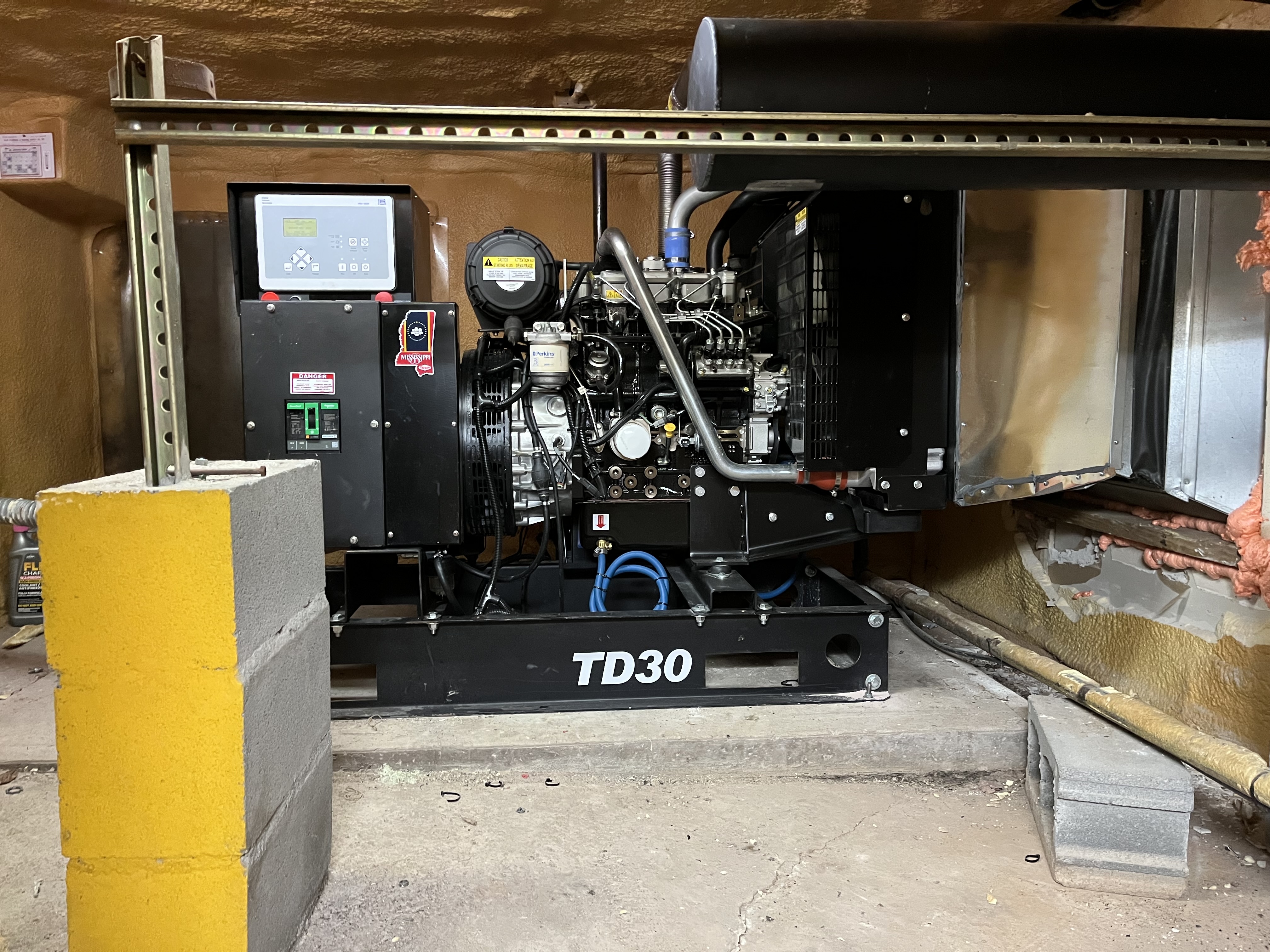

One of my customers just had their generator changed. The old one was a 30kw Kohler from 1988. It developed a smoke issue, and after having the generator load tested, IP and injectors replaced, wouldn’t start without a shot of ether. Engine was a Deere 4cyl. I forget the model number. Here’s the new one in place:
Taylor Generator with a Perkins engine. Used the same transfer switch as the old one. Seems a bit quieter than the old JD. And yes, it’s installed in a crawl space.

how many hours on the old one before it started smoking?
   / Your last generator Maintenance Run #7,318
560
The tech scoped the cylinders and said the cylinder walls were pitted and that resulted in lower compression. Which caused the smoke.

that's an incredibly low number, was there speculation on what caused the issue?
   / Your last generator Maintenance Run #7,320
That’s what I thought too. Tech said not load banking it regularly may have caused it. I don’t really know what that would have to do with it. The block heater burnt out probably 20 years ago, so maybe there was an internal condensation problem related to that. It was always exercised weekly, except for a time when some unknown person removed the timer keys. Then it went inexercised until I discovered the issue. Highest compression on one of the cylinders was only 180 psi, so something was clearly wrong.
