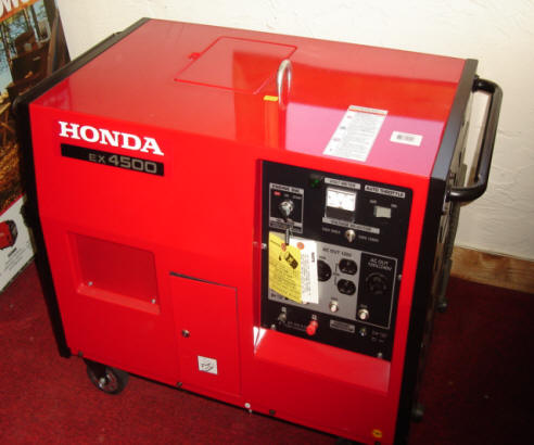

Howdy,
Keeping things serviced makes a big difference. I know the time keeps passing... but, my Honda EX4500 which was purchased in 1987, is still running great.
The Honda EX4500 is a fully enclosed unit which is silent running.
Simply keeping the gas rotated, oil changed, spark plug, valve timing, air filter, battery changed and trickle charged. And running it occasionally under load. I can't believe the thing is 27 years old...:confused2:
   / Your last generator Maintenance Run #355
^^^ You take remarkable care of your equipment...
Good equipment still needs proper care and by the looks of you generator... it will be around long after we are gone.

Howdy,
Time does fly, don't it !
For personal use, generators should last a long time. The tough part for me was remembering to run it once in a while, but I've gotten better. :)
It doesn't hurt that you started with a great machine, but the maintenance always matters....... GRS had a couple of good examples in this thread of people installing full-auto systems, doing zero maintenance, then acting surprised when they don't start a couple of years later.
Nicely done Mike ! My small gen is a youngster in comparison, I bought it in '98 !
Rgds, D.
