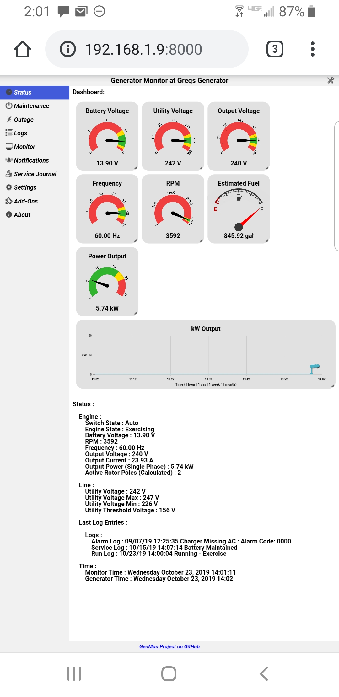

My generator just emailed and texted me that it's exercising. Screenshot_20191023-140114_Chrome.jpg

My generator just emailed and texted me that it's exercising. View attachment 625813
Do you have yours programmed to xfer the house load grs, or is that 5+kw load onboard ?
Not many bells/whistles catch my eye, but remote telemetry on gen status :D
Rgds, D.
Rgds, D.
I occasionally use the genmon available option to actually switch the transfer switch to apply load to house under exercise mode. house power is not shut down, the switch just switches over to apply gen load
   / Your last generator Maintenance Run
#3,080
Nice option.
Rgds, D.
