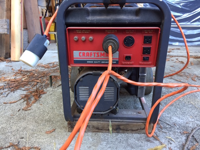

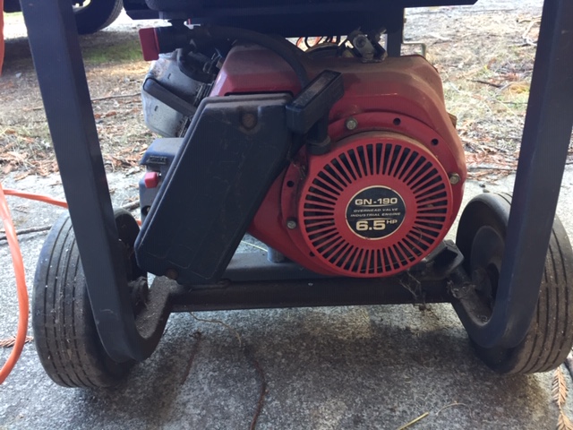

This is my Craftsman/Generac "Old Faithful". Near as I can tell it is 30-35 years old. Gets frequent use here in PG&E territory on the north coast. It always starts on the first or second pull if I can remember which way to set the choke. It is only 3500w but has 220v output so will run the well pump. It connects to a manual transfer switch that disconnects from the utility power then can run either the shop or the house. It is very loud under load.

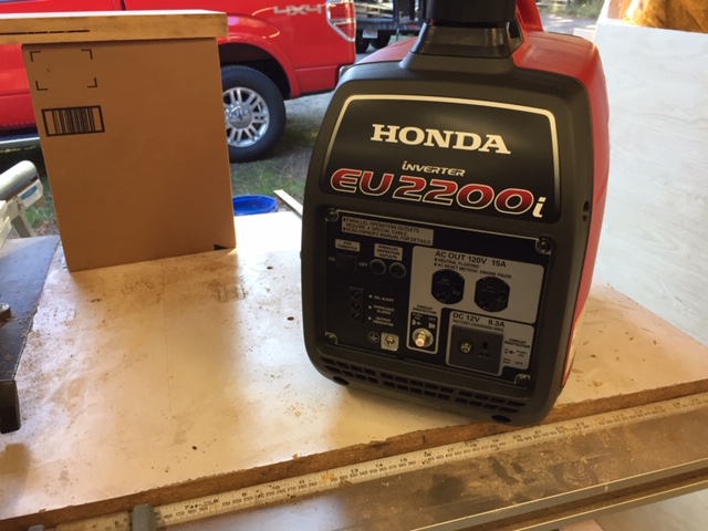

I also got a Honda 2200 for various uses. One purpose is to run at night, just the fridge, electronics and some lamps. It will go for about 7 hours so I am thinking of getting an extended run setup to get through the hours of darkness without a fill. It connects to a generator inlet box on the side of the house, which is connected to duplex outlets on the other side of the wall. I made up a dedicated extension cord from one of my old work cords that I never use anymore. So I can set the generator 50 ft away from the house.

Nice complement and setup. Interesting to see a 3500 with 220..... less common today.
