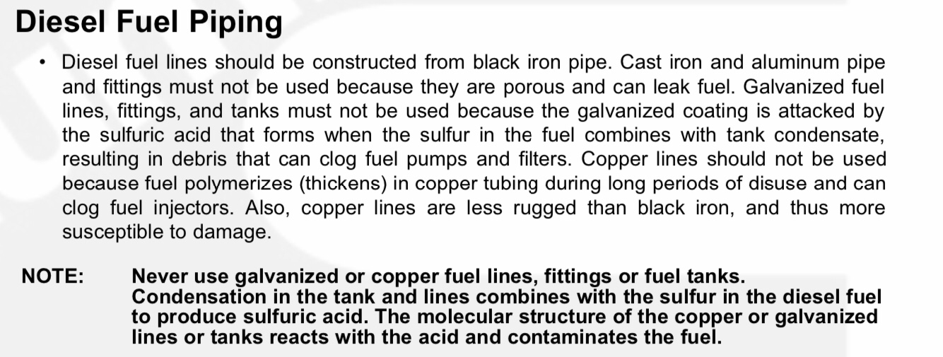

The general rule is never copper or galvanized materials in contact with diesel. The main reason is that in the presence of water, there is a reaction with these materials that produces sulphuric acid which is obviously hard on fuel systems.
Now that there is virtually no sulphur in diesel I don’t think that particular item is an issue however none of the manufacturers I’m aware of have changed their standard regarding these materials so there may be other reasons to avoid it. Personally I’d stay away from copper line and galvanized fittings.
I don't see why you wouldn't or shouldn't use copper on diesel engines.
My Oliver had some copper lines on it with no problem,
and on top of that I'd say that many 1000's of home oil fired boilers and furnaces have been piped with rolled copper tubing for fuel.

Well, for the reason listed among others. A burner can tolerate far more contamination than fuel pumps and injectors with clearances in the 10 thousandths of an inch.
What’s a furnace burner worth? Fuel pumps for a large engine can run $100k
On a commercial installation, I can see sticking with steel, partly for impact strength.
Good info........ seems the copper option is the least-evil of the alternates.

I’d guess that steel would cost less than copper tube these days and you don’t risk contamination.
