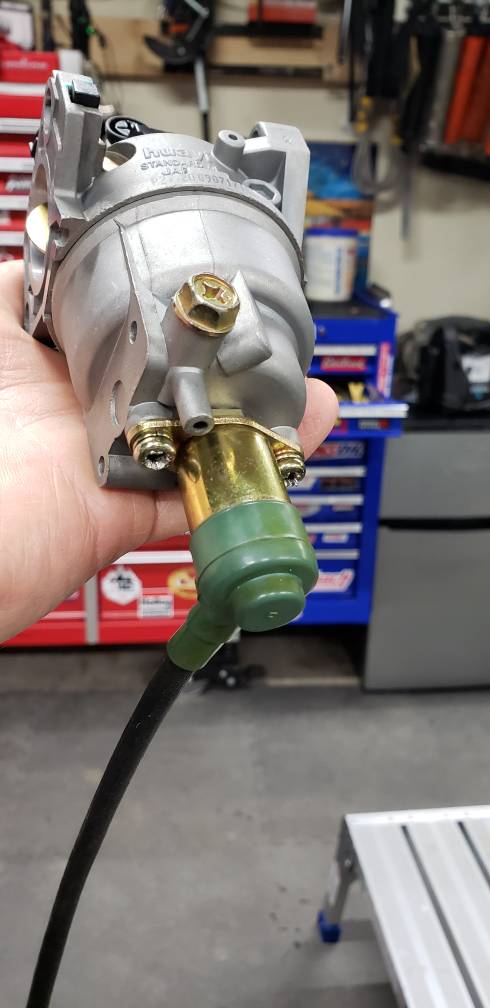

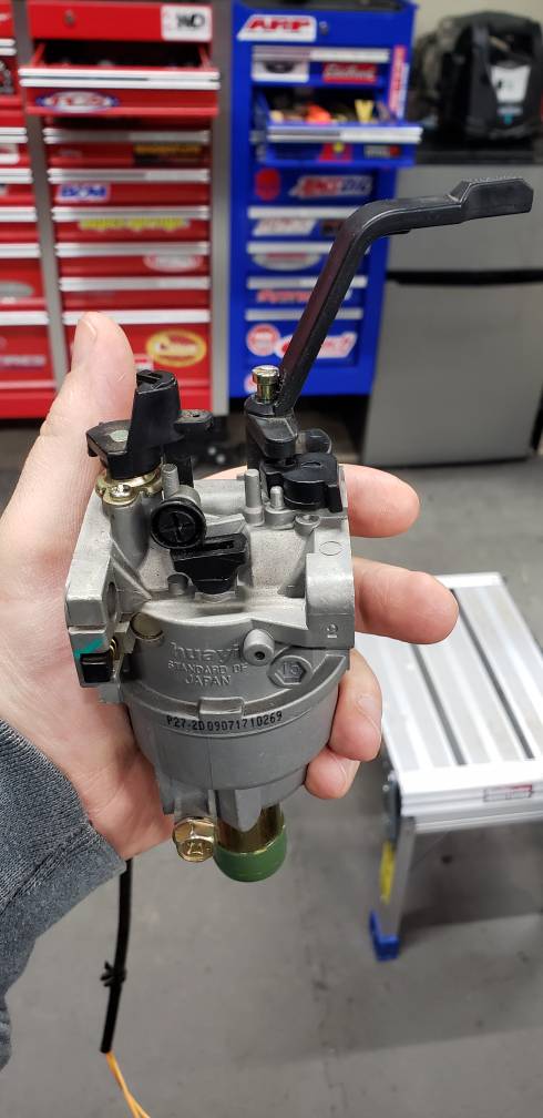

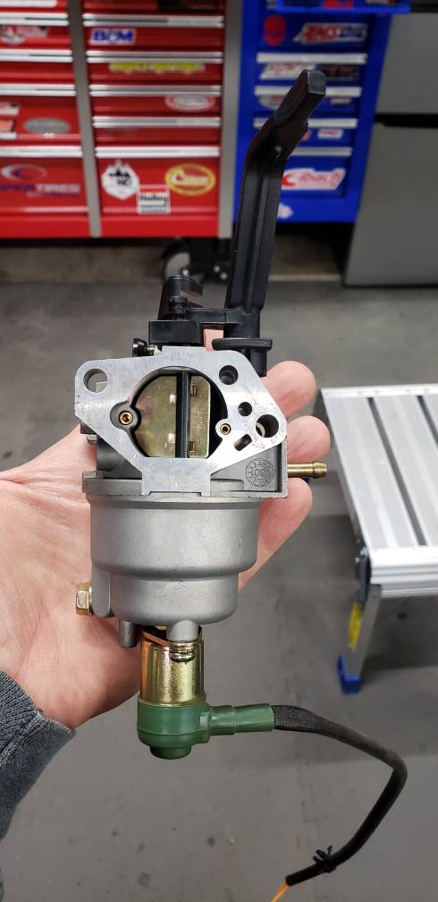

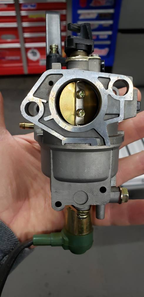

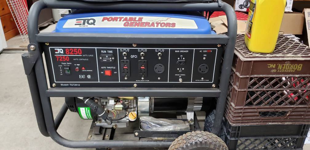

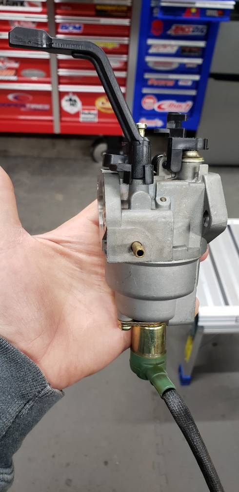

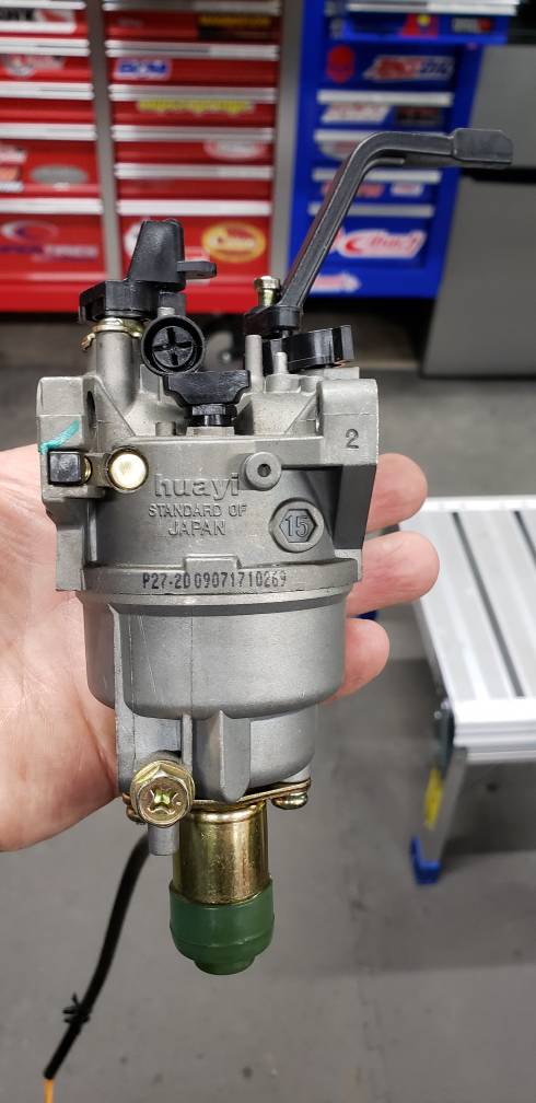

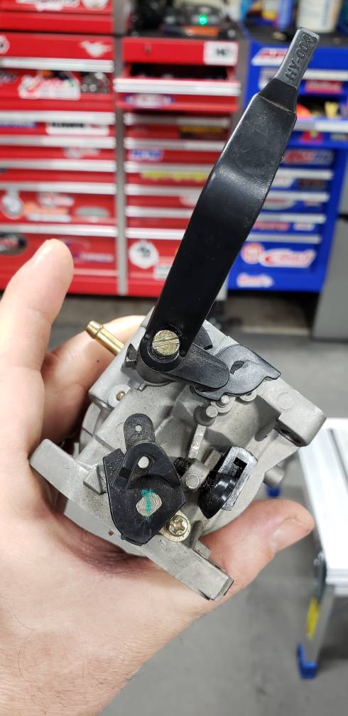

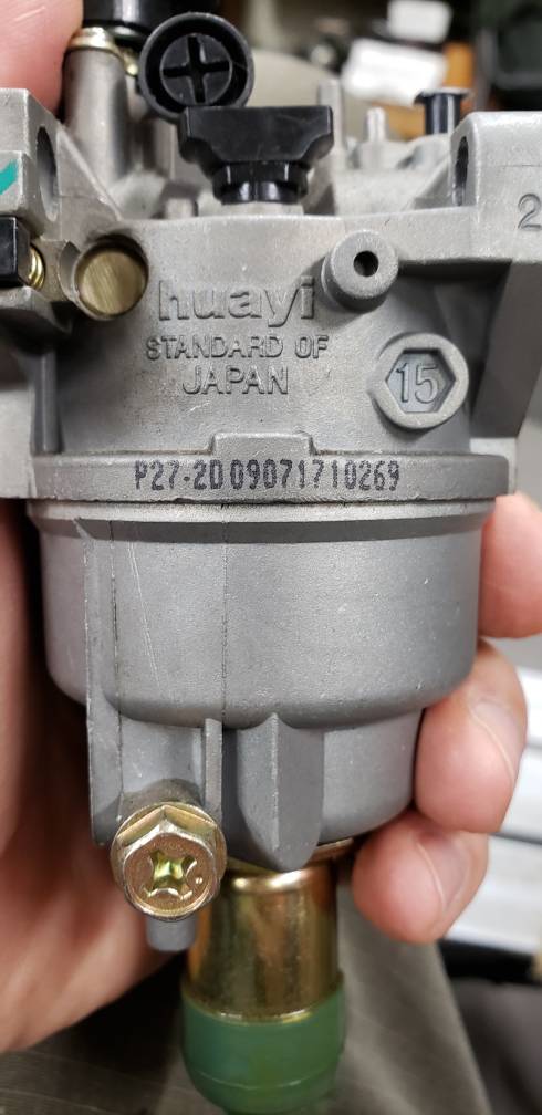

I need help. I'm trying to find a replacement carb for my 12 year old generator, and all I can find is one with a little black rotary choke knob.
The problem is that the large panel air filter blocks visual and tactical access to the carb, this is why the OEM carb had that lever that extended up and over the air filter housing.
I did buy one if the rotary knob versions, and I can run the machine, but you can not start it without removing the air filter to choke it, then replace it.
I'd really like to find this exact configuration. Would any of you small engine guys know how to track this down?
View attachment 584505View attachment 584506View attachment 584507View attachment 584508View attachment 584509
I haven't had to chase down carbs, yet at least.... so don't have a good source off the top of my head..... we'll see who drops by over the holidays..... Don't be shy about bumping again on this topic.....
That lever may be a separate part that the gen OE sourced separately - any chance of swapping it over ?
Much cleaner if you have an exact drop-in replacement, but if the choke moves smoothly, I might play around with transferring the arm, or making a substitute out of something light-weight.
Not my first goto, but I've made things work with JB Weld more times than I would like to admit....
Good luck, and post how goes......
Rgds, D.
Rgds, D.
I tried swapping, there is no way to get the cam off, the lever itself unbolts easy enough... But the rotary knob does not matter to it.
"Mate" I think.... got it....
Hopefully you can get an exact match soon..... if not, I'd square up that round knob, and punch a mating hole in something like right-angle aluminum stock, and JB it in place. Not as clean, but should work.... heck, JB is strong enough that unless the choke butterfly is really stiff, a round hole would work....
Good luck,
Rgds, D.
