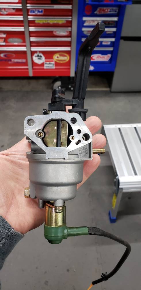

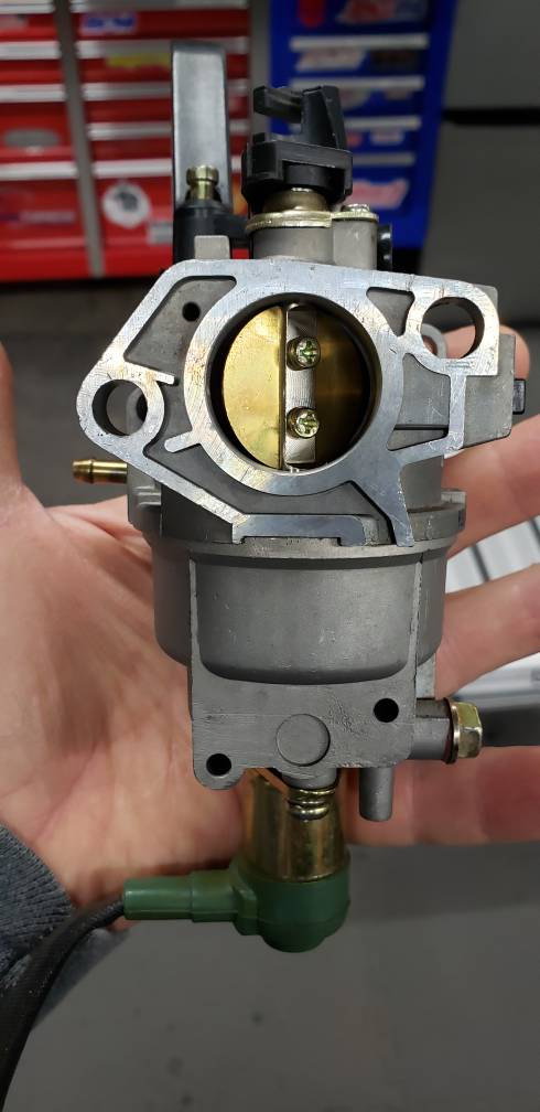

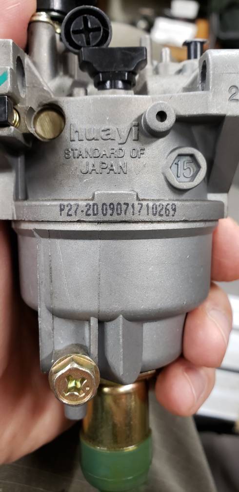

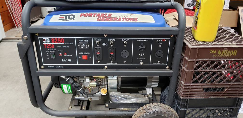

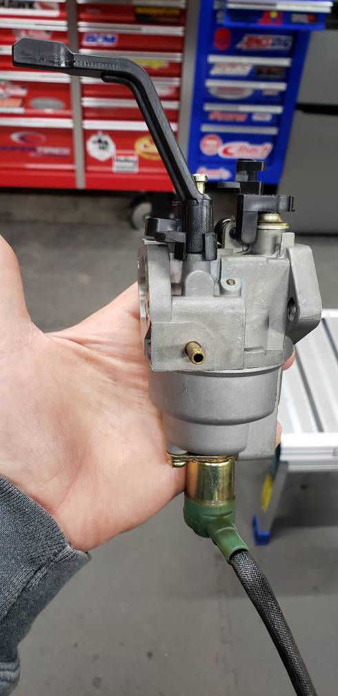

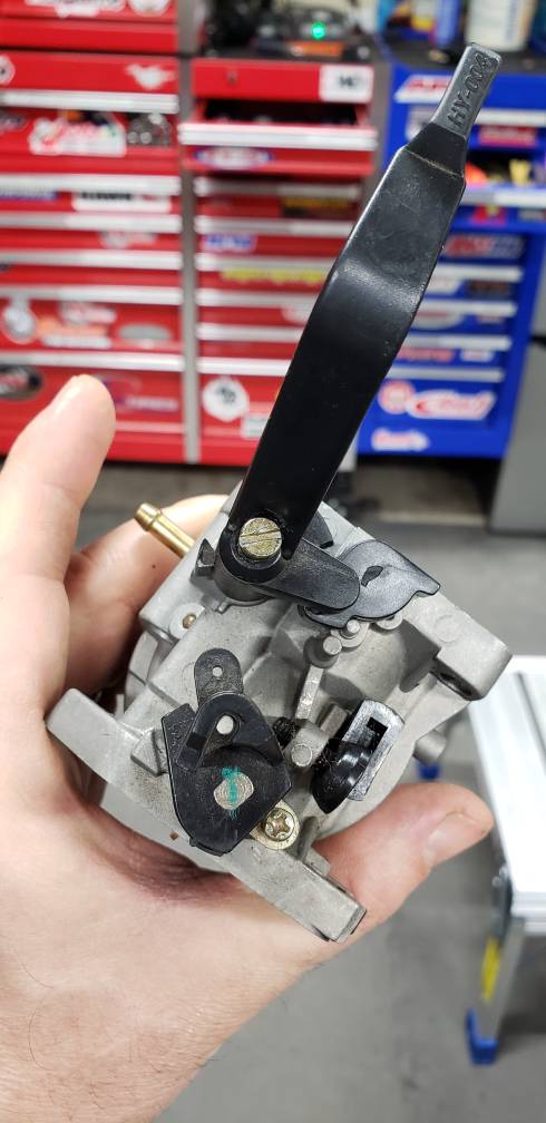

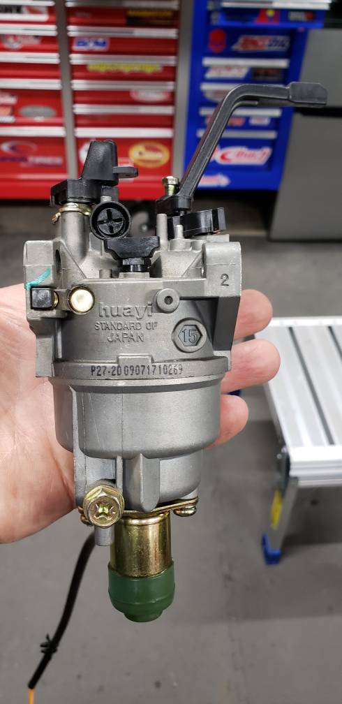

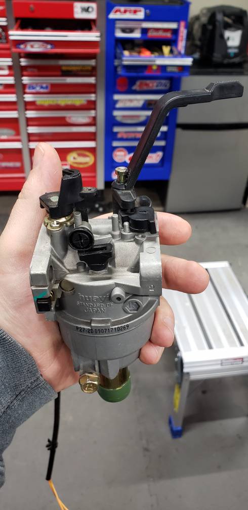

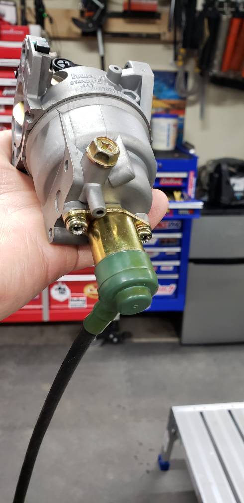

I need help. I'm trying to find a replacement carb for my 12 year old generator, and all I can find is one with a little black rotary choke knob.
The problem is that the large panel air filter blocks visual and tactical access to the carb, this is why the OEM carb had that lever that extended up and over the air filter housing.
I did buy one if the rotary knob versions, and I can run the machine, but you can not start it without removing the air filter to choke it, then replace it.
I'd really like to find this exact configuration. Would any of you small engine guys know how to track this down?
