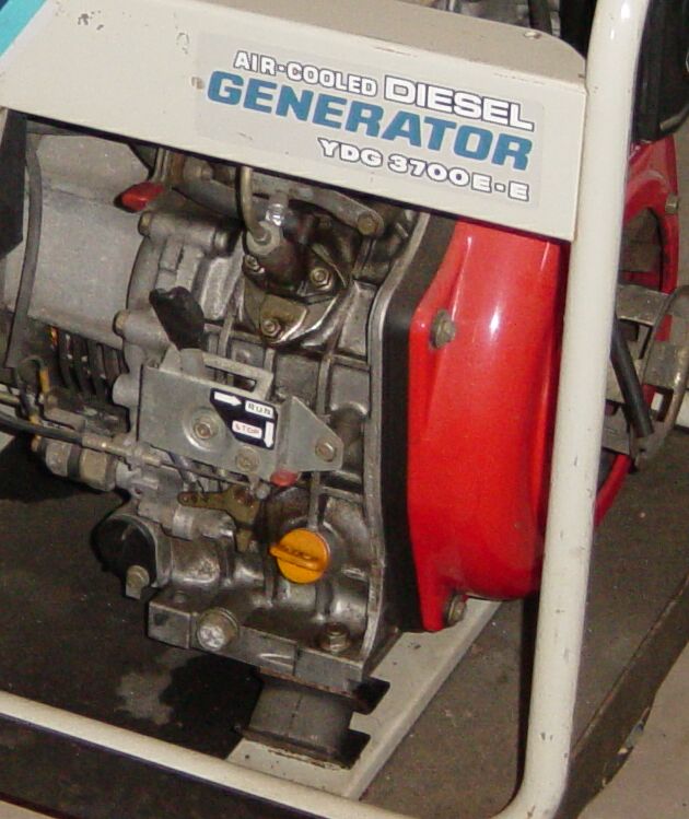

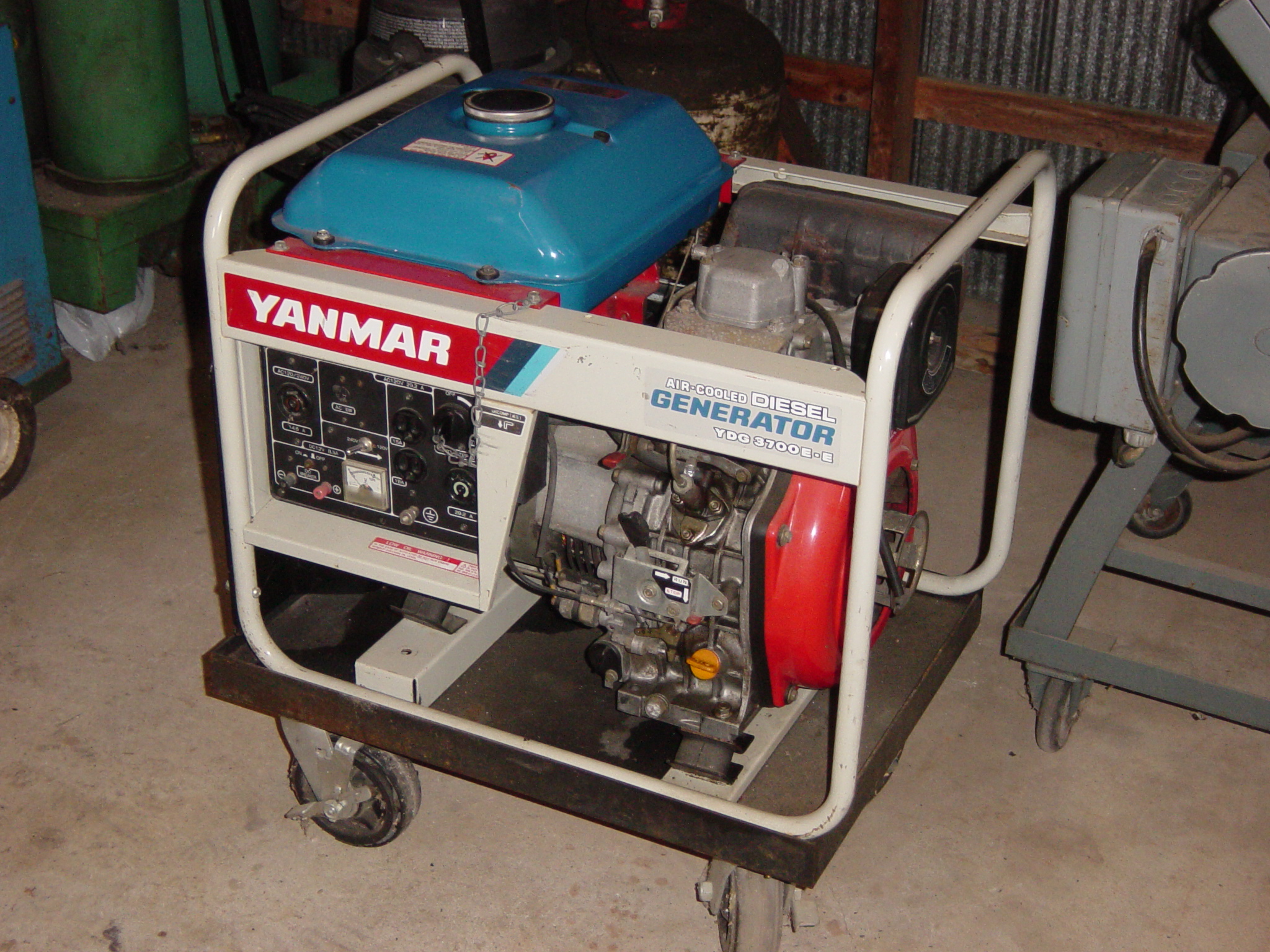

Sorry. My mistake. You can see the decompression lever to the left, a little higher.
Hate giving or getting wrong information.
   / Your last generator Maintenance Run
#1,423
I had one of those china silent generator's & very familiar with them.
The compression release is on top of the engine and you can't get to it from there.
I had to cut an opening in the top of the housing in order to use it. Cost cutting move for them!
90cummins
Ok, THAT explains a lot !!!! :banghead: :duh: :irked:
Rgds, D.
#1,424
No tweaks!
I use Rotella 5w40 and 100psi is normal cold 50~60psi hot.
There is no pressure regulator so this is normal.
90cummins
Thanks for the 411...... t6 is one of my favourite oils....... healthy pump !
Rgds, D.
#1,425
Those controls are the same as mine and others I've worked on.
The red lever on the right is not the decompression lever it is the manual release for the throttle.
When engine is running if that lever on the right is pressed it will release the throttle shutting the engine down.
The decompression lever is on the valve cover which is inaccessible.
90cummins
That jives with what my friend has to say about the actions of the the red levers on his. What I can't figure out yet is what that small brass lever on the bottom of that little box does.....
And, let me guess..... until you use the innaccessable decompression lever correctly then you stand a snowball's chance in Hades of getting it to fire :devil: on these units.....
Can't write what I'm thinking about this lame manufacturer.... don't want to get suspended here.....
Rgds, D.
