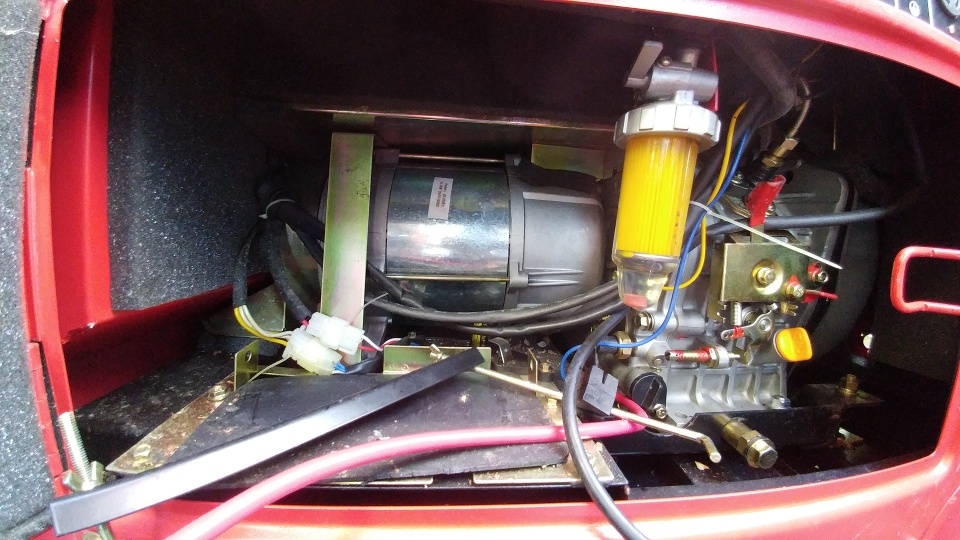

Trying to help out a friend, who has this clone diesel generator. Bought new at auction, but the Owner's Manual is absent....
Powertek EDG6000S
Looks like this
POWERTEK EDG6S [u'East Regina'], Regina
Found parts here:
Generator Guru
Can't find an Owners Manual online yet. Neither of us has experience with this size of diesel.
Parts link above shows a RunStart lever, and a Rocker Cover Decompression Lever, but no glow plugs that I can see.
Is there typically a pre-chamber in the head that you prime with fuel, then use the Decompression Lever to increase initial cranking speed, then release ?
It is electric start.
Rgds, D.

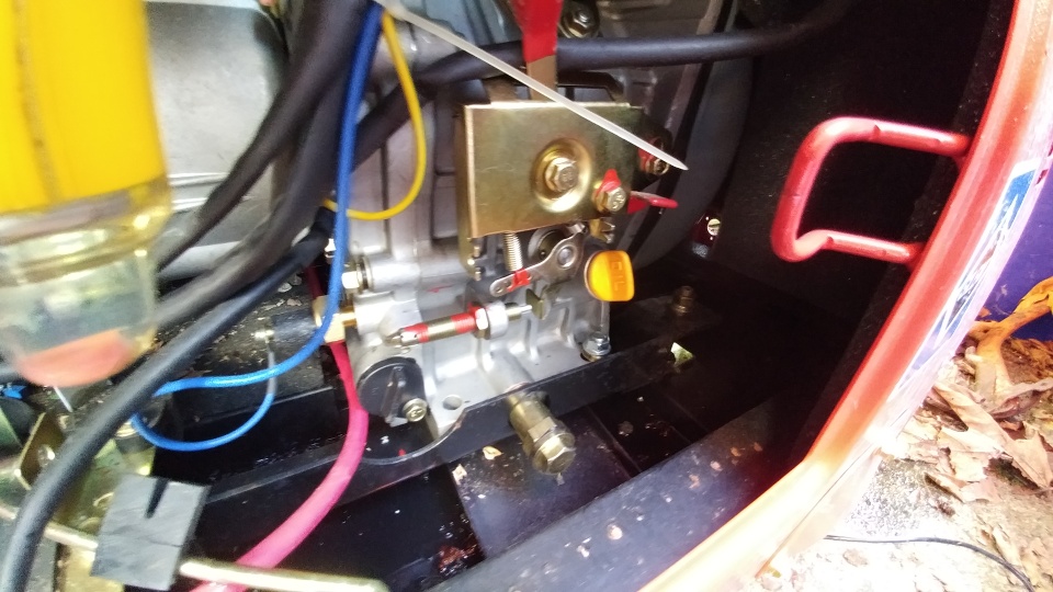

Similar to the start 90 just posted, the best starting description (tracked down a guy, Mark in Alberta, with the same/very similar clone) I've heard involves feathering the throttle @ start. My buddy hasn't found the compression release yet, (may end up pull the enclosure off next....), and Mark doesn't recall one, but it's been quite a while since he's run his.
Mark's Run/Start throttle description:
The large lever on top is the throttle, and the
little red one I think it releases the throttle from the wide open
position. I only put it in the wide open position once it is started
and warmed up a bit. But it is meant to run wide open when in
operation.
I'm 3k miles away from this gen,..... irritating I can't get my hands on it..... there is what looks like a 3rd brass lever at the bottom of Run/Start/throttle assy, I'm wondering what it does ?

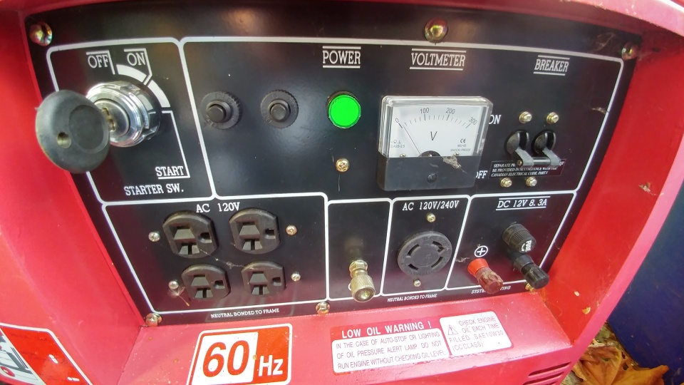

Pics of my BC buddy's actual gen attached: Rgds, D.
View attachment 534869View attachment 534870View attachment 534871
I had one of those china silent generator's & very familiar with them.
The compression release is on top of the engine and you can't get to it from there.
I had to cut an opening in the top of the housing in order to use it. Cost cutting move for them!

The upper red lever is the on/off. The solenoid only shuts the motor off, but that red upper lever needs to be manually reset to start again. Made trying to remote start/stop this set too difficult! And I had bought the RF stuff already.
The Red lever on the right is the decompression lever when pressed down.
   / Your last generator Maintenance Run #1,420
Those controls are the same as mine and others I've worked on.
The red lever on the right is not the decompression lever it is the manual release for the throttle.
When engine is running if that lever on the right is pressed it will release the throttle shutting the engine down.
The decompression lever is on the valve cover which is inaccessible.
