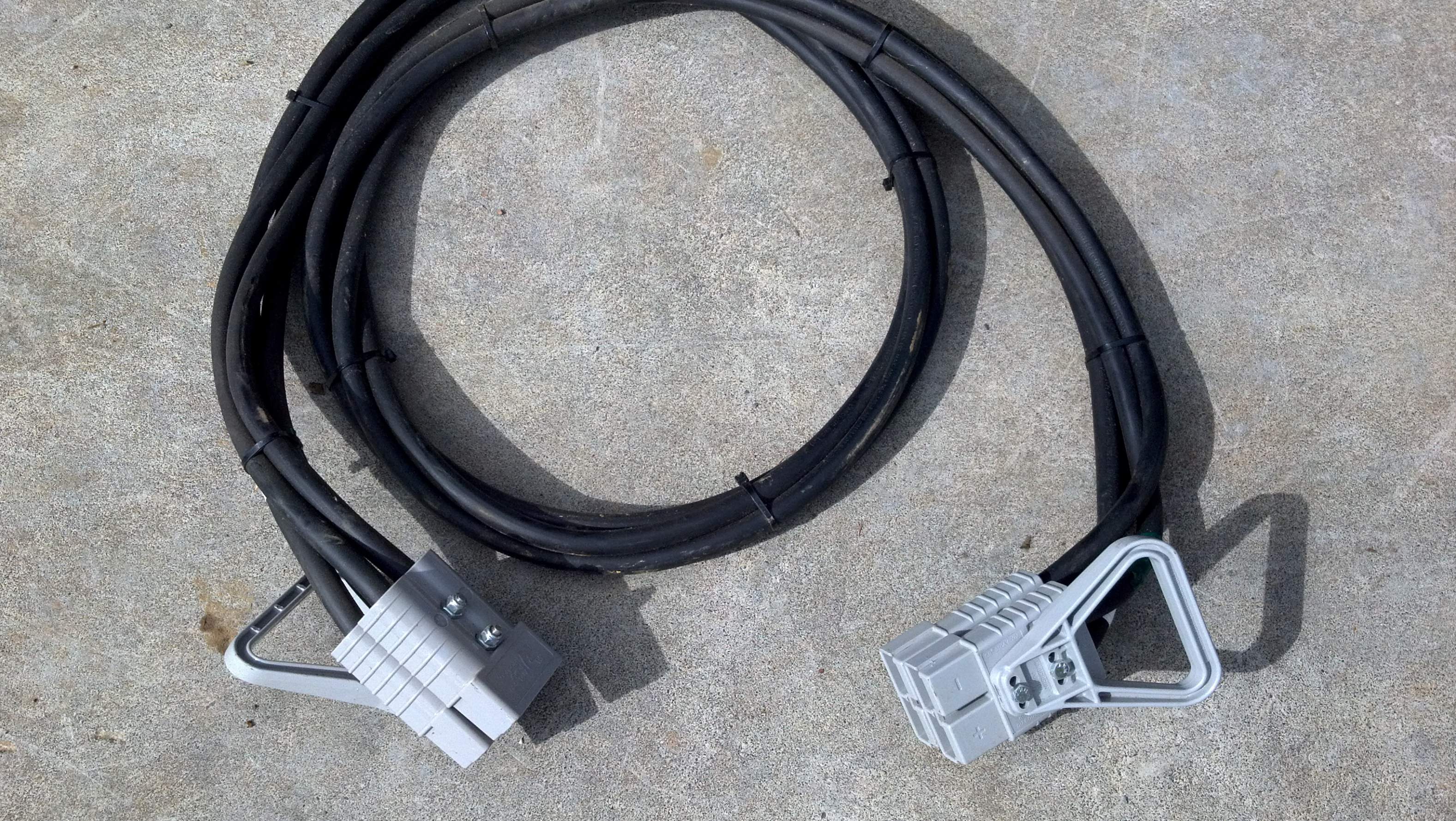

Today pulled out the generator , hooked up a light, fan and a AC unit to let it run, but no fan or light ?. Os I check all 3 off house power and they work. Checked outlets on generator with a pocket meter and they showed hot?. So I pull off outlet covers and find 3 loose wires, glad I found this problem now, instead stead off in the dark at 10 below
Sent from my iPad using TractorByNet
Good catch. With you on the 10 below issue.
I was doing a max load test on my smaller/older generator, and ended up tripping the breaker on the generator. Turns out the generator has two breakers, with one being mostly hidden from view. Up till then, I thought it only had one breaker.
I'd like to think I'd have figured that out pretty quickly in an emergency, but in bad weather or with a basement flooding at 3am, I prefer to know ahead of time....
There's that military axiom about Training More in Peace, So You Bleed Less in War. Murphy often has other plans, but there is some truth there....
