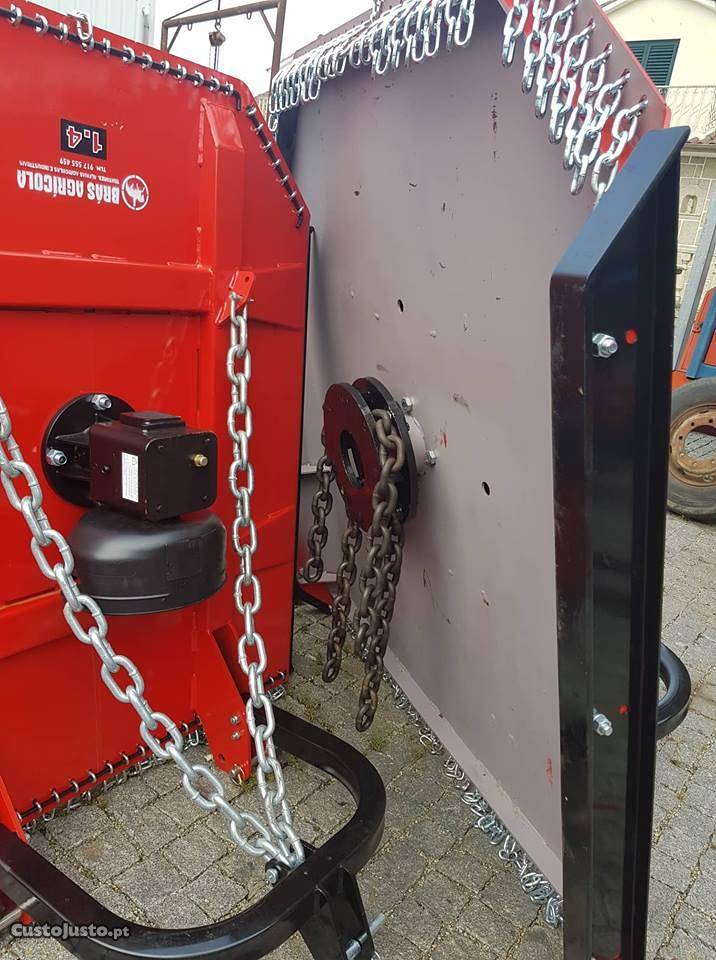

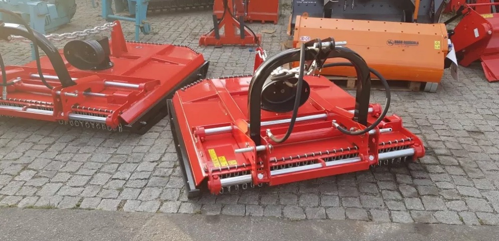

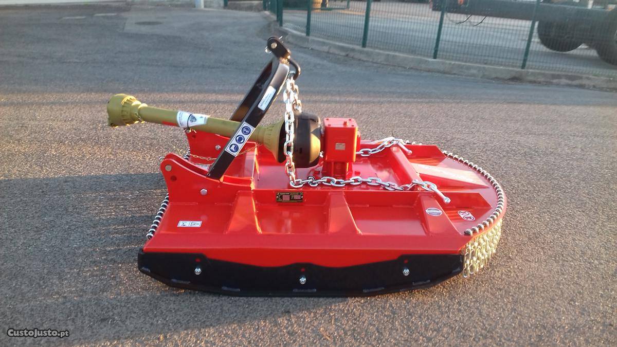

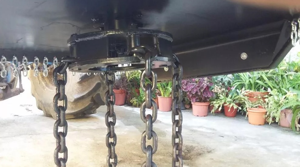

I'm going to suggest some features with pictures that we use in Portugal that may or may not work on the US market. We have really good results over here. These could be combined with some features already mentioned by other users.
1- Half round skid plates. This works very nice and will prevent the grooves and collecting of all kinds of stuff in front of it.
2- Offer 3 types of options for the rotor. One being using the regular blades that you're use to. Second being using high strength chains, that could be offered in two for lower HP tractors or 4 for higher HP tractors. These works really nicely in land clearing jobs, specially with hidden "treasures" like rocks and such as it doesn't have an edge to wear out or get bent. The chain will skip right over. Of course that this won't give a smooth cut like the blades. It's most used on overgrowth brush and stuff bigger and harder than grass or pasture.
2164168839-capinadeira-corta-mato-de-trator-reforcada-1-40m.jpgcorta mato correntes.jpg
3- Offer models with side-shift. This allow for the cutter to move sideways and mow in between trees or objects.
4- Using chain skirts to contain the projection of debris. Shown on previous pictures.

Very impressive looking rotary mowers there, ptsg!
I can see where this would ride over the rough terrain good but it should float like the King Kutter Flex Hitch. That way it could twist independent of the tractor.
Also, the shoes are not rounded on the bottom for turning. Swinging the deck sideways would slice off any hump of dirt or sod.
