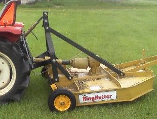

I used the guide wheels from a New Holland Hayliner Baler.
