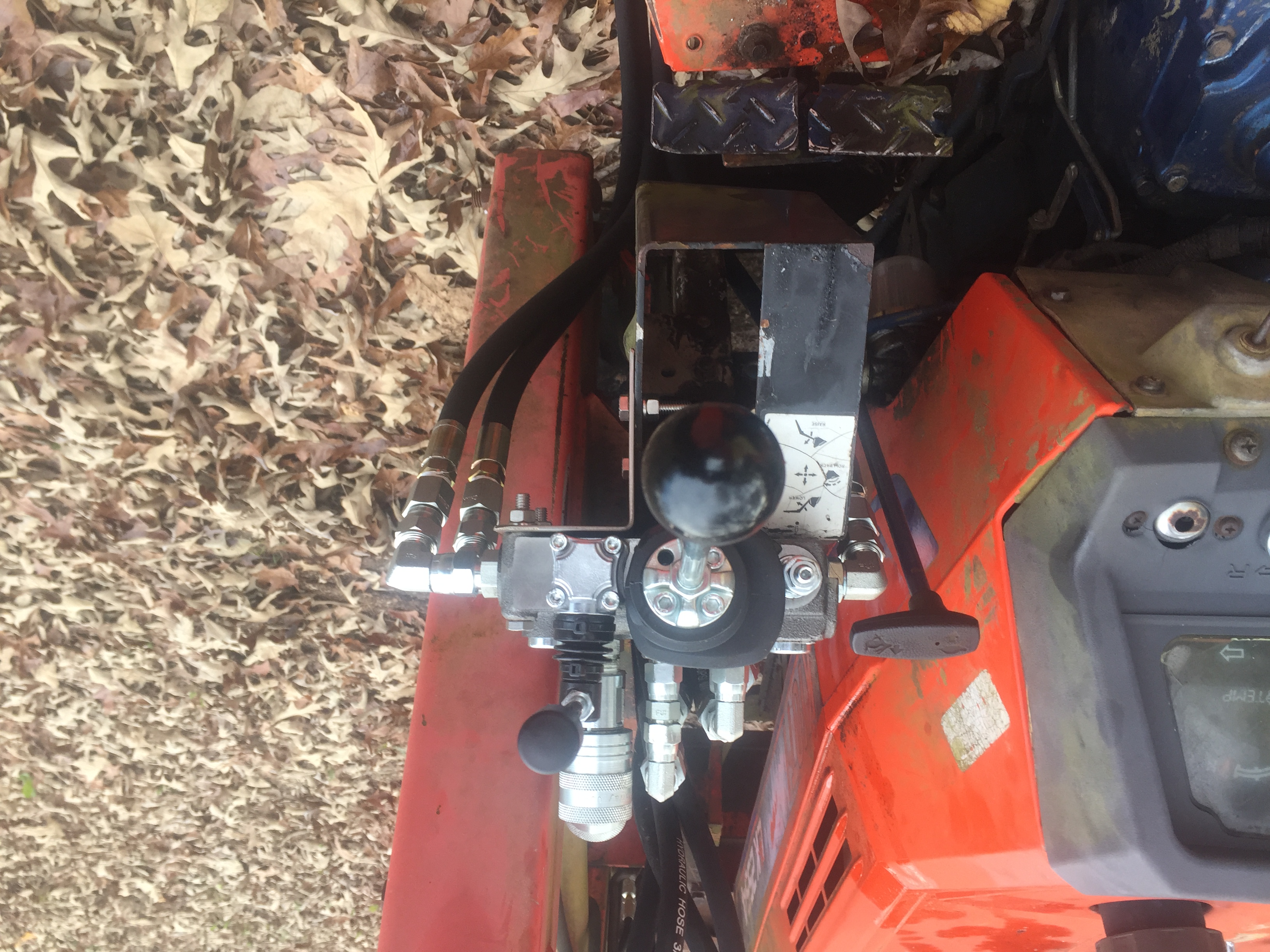

I installed a Youli MB3 valve with third spool on my loader in anticipation of a new grapple from EA. I posted a picture and thats when I noticed it was missing a screw on the joystick. I am not sure when or where it came up missing but I don't see it in the box or around where I installed the valve.
When I tested the valve, I noticed that when you are lifting the boom and dumping the bucket at the same time the boom starts to fall. It will raise and curl up at the same time no issue. It will perform all other functions independently perfectly. So, my question is could this screw be the issue or is that just the design of this valve? If it is the design, I have never seen that before and think that is something I will not like about this valve. Any help would be greatly appreciated.

I tried to put one of the other screws in this hole and it just slides in and out. No threads. I am guessing I did not loose anything but it is designed to use only three screws on the joystick. I am still curious as to why the boom falls while raising and curling down at the same time. Maybe a faulty check valve?

What's needed here is some more information. BTW, that's a nice looking installation you did.
Since both the bucket curl and boom raising functions draw from the same supply source - in this case the pump output - seeing the boom falling slightly when the bucket curls may be unavoidable at low flow.
My guess at this point is that it may be due to the internal geometry of the loader valve or it could depend on the way that the hydraulic cylinders are configured end-for-end. Try running the same test with the fluid warmed up at medium RPM and see if the same thing happens then.

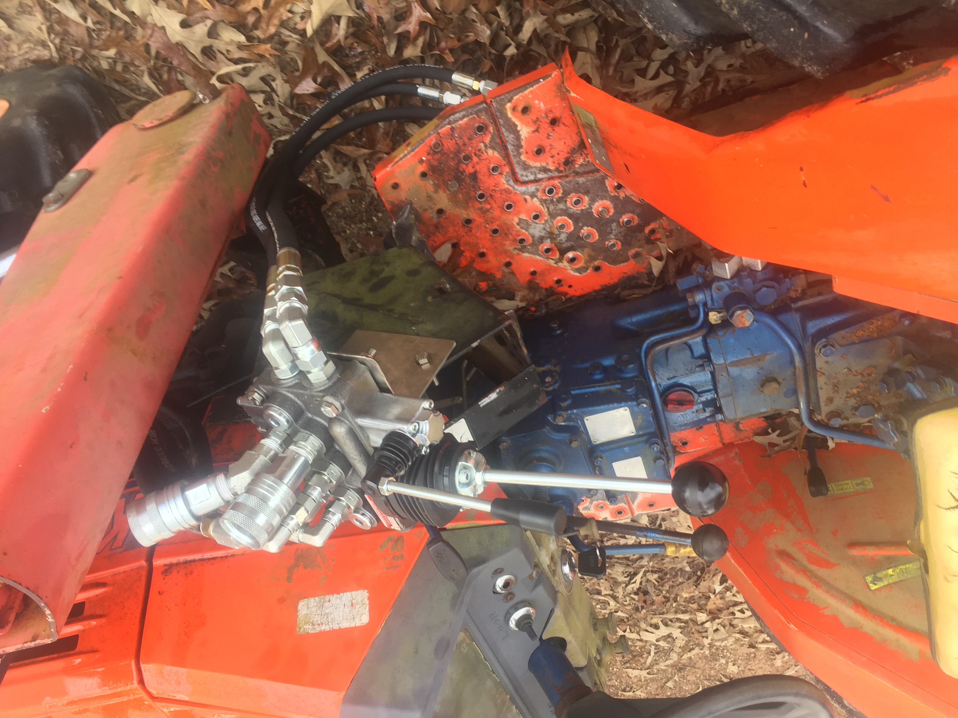

I was able to run some more test. Warmed up tractor and fluid for each test.
Operated at several different RPM settings and found if I curl down while raising boom the boom still falls. If I feather very carefully I can get it to raise or hold while using both functions.
If I curl up and raise at same time everything seems normal. If RPM is to low, it will stop raising the boom and curl up then resume raising the boom.
If I raise boom up then try to feather it back down the system loads as if trying to lift tractor or lifting a heavy load. If I idle down then lower by pushing fully on joystick, it does not strain at all. Not sure why it labors if I just barley push on the joystick to lower boom.?
I am starting to think the new valve has regen and that is why it is performing this way. I will have to get with the folks I got the valve from to find out. They do not open again till next week.
If anyone has any idea of what is happening I would appreciate the info.

I am fairly confident it is in the valve, mainly because of how it labors retracting the boom cylinders. With tractor off and boom in the raised position, I can easily feather the valve to lower the boom. It only shows resistance when the pump is providing pressure. I am sure it would labor with hose disconnected. I had the same issue with the 7GPM pump. I did not have the issue with old valve. The falling I could deal with more so than the inability to lower the boom slowly. If using forks and want to gently set the load down it will be almost impossible.

Some valves have terrible metering and from what you are describing the Youli could be one of those. I know that I removed the "factory" valve on my Branson for this very same reason.
When lowering the valve has to meter oil out of the cap ends while allowing oil into the rod ends. Getting this metering to work effectively can be challenge for valve designers. In most cases better metering requires more spool travel and adds cost.
Can you install pressure gauge in the rod end of the lift cylinders and watch this pressure while lowering? Curious to see if it bounces significantly when lowering.
