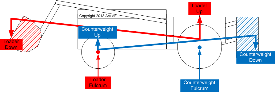

Please take another look at this diagram

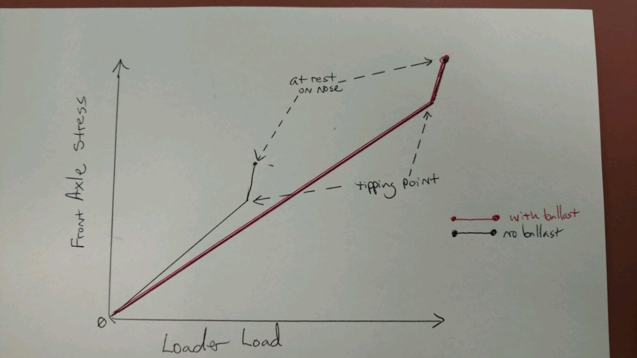

This is quite interesting to me.
3pt balast takes some weight off the front axle when unloaded/lightly loaded....
BUT...
The added lift capacity that ballast gives the loader will likely result in a higher cumulative stress on the front axle as heavy loads can be regularly placed on the loader!

This may need to be refined but...
BUT...

Few things that need to be mentioned here:
1: Gladehound (plus any others that might be in this thinking) Having loaded tires while very useful for adding weight/traction that then means you can carry/lift more with the loader DOES mean that when you carry/lift more you are also subjecting your front axle to more weight/stress thereby potentially increasing the chances of axle failure sooner. Why is this so? Look at that great diagram posted earlier (Koua just posted it again post number 94) by adding weight to the rear tires you're only effecting the front fulcrum which allows the tractor to lift more without the rear end coming off the ground. (Potentially if you can get enough weight into your tires you could max the lift capacity of the loader and still keep the rears on the ground. Sorry I'm too lazy to draw this out but hopefully if you look at that diagram you'll understand.) So if the front axle is the only fulcrum affected then when using the loader it gets the additional weight applied down thru it.
...So that is an additional reason why when using the loader the best place to have additional weight is behind the tractor - a counterweight on the 3pth. I hope this helps as I noted by your posting and your picture that you don't use a real counterweight that's hung behind the tractor far enough to be of much effect.
You're asking about damage or potential damage to the front axle - yes you're making your tractor useful by weighting your tires but you're not helping your front axle. use a counterweight and you'll both make your tractor useful and add to the longevity of your front axle.
