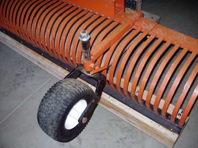

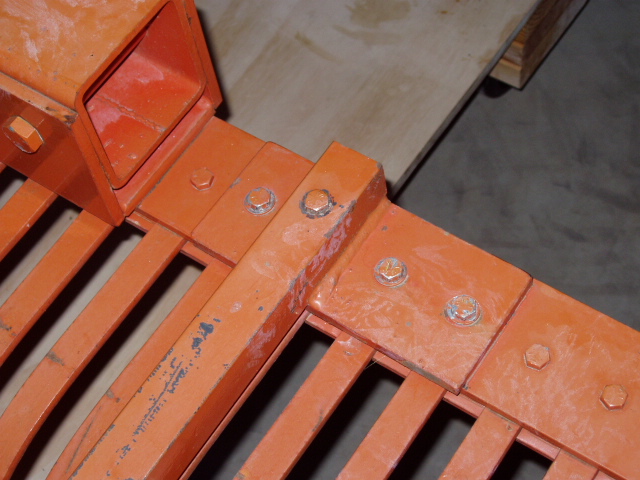

I want to add a pair of guide wheels to my york rake and i want to build them myself. I've searched the posts here and found some older ones that don't reflect todays supplies and prices. So my question is, has anybody recently added guide wheels and where did you get your supplies (wheels with zerk fittings) and what did you use to make them adjustable ? Pictures would be very helpful. I have a basic idea of what I want to do but there's nothing like prior experiance and pictures to get it right. I do have welders and plenty of steel stock but just want to get it right the first time. One problem I see already is where I want to weld the brackets on, the bolts for the tines are in the way. I know this is an old beat to death topic but a little help would be appreciated. I have a King Kutter 6' Rake.

Sounds like you have the skills and wherewithall so I think it is doable. Here are some gauge wheel photos on my 8' York RI. Notice the 1/2" plate anchoring the gauge wheel strut. The bolts are also holding the tines below in place. Drill your plate to match your bolt pattern. The tires are 13X6.50-6 2 ply rating at 14lbs psi. If you need any measurements, let me know.
If you go on the York Rake (a division of York Modern Corp) website you will find the gauge wheel accessory for sale, not cheap, around $500.00.
Good luck!

Get them from ebay for $100 + ship. I paid around $120 shipped and put them on a King Kutter 7' rake.
NEW Bush Hog Gauge Wheels for Landscape Rakes (2) - eBay (item 290348887111 end time Apr-09-10 07:22:18 PDT)
I just pulled up your ebay link and saw that the dealer is Rosseel's out of Michigan. I bought a new Woods BH90-X backhoe from them last year and saved several THOUSAND dollars. They are a real brick and mortar over the counter country type store with a national high volume, low profit internet sales desk. I was 100% satisfied with the transaction which included the BH being shipped out here to California. If the gauge wheels will fit your rig-go for it.

The ebay one is pretty nice. Built sturdy and has good adjustment. For $100 it is very hard to beat. Mine needs some extension due to my Kubota BX having to use a really short top-link to lift my 7' rake as high as I like for carrying.
/ York Rake Guide Wheels #8
the tire looks like a walk behind spreader tires, think thell hold 300 lbs?
I agree with you. If you get these heavy 3-pt rakes out on uneven and unlevel surfaces I can only speculate that a 6" wheel will outperform a 4" wheel. My 8' York RI rake has 1-1/2" square bar stock struts the connect the guage wheels to the tined frame. Hopefully that will give you some indication as to the stresses on that gauge wheel system.

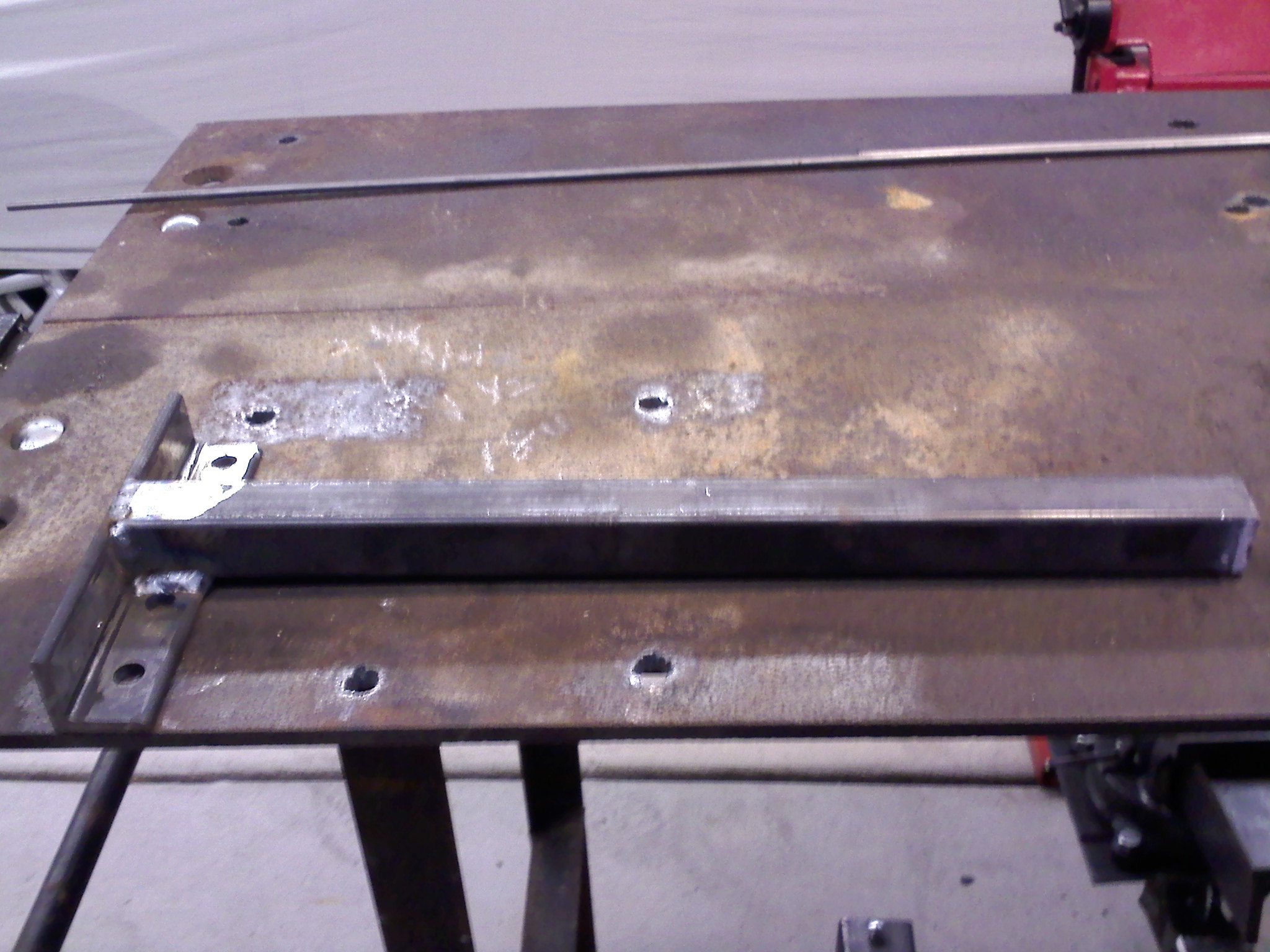

after a lot of help from TBN i started my build.
Picture #1 Brackets that fit the holes of the tines
Picture #2 Square tubing for over the tines support
Picture #3 Square tubing for legs
Picture #4 Welded up, Lincoln Mig .030 wire Argon Mix
Picture #5 1/2" nuts that accept 1/2" bolt to hold and adjust legs
Picture #6 Gussets for added strength when pulling forward
Picture #7 Caps to keep water out and stop the legs from falling through
Picture #8 Just have to buy some tires, wait for the mud to dry up and try them out
Thank you everybody for your input and help

Wow JJ,
Nice work! Are you building the casters or buying? Whatever you do, post pictures when is done and painted. Those welds look mahvelous to me!
