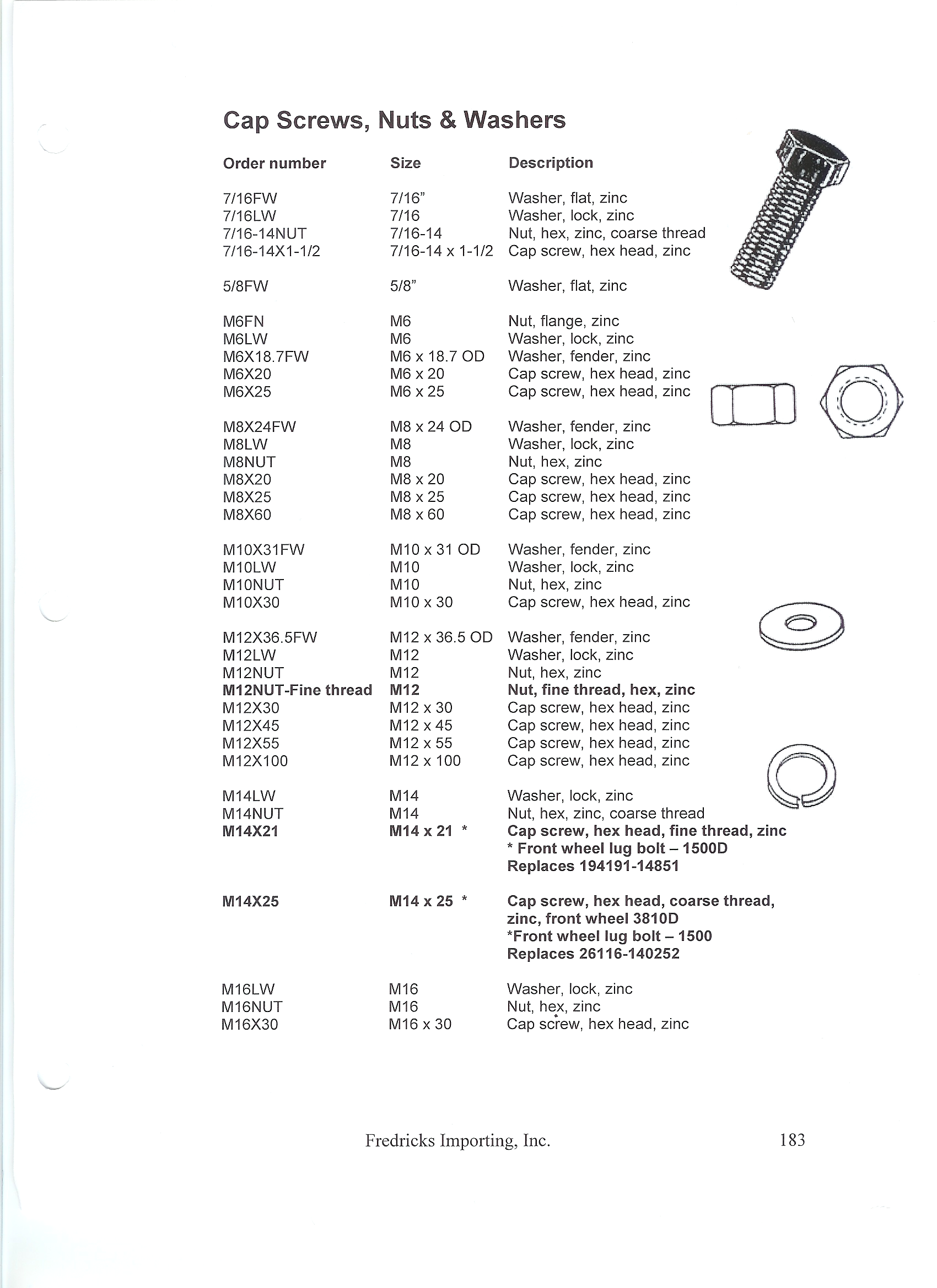

I'm putting together the engine on my YM240 d (came to me in a box) and I've encountered another problem. The head bolts (studs). All 6 are the same size but it appears that the one in the intake should be much shorter. Is there a spacer missing or did someone put in the wrong stud. The hardened studs are M15X1.5. The one I need looks like it should be about 75mm long or a 60mm bolt would do. I have emailed Fredericks and Schaeffers and called Hoye. So far no luck. Now I'm looking for suggestions. Anyone out there have the short stud or bolt or know where to get one?

Fredricks seems to lost some Part#. If you look at their website under Misc. I would think they would have it

I know. The studs are larger than 14mm and smaller than 16mm. We measured them at Fastenal and they were 15mm. They said they were probably made only for Yanmar.
