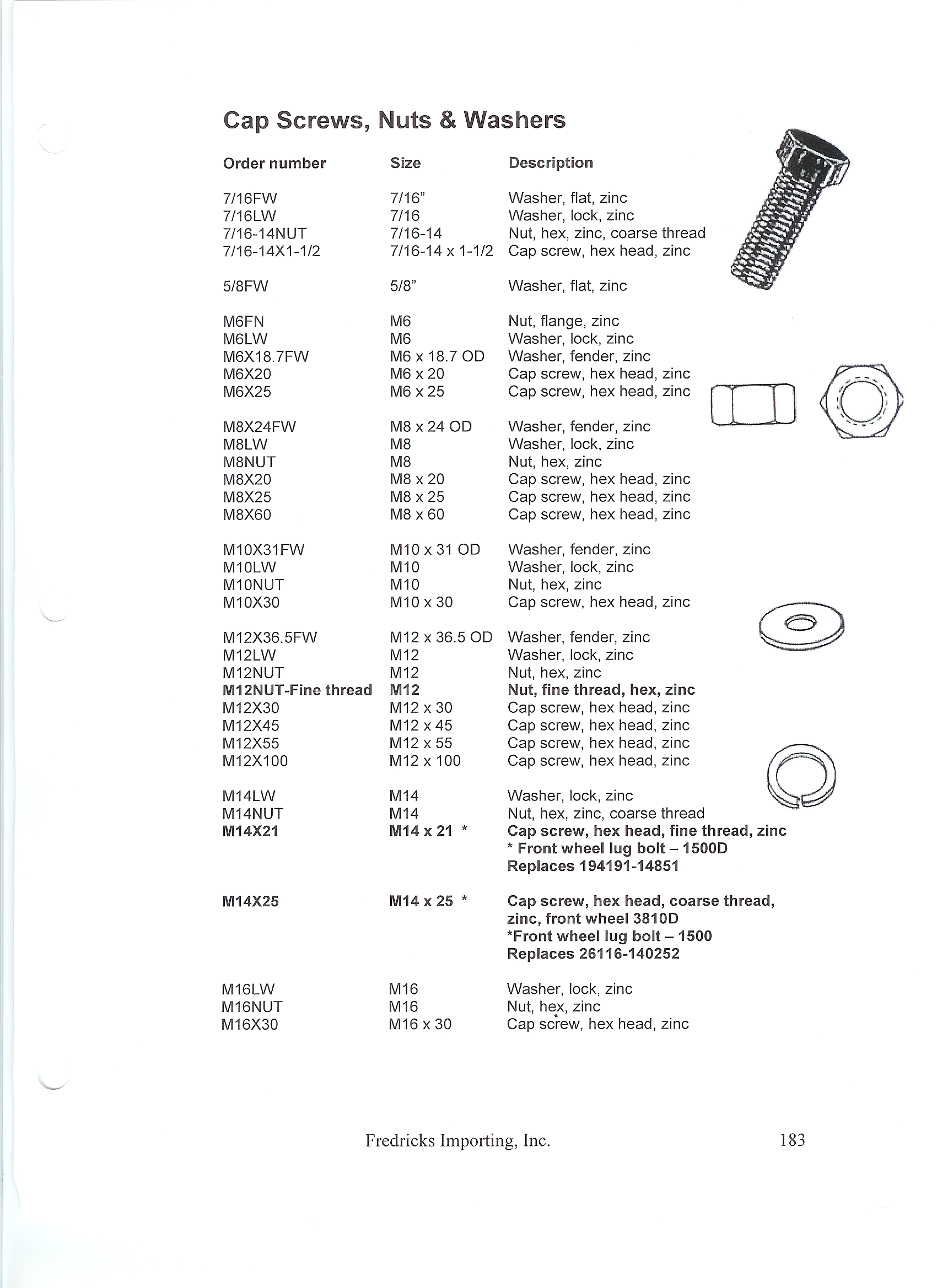

I called Fredricks soon after I started this search. The mechanic I talked to (Danny) said he thought he had one and would get back to me. I talked to him this morning and the stud is on the way. Thanks to all that replied.
