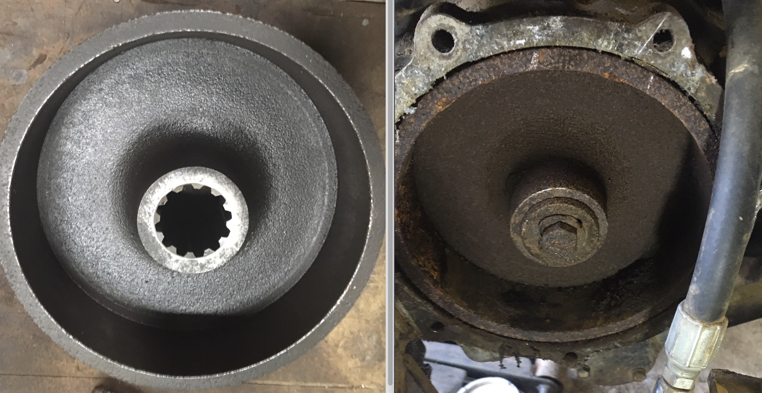

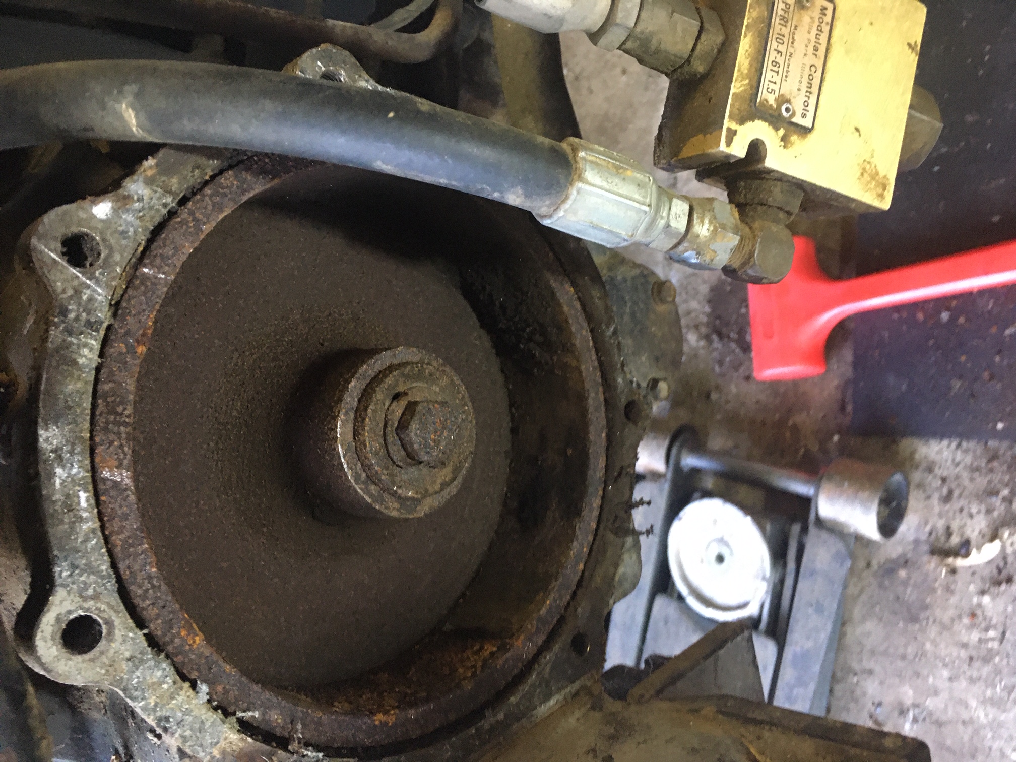

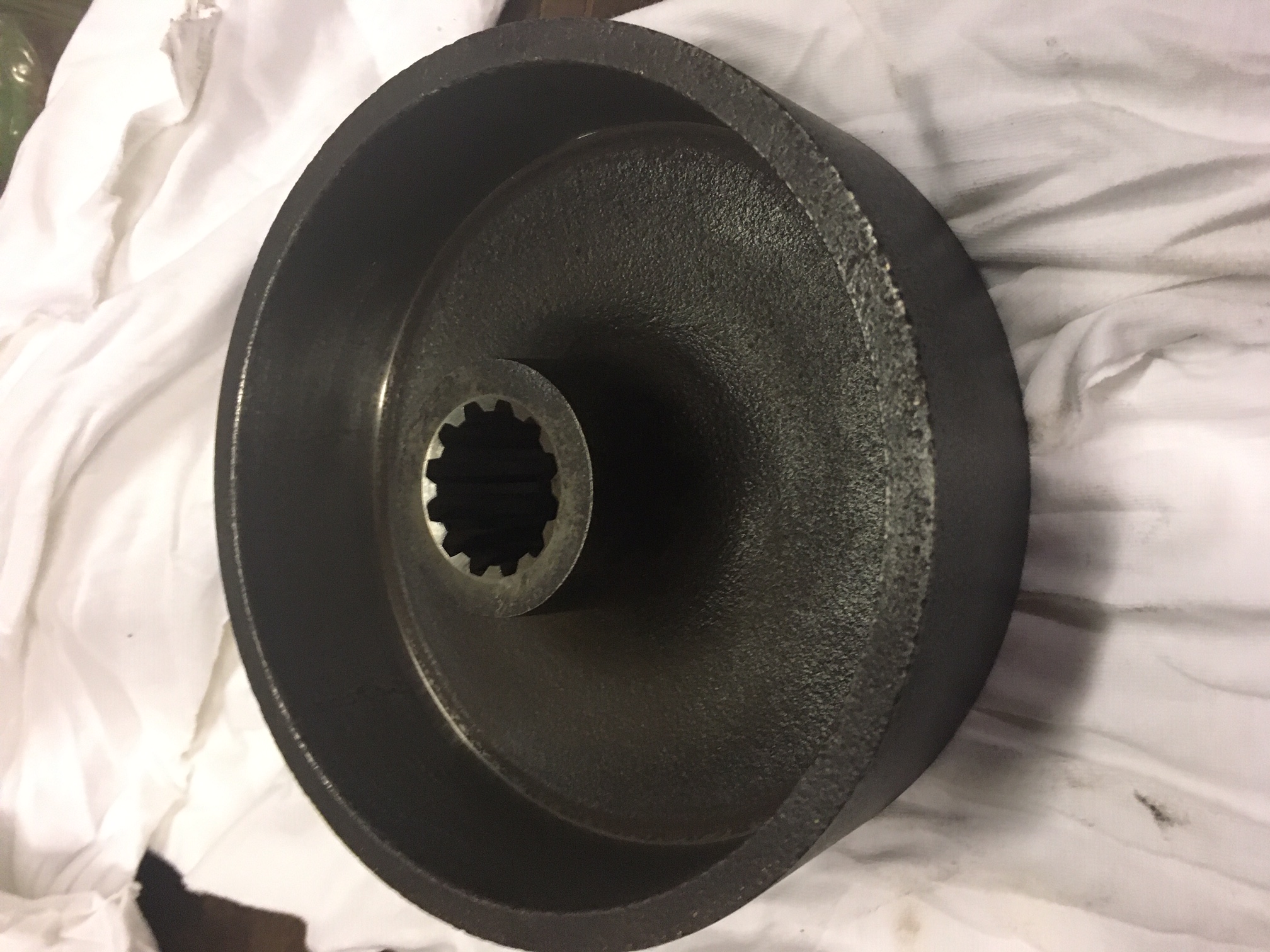

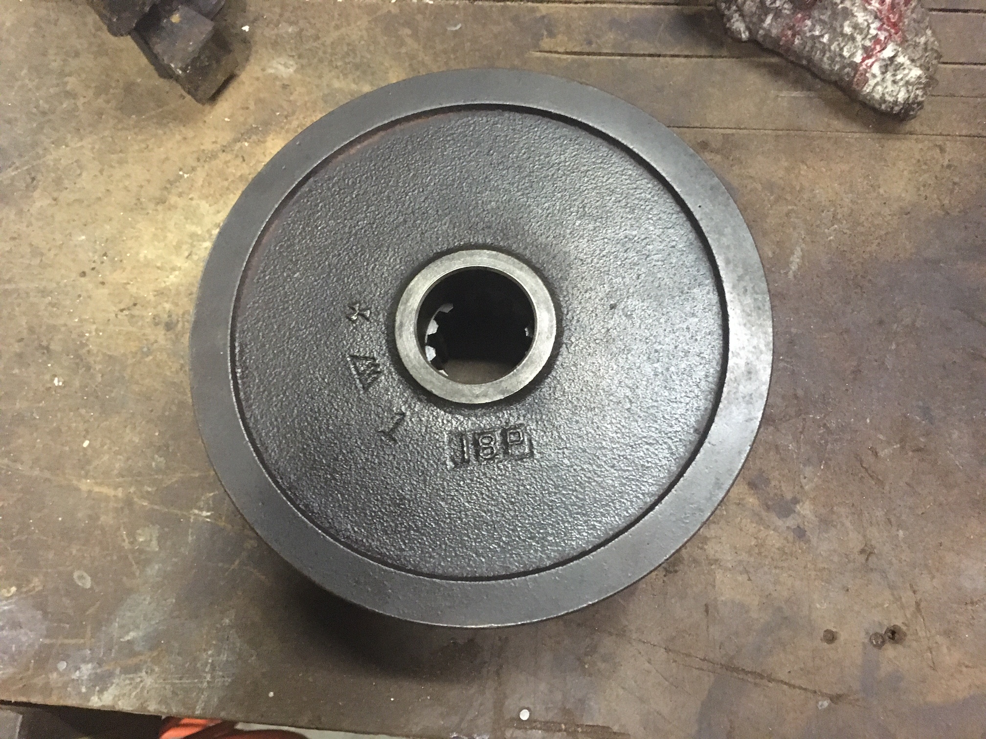

As suggested, the drum goes to the local mechanic to get machined tomorrow. Here is the rusty drum cleaned up a bit from when it was on the tractor.
Versus this on the YM276D.
IMG_4085.JPG Clean:Rusty.jpg

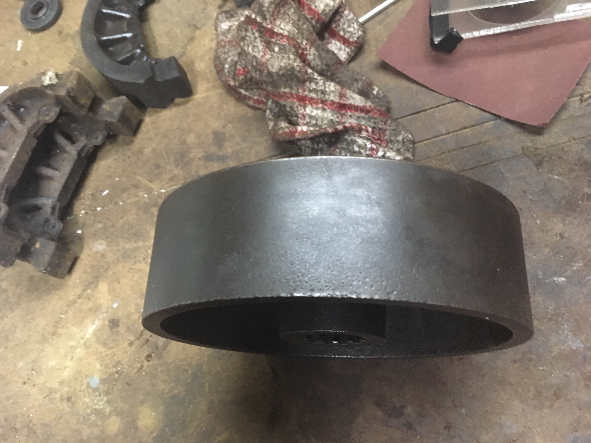

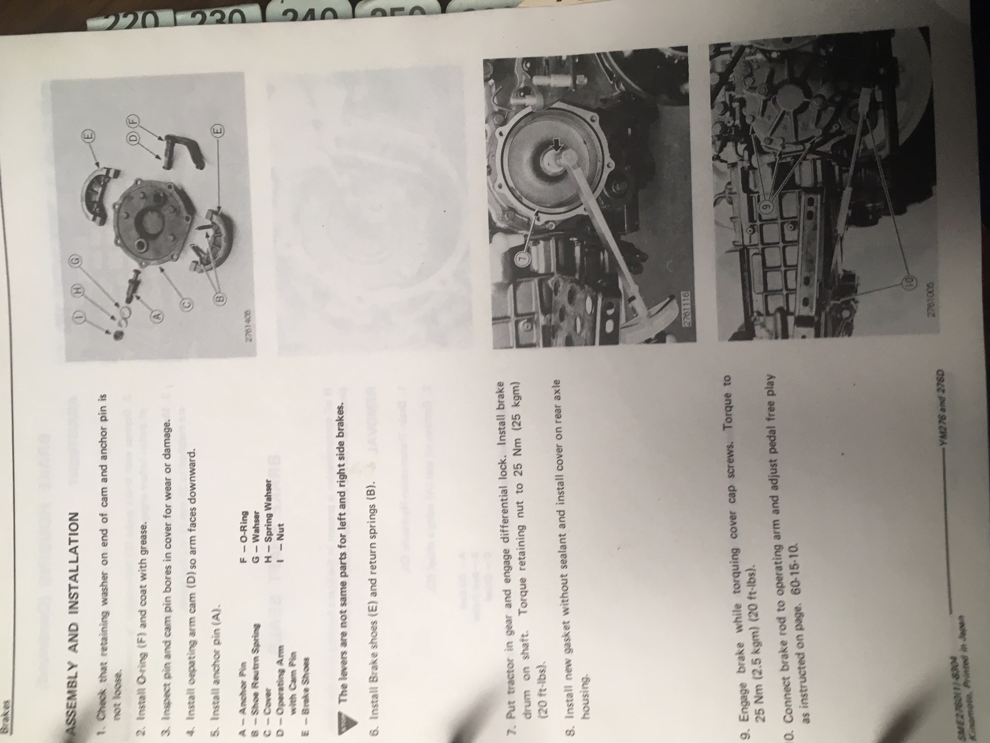

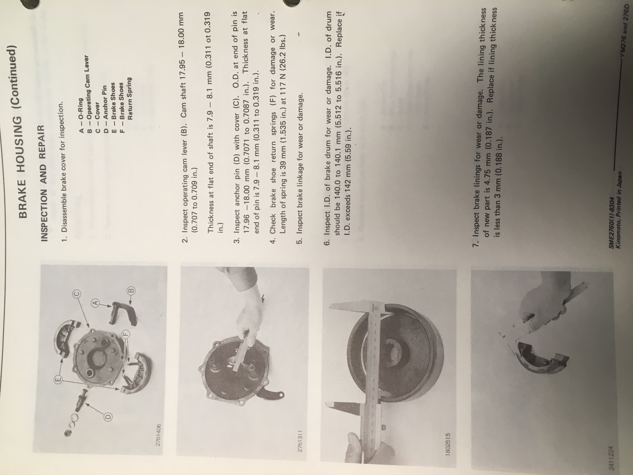

The mechanic didn't have a tool small enough to machine the drum. Hopefully a machine shop can surface the drum. The original YM276D Manual seems much more detailed with diagrams and information.

Have you measured your drum’s inner diameter? 2 thoughts here.
1) Is the drum out of round—constant pressure from the locked up breaks equals heat build up. Then with the one liner loose inside the drum, it could have had pressure to force it out of round.
2) 2mm of wear allowance with continual pressure for ??? how long.....longer than you have owned it! Along with the depth of your pitting, you may just need to be looking for a replacement drum. Hoye shows it as a used part only so call them and any others you know of that might have used parts. Aaron at Hoye may be able to let you know of other tractors that may use the same brake drum.

Yes, I agree that a machine shop is the way to go for this. It sure would be easier on the machinist if he had a splined shaft to mount the drum on to maintain concentricity. Hoye may have a stub shaft that he uses as a tool for this. Probably worth a call.
I don't believe these are lined drums. it's been a lot of years, but I recall them as being one piece.
/ YM276D Brakes #56
I totally agree the drums are not lined but are as you say one piece. My reference to the lining was that one of his rusted up brake shoes appeared that the bonded brake lining had detached from on of the shoes. It was then possibly free to jam against the drum and other parts to constantly create heat and then when allowed to cool cause distortion in the drum.
Also that 1.9-2.0mm is very tight tolerance on being turned on a lathe. An inexpensive 6” slide caliber could have him using the time to find a machine shop to handle splined center looking fir a drum if it is beyond 142mm or out of round.

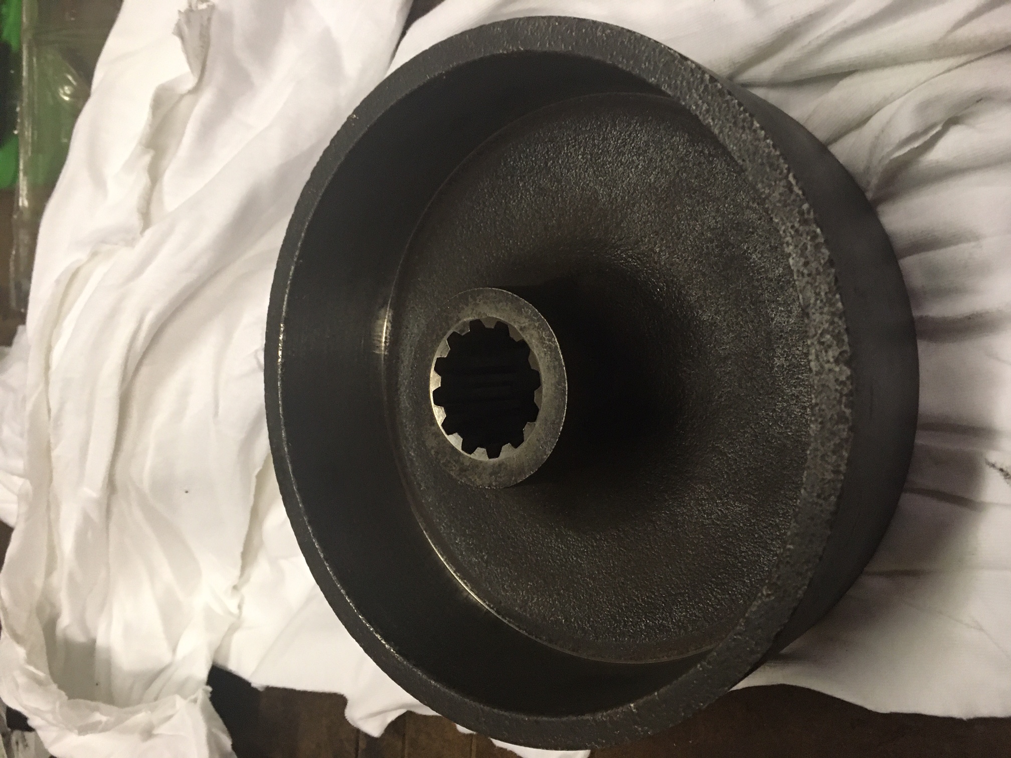

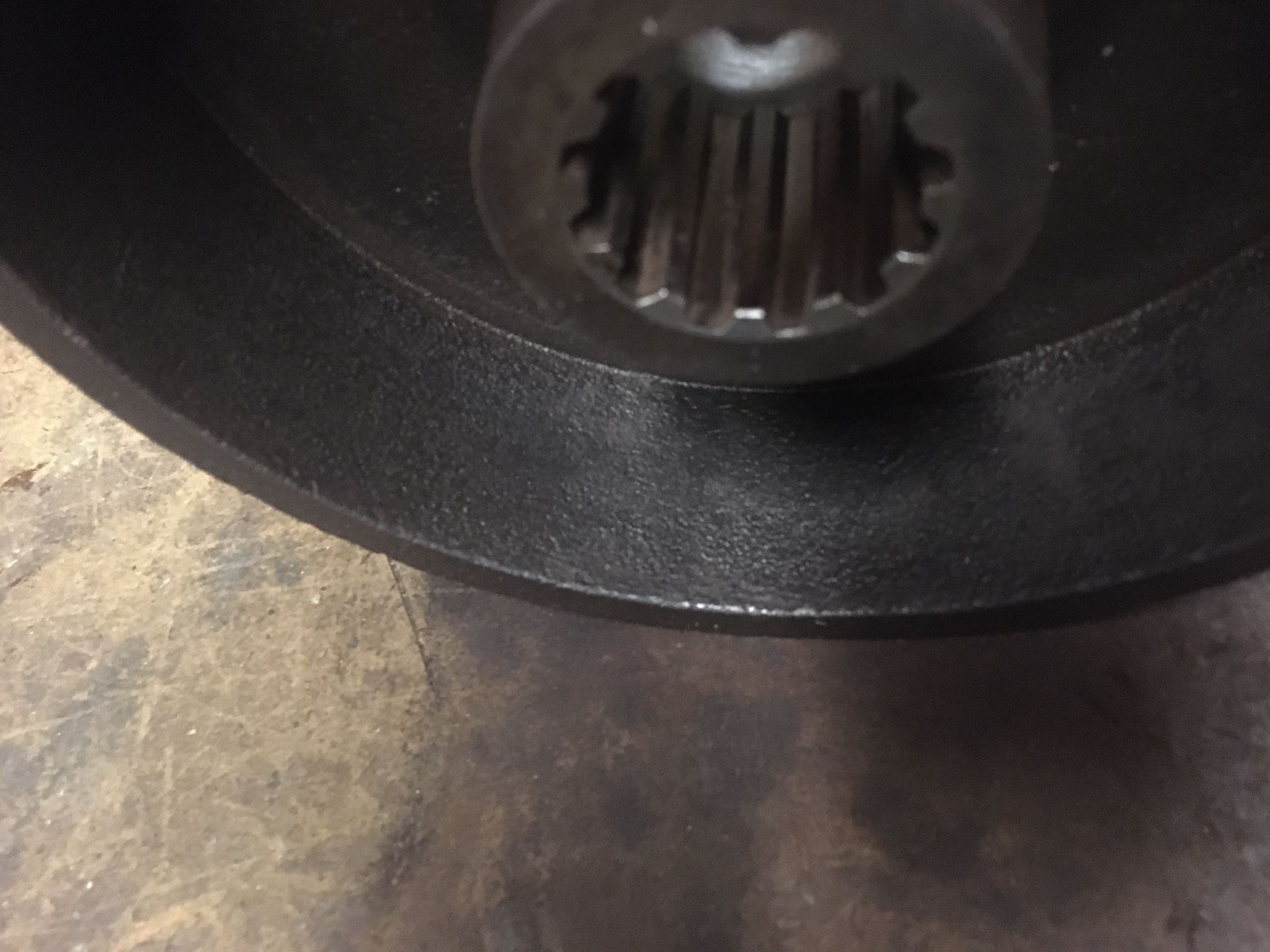

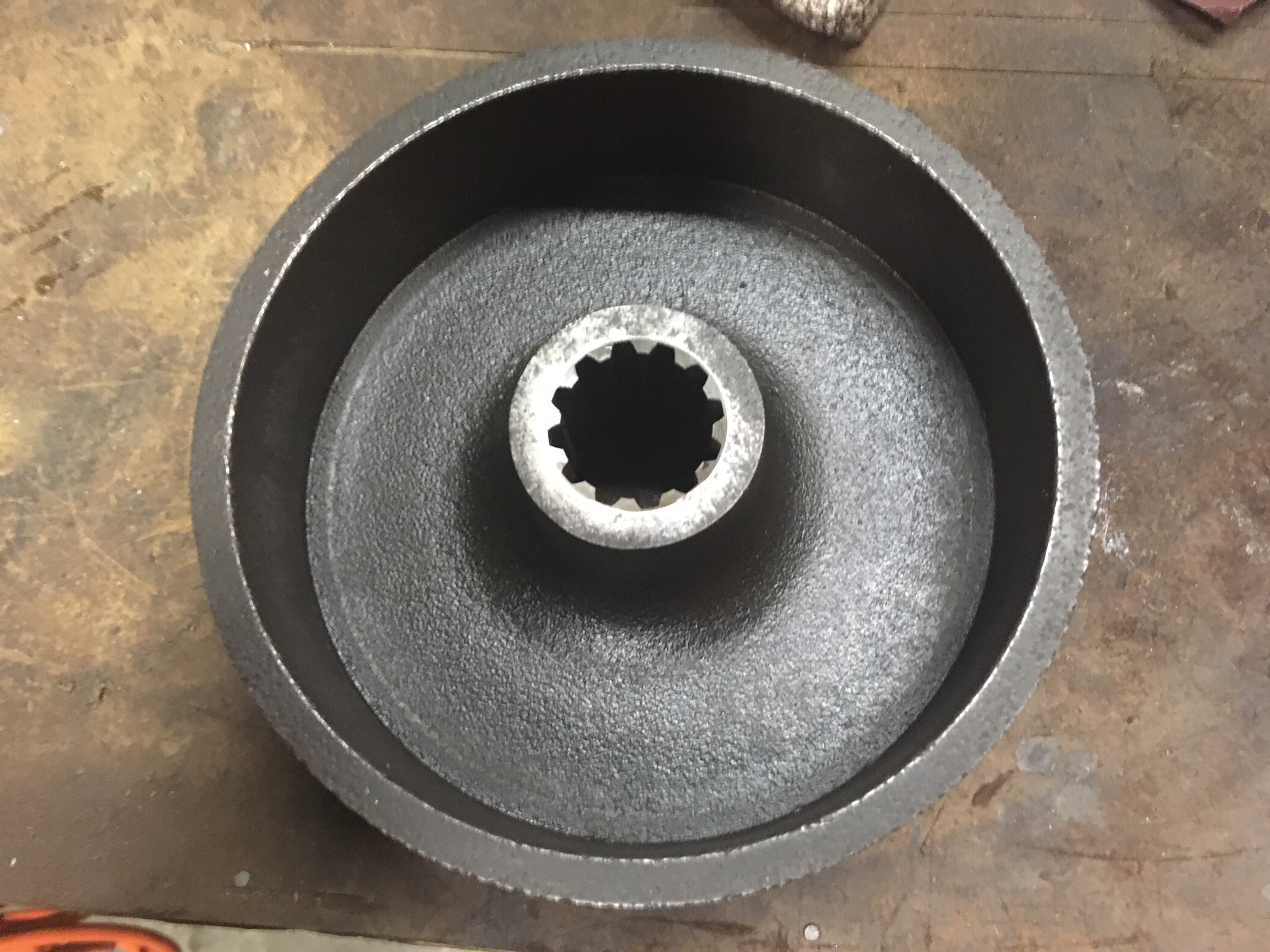

Coy, the machinist checked for out of round prior to working on the drum and stated it fell within tolerance. He also read the specifications from the manual provided above and said after machining the drum falls within specifications. The machinist finished the drum today and said he removed about 17/1000". Almost all of the pitting is gone, but some minor pitting exists. Running a finger across the area doesn't allow one to "feel" the pitting at all though. There is a slight discoloration in the area where the "pitting" still exists.

I agree with rScotty on not messing with the stationary pin at least not as long as it is the correct orientation for your shoes. Considering the condition that the cover appeared to be in when you got it off, you could create more problems.
It has been many many years since I have done any brake machining work, but I still have concerns about the drum. Back in the day, a standard pass on a lathe was 0.010”. Perhaps this has changed over those years I do not know!
The concerns that I have still have are
1) he did not take out all of the pitting
2) 0.017” converts to 0.4318mm
3) you did not mention measurements merely that you were told it was within specs
As you are talking about braking from high speeds as in an automobile, it will probably be fine. In truth if the drum was not out of round, it would have likely been fine without being dressed.

It has been many many years since I have done any brake machining work, but I still have concerns about the drum. Back in the day, a standard pass on a lathe was 0.010? The machinest completed two passes because the first pass didn't remove the pitting to the touch. Apparently he wasn't quite cutting .10" each pass (or at least on average) Perhaps this has changed over those years I do not know!
He said he removed it to the touch but not discoloration. Technically the pitting is gone.
2) 0.017 converts to 0.4318mm
The machinst measured the drum after turning at 140.5mm, the range is between 140 and 142mm for the drum.
3) you did not mention measurements merely that you were told it was within specs. The second photograph in post 53 in this thread shows the specs between 140 and 142mm (and a few other specs) according to the Yanmar manual
As you are talking about braking from high speeds as in an automobile, it will probably be fine. In truth if the drum was not out of round, it would have likely been fine without being dressed (several people suggested it was fine with a sanding, but I wanted it to be smoother).
I do not know about your usage of brakes, but I do know that from your description, you have not had a brake on that side since prior to your ownership of the tractor.
