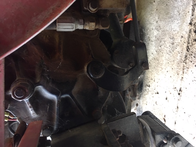

The right rear brake on the old YM276D is frozen. I watched the video and ordered the new brakes from Hoye Tractor. The brakes should arrive on Monday. How difficult a job is it to remove the brakes when they are frozen? The video mentioned the cover plate is cast and to be cautious.

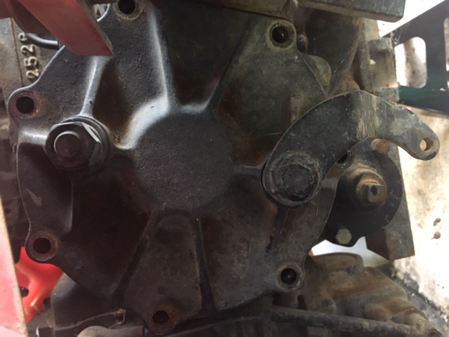

I started on the brakes today. Took off the tire and removed the cotter key/pin to disengage the brake rod. The shaft isn't budging even a fraction. With the shaft not moving, is it safe to attempt to remove the cover? I don't want to break the cover or any other parts. Here is a picture of what is visible with the tire removed. You folks who do this job with the tire on must be contortionists.

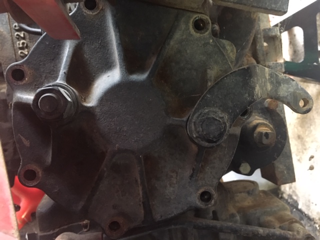

That's more elaborate than my old-school YM240. After taking out the cotter pin I was able to put a big Crescent wrench on the naked lever, to force it to 'disengage' position. Here's a photo (from my recent axle housing replacement project) showing its simplicity. Can you get a Crescent wrench or pipe wrench in there to rotate the lever?
I think putting the brake pedal at its highest position then rotating the lever until the cotter pin can slip in, might indicate where the lever should be when disengaged. Or the sweet spot where the shoes are fully released, may be a little beyond that position. Good luck with this!

The cotter pin has been removed and the lever is "naked." A pipe wrench or Crescent wrench will most likely work....a pipe wrench more than Cresent most likely. Your advice on placing the brake pedal at the highest point seems spot on and offers a good approach.
If I am looking at the photo you provided, you have the axle off but the brake is still in place. I need to watch the Hoye video again.

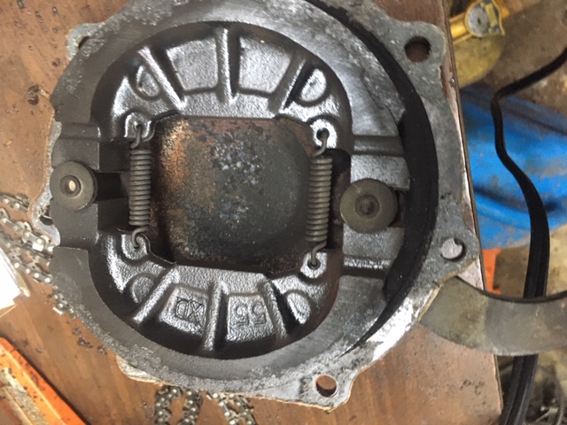

I have been away a few days but decided to take off the left rear brakes to determine approximatly what position the lever should be located; after all, both sides need to be replaced.

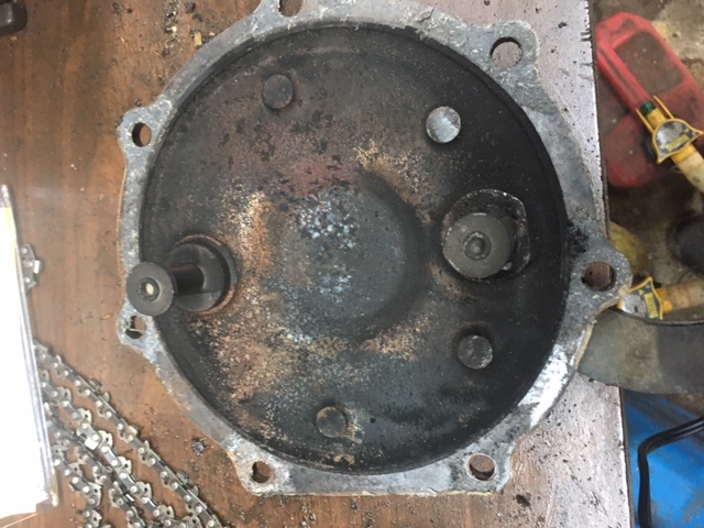

I removed the left brake in about two minutes doing exactly the same thing done to the right that remains frozen (for lack of a better word). The rear tires are reinstalled in place for safety if the YM276D fell, it would land on the tire. As you suggested, when the tractor runs, the left wheel spins free and the right wheel is locked in place. The right wheel rotates just a hair. When the tractor is turned off, you can move the entire assembly by hand about five degrees, but it wont' budge after that. The five degrees is the approximate distance it can travel before the cover contacts another part. Prior to today, one needed a tool to move the assembly the five degrees. Since the YM276D is up on jacks in the rear, it might be possible to throttle more power than the simple low idle to see what happens. Here are a few of the pictures of the left side brake.

Trying to grasp the issue from your pictures and descriptions and am somewhat confused. I admit I have not ventured into my yannie’s brakes (perhaps I should before an issue). Since you have the one side loose and shoes removed, could you reinstall the plate, and compare the movement of the brake camshaft lever from the disassembled side to the ‘frozen’ side. This would give you a reference to travel and then perhaps a reference to the cam position on the stuck side.
Another though is to unbolt the cam shaft and upper pin to remove the outer plate. That way you can at least see where the shoes are stuck at and perhaps disassemble from there.
Again I have not been into mine, but your upper pin appears to have a nut, Hoye’s diagrams show nuts. With an O-ring in the camshaft for movement and a replacement available from Hoye, it comes out some how.
If like vehicle drum brakes, the shoes have cut a groove into the drum and are locked behind it. Either the camshaft is stuck/frozen or the spring(s) have broken and have the shoes jammed.

You are correct. I did just that and have the lever and the cam position of the opposing plate in the position that would not be forcing the shoes apart.
Again I have not been into mine, but your upper pin appears to have a nut, Hoyeç—´ diagrams show nuts. With an O-ring in the camshaft for movement and a replacement available from Hoye, it comes out some how.
I will attempt to remove the upper pin from the left side that is already out. My guess is that it will need to be pressed out, but that's just a guess. If it requires a press, it won't happen in the tractor. You might be right about the shoes cutting a groove in the drum. The camshaft now moves and isn't frozen. There is no room to see if springs broke. I might get a larger dead blow hammer to see if it can jar something loose.
