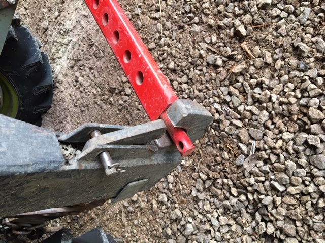

Looks like you have a quick connect with a tow bar across it, yes? How do you keep the tow bar from spinning? I've seen the little attachments at TSC, but those won't fit a quick connect.

You're asking about my watering trailer? It's not modified aside from those 12 inch car tires, off a Chevelle or something that had 4-bolt lugs. (wider than 5.00x12 trailer tires). The trailer was a well-used $25 Craigslist find. Photo.
2600 lbs loaded is grossly over the spec capacity of a half ton but I don't need highway-grade safety margin. if something ever fails, just drain the water and drag it back to the welder in the barn. :) Actually I did bend something: backing up uphill in very soft ground with the 8" tires half buried, the tongue bent. I straightened it and welded on a piece of bedframe angle iron to stiffen it.
P1670281rWeldWateringTrailerTongue.jpg.
As for stabilizing the drawbar in the qhitch I welded adapter sleeves to (removable) small plates then bolted both ends of the plate to the drawbar. My 10 years use hasn't bent the plates - but higher hp would.

Adapter sleeves??
Could I see what the other side of your qattach looks like?

Adapter sleeves?? Could I see what the other side of your qattach looks like?
There's not much to look at. That little plate in my photo is bolted to the hole at the end of the drawbar and to the first larger hole. I have an early HF QH that needs Cat 1 to Cat 2 bushings on the implement to fit the hooks in the QH. So I mounted the drawbar using those bushings, bolted the plates, and tack-welded the visible part of the bushing to the plate. Then I carried the bushing/plate assemblies into the shop and welded beads down the front and back of the bushing/plate joint. These weld beads bearing against the front and back of the QH's hooks bear the twisting stress and stiffen the plates.
The sleeves aren't welded to the drawbar so my adapters can be unbolted and removed, but I never have.
I think later QH's come with larger OD bushings for your implements so use a pair of those to make these anti-twist gadgets.
I'm back in town now after a week out at the ranch (orchard) or I would take a better photo. That's the only photo I have that shows my anti-twist adapters. I've used these since 2009 and they haven't bent.

Ah, I got it. I wasn稚 really familiar with cat1 to cat2 bushings but that makes since. For once, no additional photos needed. Haha.
