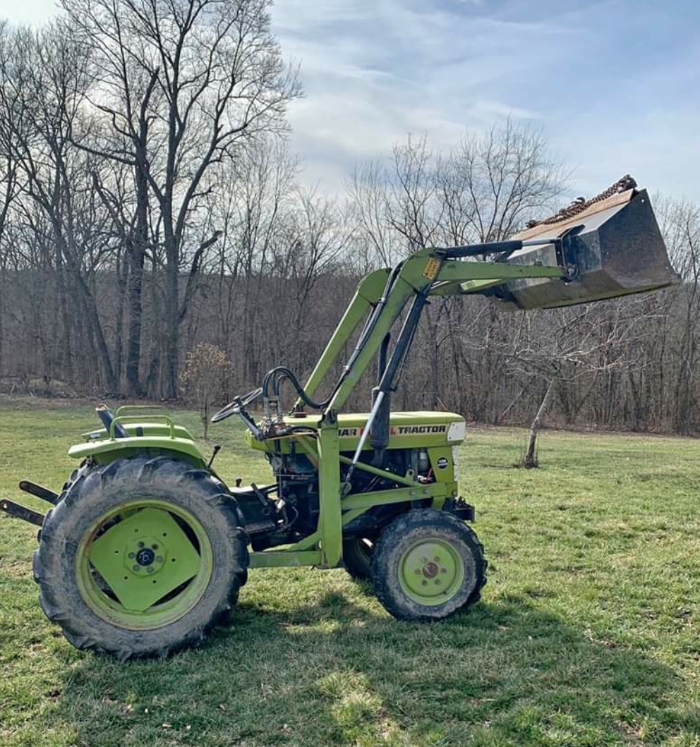

I'm tech. 1 arm and handed. It's all there intact but limited on a lot of things. I don't have power steering on theYM2000. I've used it for 12yrs. with the injury. Primarily my FM. 8 months a Yr. easy. When I hit the end of a pass it's so easy to turn around and with no FEL. you won't need it. I only have to hit Rev. once to backup a little. 5' maybe and start the next pass. Easier than a riding lawn mower. A Garden tractor - Sears mower Was replaced by the 2000. And the Biggest plus was the blades still cut while moving in Rev. :thumbsup: I finally have my 2nd. Gear PTO staying locked in and not jumping out of gear so my Eng. RPM's stay down and shifting is only momentary to keep from grinding gears. I still to the day catch the shifter with my heel a knock it out occasionally. Esp. if I'm wearing boots. Foot space is limited IMO.............. With the sprayer your only have to barely move and be able to turn the wheel with a couple fingers I bet. I have used a FEL. on a tractor and then PS. is a must have Esp. for me.

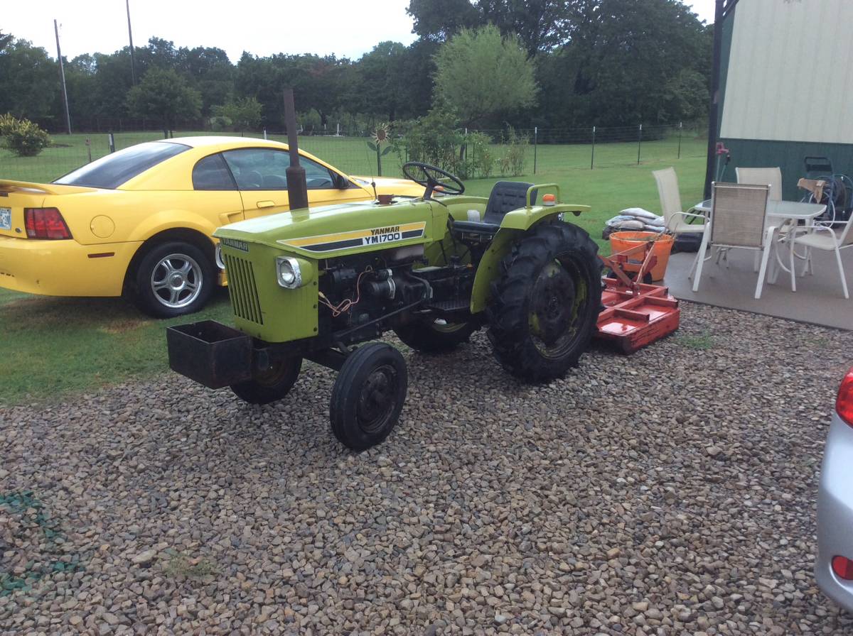

Ok so some of the real early yanmars such as the 1700 may have been green. As for the year that depends on the hood/headlight placement. If this 1700 is green it could have been repainted or is an early version of the 1700 from 1975 or 76 possibly. So if the headlights are on the outside of the hood on each side it is a very early model if they are in the grill/hood it is a later model from 1979 ect. Either way I stand behind what I said about the hp ratings and such unless someone else here has a different opinion, feel free to correct me on this.
Do you have a picture you can post for us to look at so we can better help you identify the year/time frame of this tractor?

Tried to upload a photo, first time, not sure it worked correctly. Can you see it?
/ YM240D. Good deal? #30
That is a very early yanmar 1700. That is probably from 1970-1975 you can tell by the hood, grill and healights. Still probably a very good tractor and looks to be in good shape. How does it run?
