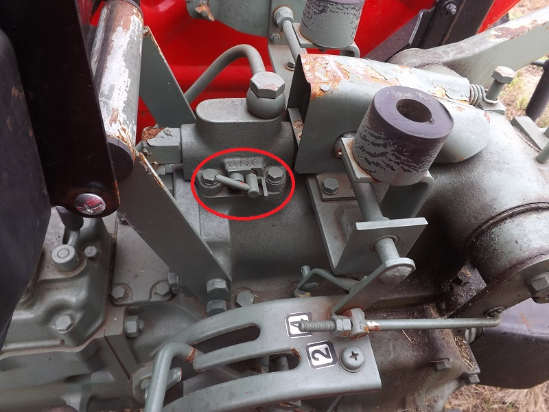

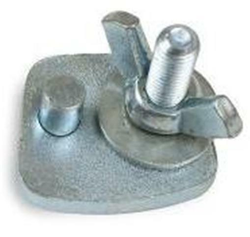

Eric,
Have you looked at your Parts Manual for the hydraulic control valve assembly? There are one or more little levers under the seat. These will lock the hydraulic at a certain height. This is mostly for the optional draft control.
Now, on the raise/lower 3PT lever, you can use a paint pen and scribe a mark line to the certain depth to drop the auger.
Or like Tinhack said, EZ-PZ to make a 3PT lever lock with a mere wing-nut or tiny knob, a bolt, 2 washers and a plastic nylon spacer.
John Deere style
Old Ford and Massey style
The Ford style I've used on my Pa's 8N. IF you are not careful, it will all come apart and fall off the tractor. Not good if you are sitting in the seat and all the parts fall to the ground.
The John Deere style above works well for our YM machines because that's the same Yanmar era machine. :) Besides, it uses a brass bolt, less rust years ahead vs. the Ford style and that awful wing-nut.

This setup is used all the way up to a 3000 and if you look at Hoye's Dia. YM2000 my guess is it's the same. I'm limited on part# for a 2310. You need 63-66 Control Lever. THREE_POINT_CONTROL: Yanmar Tractor Parts
His machine is more like my YM2610. Thus, the JD850 Lift Lever Stop would work best. The Hoye page shows the plate reversed on the smaller machines. Good example though. ;)

Nice Pic.!! My 3pt. had some use on it Esp. Hieght Adj.. Shaft 2 nuts. It was broken at some point even. No doubt it was welded back on the arm. 🤨 Could of an Pole digger pulled it down to far possibly?

Great replies folks. I was thinking about making mine almost like the John Deere style, just gonna add a spring so that the square on the bolt head will always stay engaged in the slot. I did know about the knob and lever under the seat but I will need to be raising and lowering the 3PH a lot when tilling or drilling. My wife and I will be planting a bunch of laurel bushes and each one needs a hole about 1 foot deep. When I plant taller cedar trees I drill about 2 feet deep just so there is lots of loose soil for the roots to go into and so that the area will drain well. I'm glad that Yanmar actually made a stop because this means that the 3PH positioning should be repeatable. Now I need to look for some sort of weatherproof stick on scale, like a section of a tape measure, to stick next to the slot so I can equate numbers to drilling and tilling depths.
