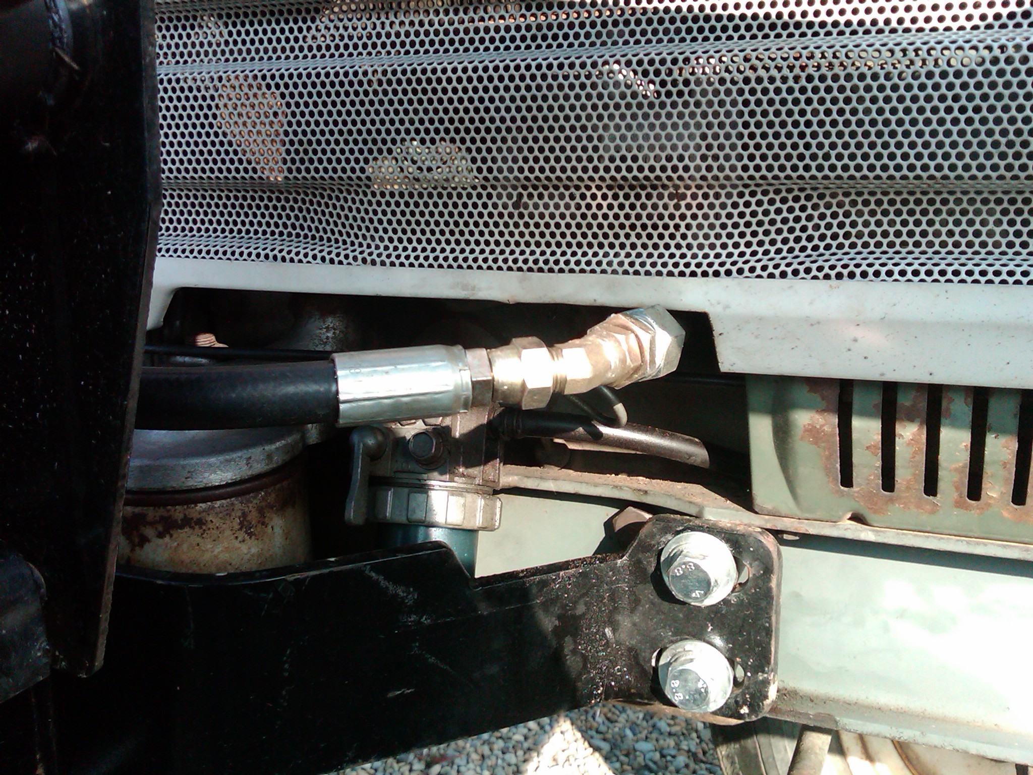

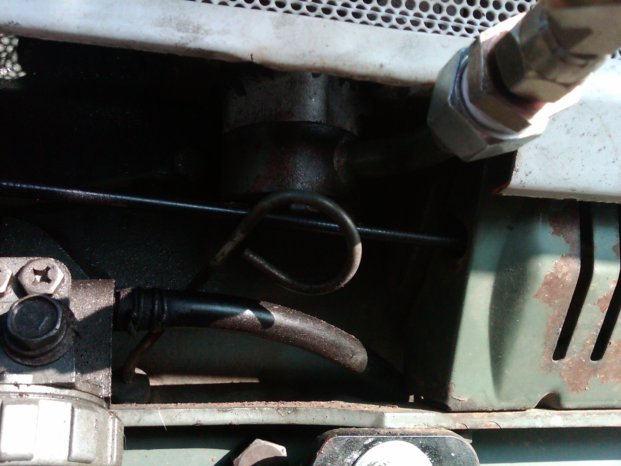

I got in late tonight and it was raining but I went out to the barn to get the best photos I could get without taking anything apart. I don't know if these will help you any but these show the 2 hoses coming from the fel and the only connection I was able to photo. I would have to look at it in the light to see if I had to dismantle it to get a photo of the other connection.

Thanks! Those actually help. I was planning on doing a compression fitting right about there for the pressure feed. Compression fitting to a 45* out, and on the return side, I am planning on doing a compression fitting right by my right foot where the line goes straight down. Then just run hose in a sleeve under the tractor instead of the steel line.
I was questioning the room up by the front though, so the pics help a lot!

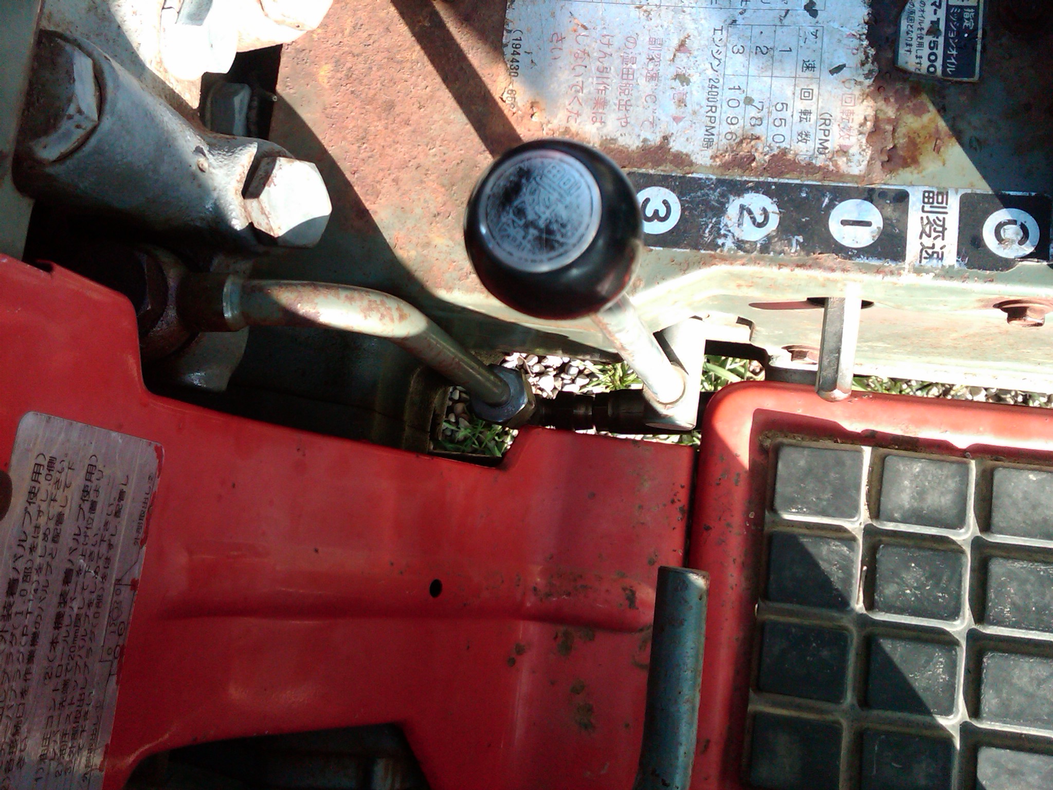

Well, I finally have more pics. Up front, where the high pressure line is attached, I rotated the fitting 90* so the pipe was pointing out, and then put a 45* fitting on to get it where I wanted. On the back side, there is a 90* fitting.
