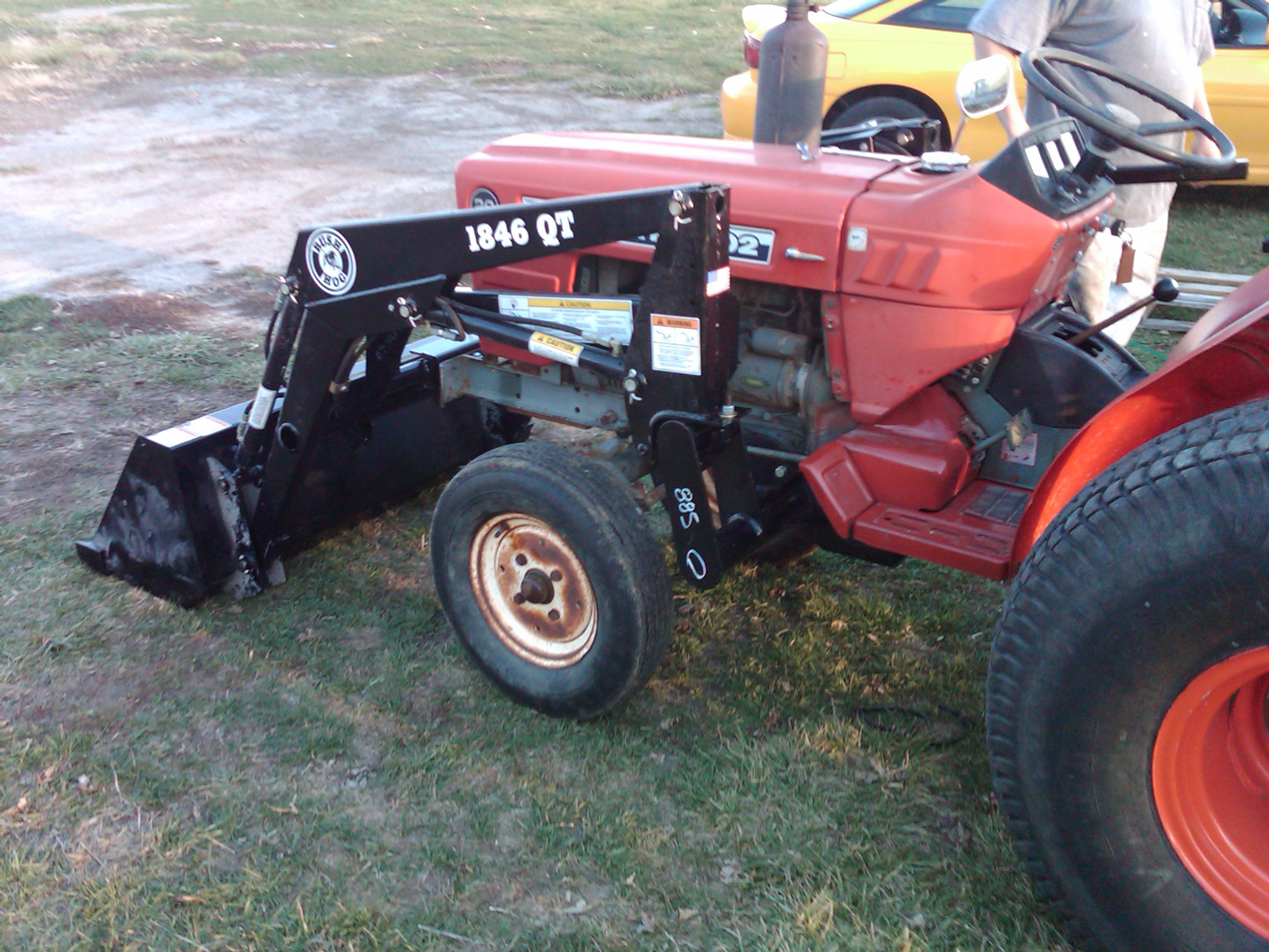

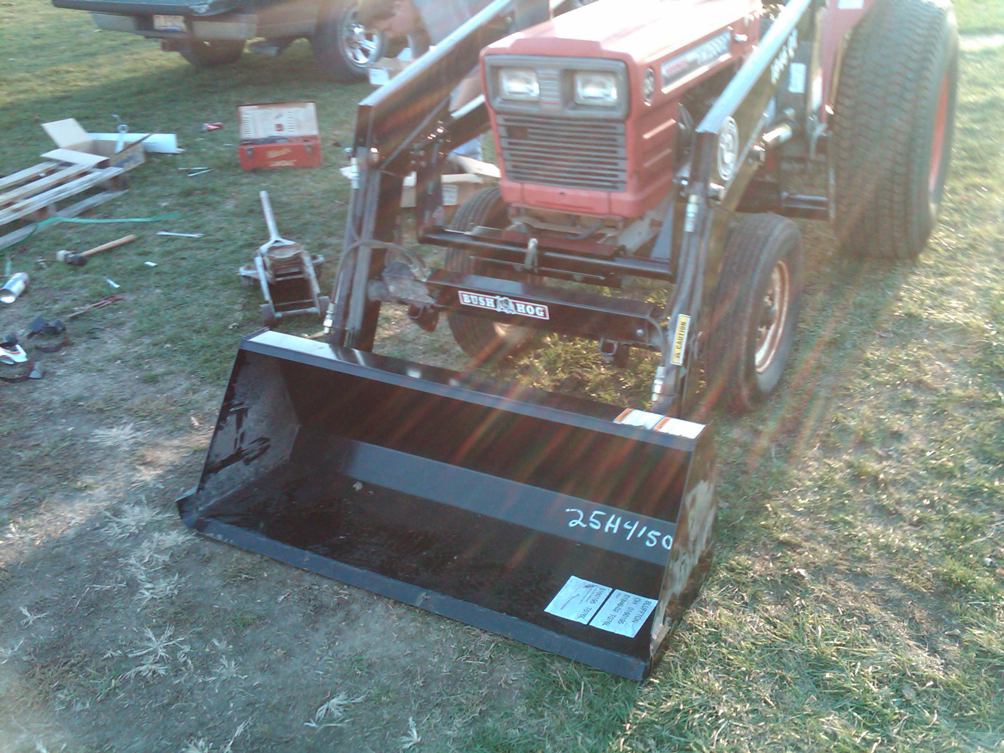

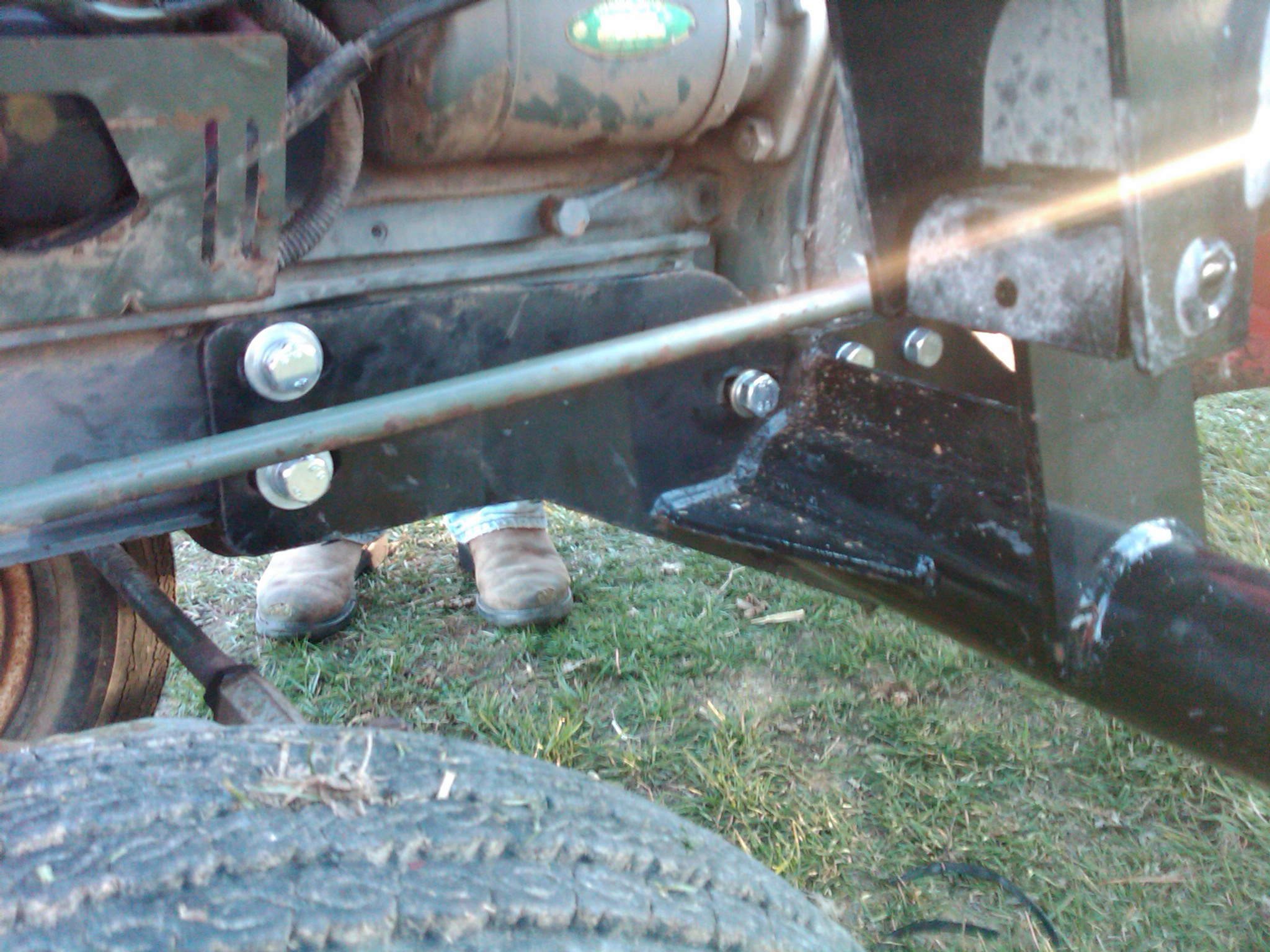

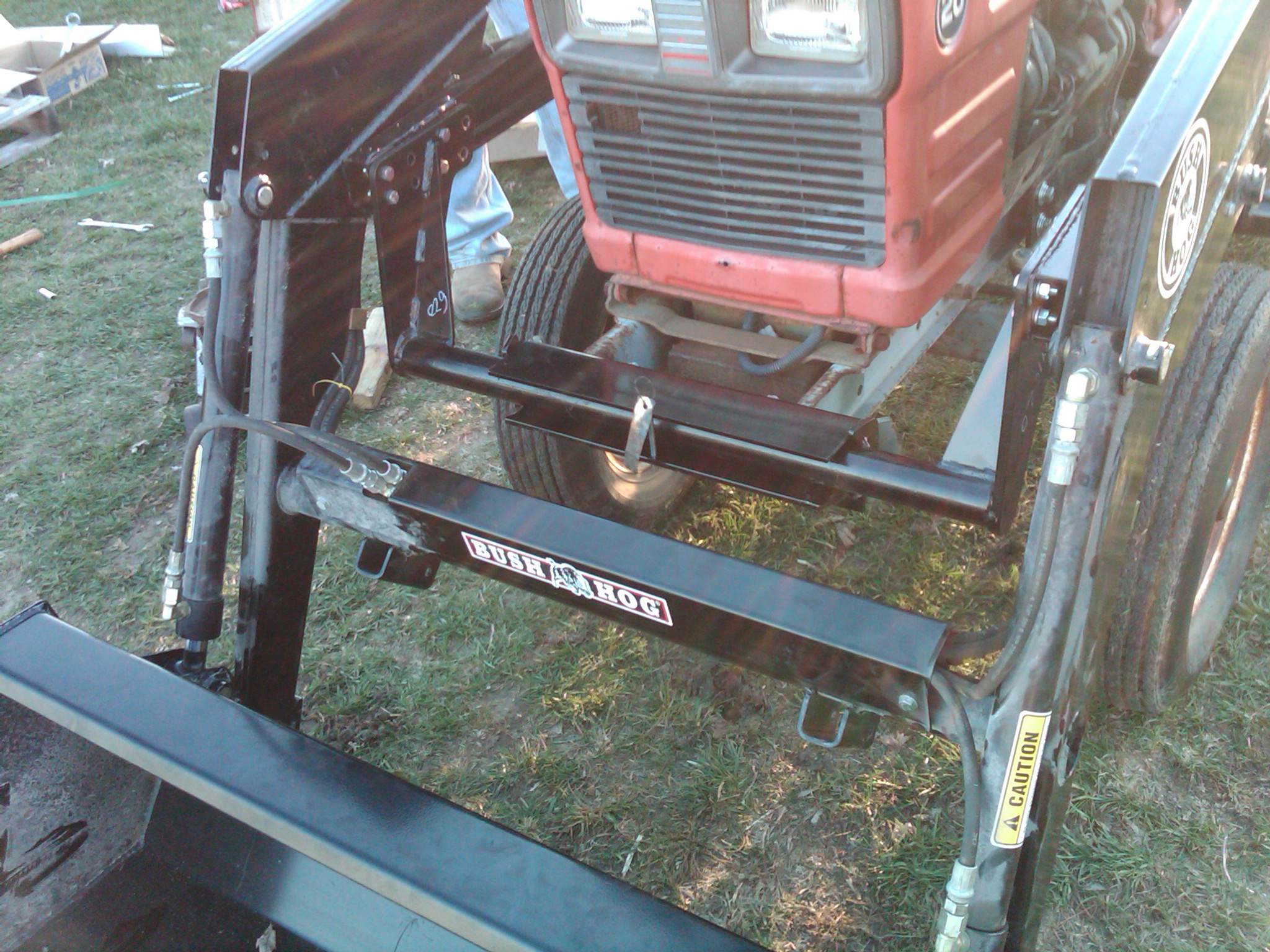

I picked up a Bush Hog 1846QT loader for my YM2002. When any one says "it bolts right on" - they lie. :D
Some of the bolts that go into the bell housing were about 10mm too long, or more specifically, my holes weren't tapped deep enough.
Just picked up some smaller bolts for a couple places. Got the left and right brackets on, and the plate underneath, but they aren't attached to each other yet. I will take come pictures tomorrow and post them.
Going to get the loader on, and then decide where to cut my high pressure line and put compression fittings on. A lot more work than I originally anticipated, but will be worth it. :)
I just have to figure out where to buy compression fittings for hydraulics that will fit that line. (btw - anyone know about what pressure my pump puts out? around 1800psi?)

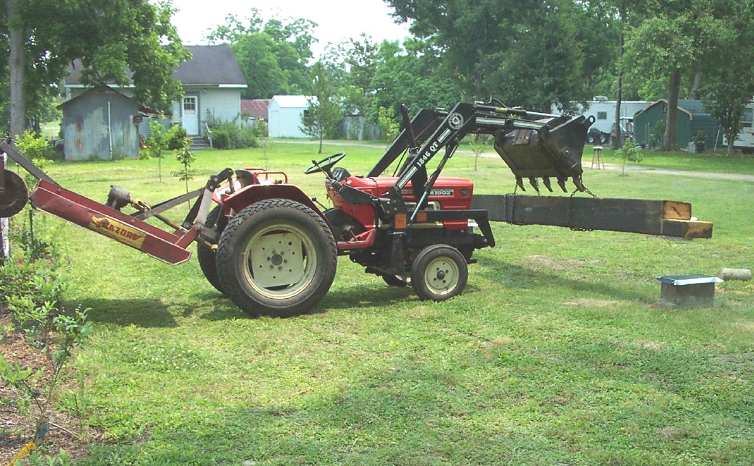

I have a Bush Hog 1846QT on my YM1802 and I love it. It is so powerful that it can be very unsafe so it must be used cautiously. It can flip your tractor over in a second if you try to lift something too heavy so a ROPS is definitely recommended.
If I try to lift too heavy an object and have it centered properly it will lift my rear wheels off the ground even when I have my rotary cutter on back. If it is not centered, it will lift up one side and flip it quick if you don't let off.
After Katrina I carried many heavy stumps away that a much larger tractor couldn't lift and I know that I vastly exceeded the load ratings on my tires and front end.

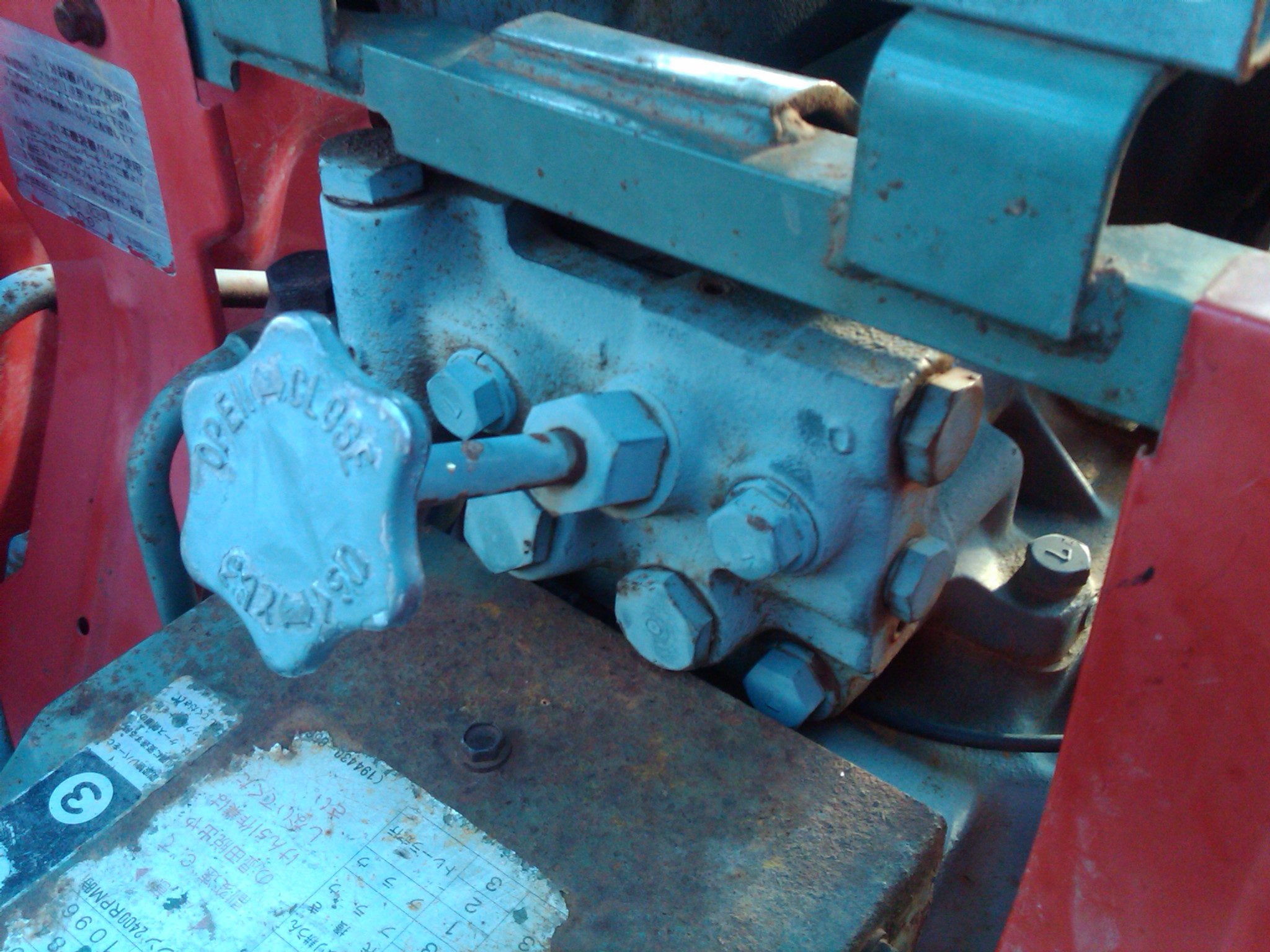

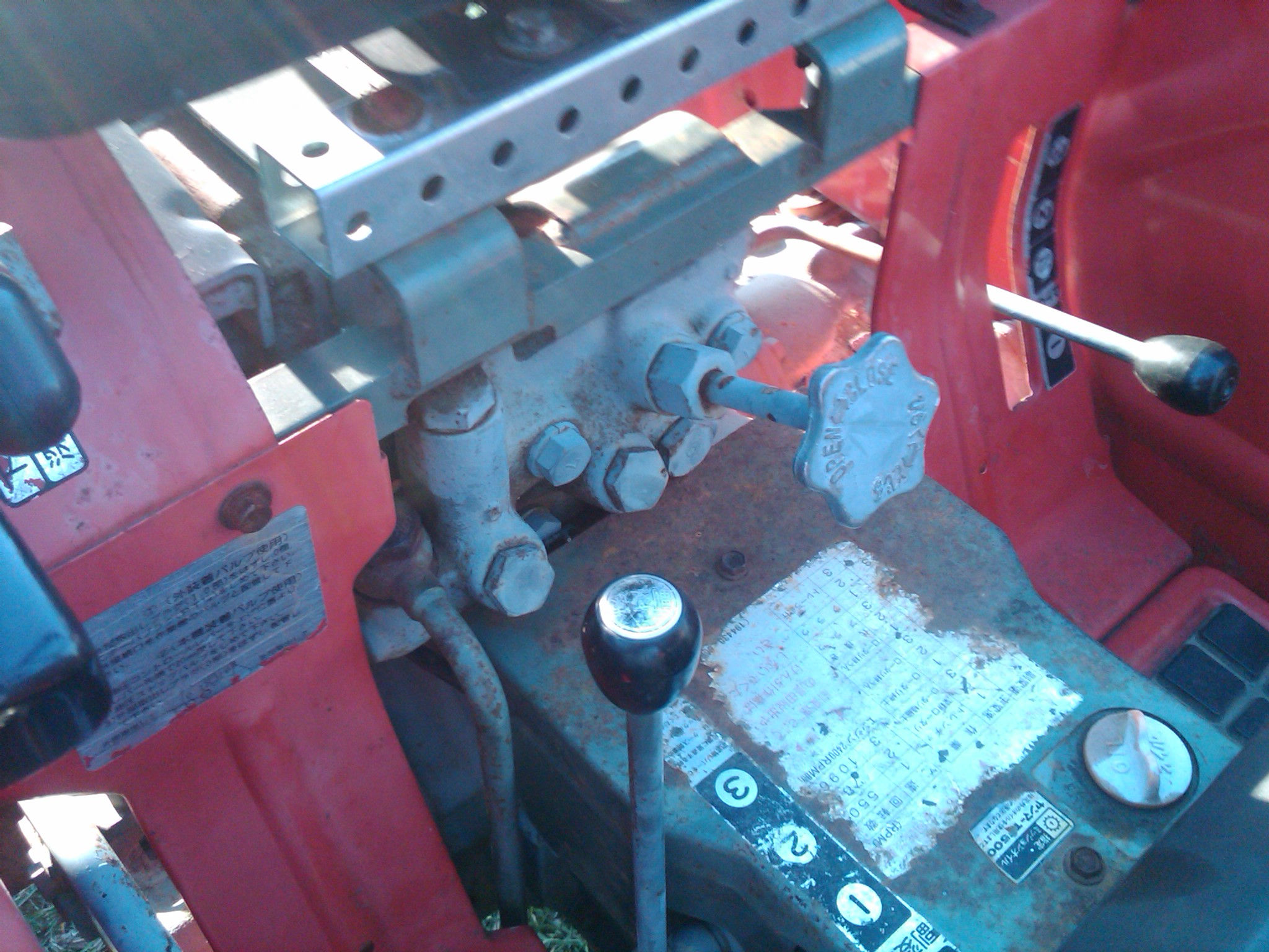

Thanks all! Got it all mounted minus Hydraulics today. Measured and my pressure line is 12mm. Going to pick up some compression fittings and see where the best place to squeeze them in will be.
BTW - I have some ports on my sump area I was curios about - two are labeled with an "o". All have bolts in them now, but was wondering if any are for adding hydraulics without cutting anything???
See pics - one of the ports in question is just to the right of the pressure line (left side of 1st pic) The other one is around the right side. (2nd pic)

Your bucket doesn't have the 2 hooks on the top that mine has. I thought they were original but I guess someone put them on.
Are those regular 12" car tires on the front? I was thinking about putting them on mine so I don't rut the yard as much.

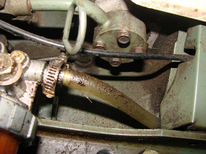

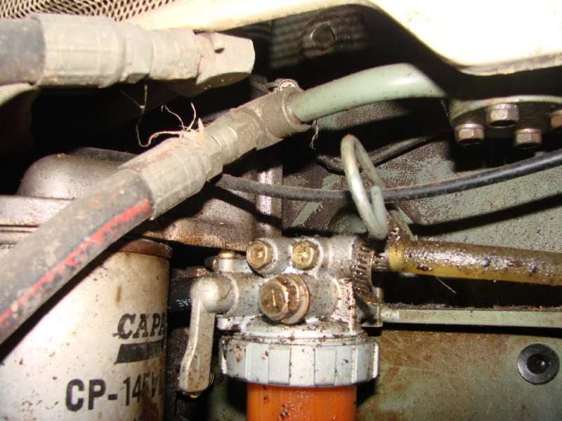

TallyHo8 - Any chance you could post pics tonight of where your high pressure line is tapped?
I purchasing fittings tomorrow and going to cut the line - couple places might work, but since ours are about the same, thought they would help!
Thanks!:)
/ YM2002 Bush Hog Loader install #11

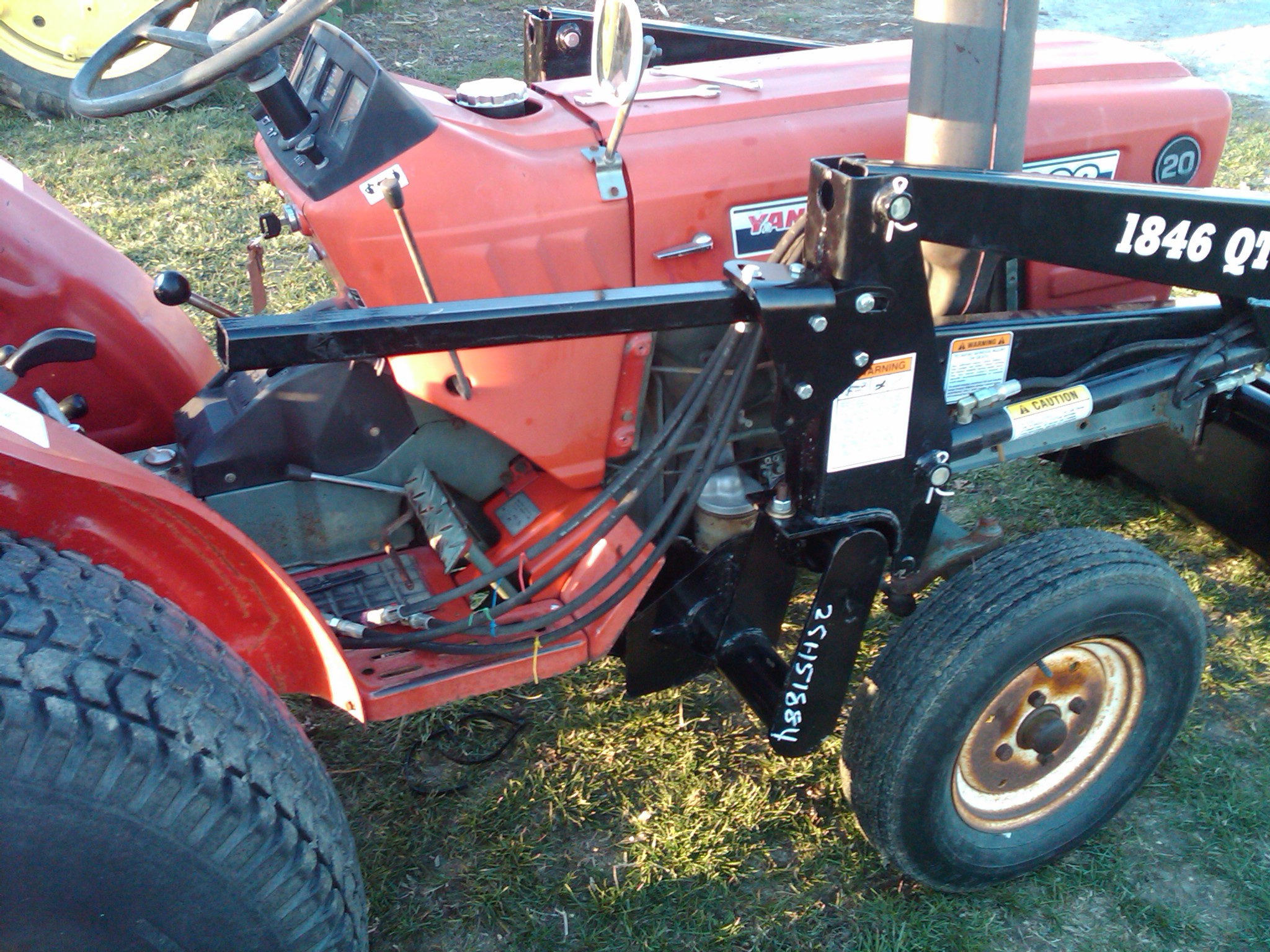

I got in late tonight and it was raining but I went out to the barn to get the best photos I could get without taking anything apart. I don't know if these will help you any but these show the 2 hoses coming from the fel and the only connection I was able to photo. I would have to look at it in the light to see if I had to dismantle it to get a photo of the other connection.

Thanks! Those actually help. I was planning on doing a compression fitting right about there for the pressure feed. Compression fitting to a 45* out, and on the return side, I am planning on doing a compression fitting right by my right foot where the line goes straight down. Then just run hose in a sleeve under the tractor instead of the steel line.
I was questioning the room up by the front though, so the pics help a lot!

Well it's on, and all the hoses are there.. Everything is greased, and everything works! Dumping is a little slower than I thought, but not too bad really.
I will get some pics later - just finished up!

Well, I finally have more pics. Up front, where the high pressure line is attached, I rotated the fitting 90* so the pipe was pointing out, and then put a 45* fitting on to get it where I wanted. On the back side, there is a 90* fitting.
