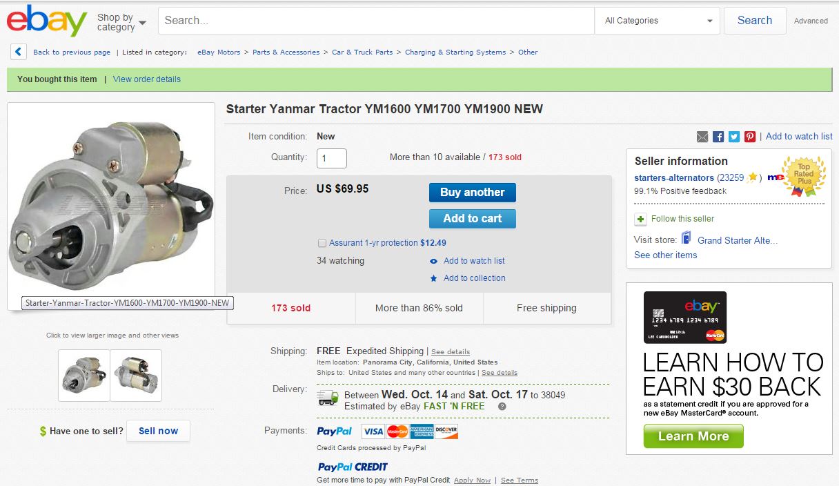

I ordered a new started from Starters-Alternators in Panorama, CA through E-Bay which said it would fit a Yanmar YM2000. When I received the starter it had 12 teeth for the flywheel whereas the old one on the tractor had fifteen teeth.
I called the company and the guy insisted the 12 tooth would work fine without any damage to the tractor. Does anyone have any information on this.

The ratio would be wrong.
/ YM2000 Starter Question #4
Maybe the 12 tooth will work properly. Compare the size (diameter and circumference) of the starter gear of the OEM and the aftermarket. As long as the spacing and pitch is the same, all should be fine. For any given flywheel, a larger starter gear would obviously have more teeth than a smaller one, but the spacing and pitch can be the same. However, if in doubt, just send it back.

It would be a nightmare to split the tractor and remove the flywheel to have a new ring gear pressed on. And where would you find the ring gear?
I wouldn't make this gamble, myself. Not worth it.

To second California: Why start a situation with materials you KNOW are wrong for the job? Hoye sells an expensive, correct, lifetime starter for this tractor. They also sell the best-option gear-reduction Chinese starter: Yanmar Tractor Parts GEAR REDUCTION STARTER - NEW!
The pictures up on ebay of the Yanmar starters, including what you bought, are all different than Hoye's image. At least one of the non-Hoye gear-drive starters fits and meshes properly (as best I can tell) on a YM2000 I have, but installing it (by the previous owner) required hacking up the wiring harness so the non-OEM connections on the starter could be used.
This is essentially, in my mind, an assessment of personal values: These tractors are lifetime purchases for the casual user, much like a firearm or hand tool. That is, with appropriate maintenance, they will last your lifetime and then some. Spending some small amount of extra money (comparatively) to correctly and properly put it back to the condition it should be in, with lifetime-quality components, ensures it will continue to be correctly operable for another 30 years or more.
Conversely, a few hundred dollars (at most) less puts the machine back in service, for an indeterminate period of time. It may last 40 years. It may go 3. If one is looking to get it back into service for the bare minimum of cash outlay, do the cheapest starter that properly fits. There isn't a right answer; it's an assessment of values. It's your equipment, obviously you're free to do whatever you like with it. But if it were going into an application where lives might depend on it, or best practices are desired, the old-school "Hergestellt im Deutschland" starter is likely optimal. If treated as a semi-consumable, as, say, tires might be, the correct gear reduction starter is an equally valid choice. Putting objectively wrong gears together is never a good idea.

I recently made a starter purchase from the same company on ebay in which you are talking about, and when I first opened the box to visually inspect the new starter from Starters-Alternators, I had my doubts that this YM1700 would work properly on my YM2000 as well, slapped it on, connected wires and BOOM!!! Perfection!! no troubles whatsoever....NO GRINDING, NO BINDING, NO STRAIN, WORKS GREAT, PERFECTION!!!!!
W/1 YEAR WARRANTY, NO CORE CHARGE, SUPER FAST SHIPPING, AND IT DIDNT HURT MY WALLET!!!!!
I HIGHLY RECOMMEND these guys http://stores.ebay.com/grandstarteralternator/

Does it have the same number of teeth on the bendix? I know that has been a concern and a problem with some replacements that have been discussed here?
