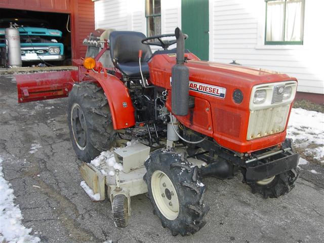

Thanks for the compliments ! The tractor was allegedly owned by a guy who only used it to mow the lawn at his summer camp, which explains the mere 225 hours on it. I know it rolls over at a thousand, and may be 1225.... but judging by the condition and the fact that it has sat out in the rear lot of the dealer for nearly two years.... i think the 225 hours is legit. I'm confident most of the slight fading of the paint happened while it sat outside at the Deere dealer. I was pretty happy with the deal i got on it. We are supposed to get some snow here in NH today, so i went out and bought an inexpensive blade for the back. It was too wide so i lopped almost a foot off of either side. Of course... only because my mid mount blower looks like it will only handle a few inches.

Ductape
The picture of your 186D makes it look high in the front. Is that just the picture? By any chance have the tires been changed? I think the fronts should be 6.00X12 and the rears 9.50X16
Chris

"so i went out and bought an inexpensive blade for the back. It was too wide so i lopped almost a foot off of either side. Of course... only because my mid mount blower looks like it will only handle a few inches."
Are you saying you lopped a foot off either side of the blade in the picture? I don't understand the comment about the blower, but the blade should be considerably, about 1 foot each side, wider than the tractor so it will still cover your tracks when you angle it.
