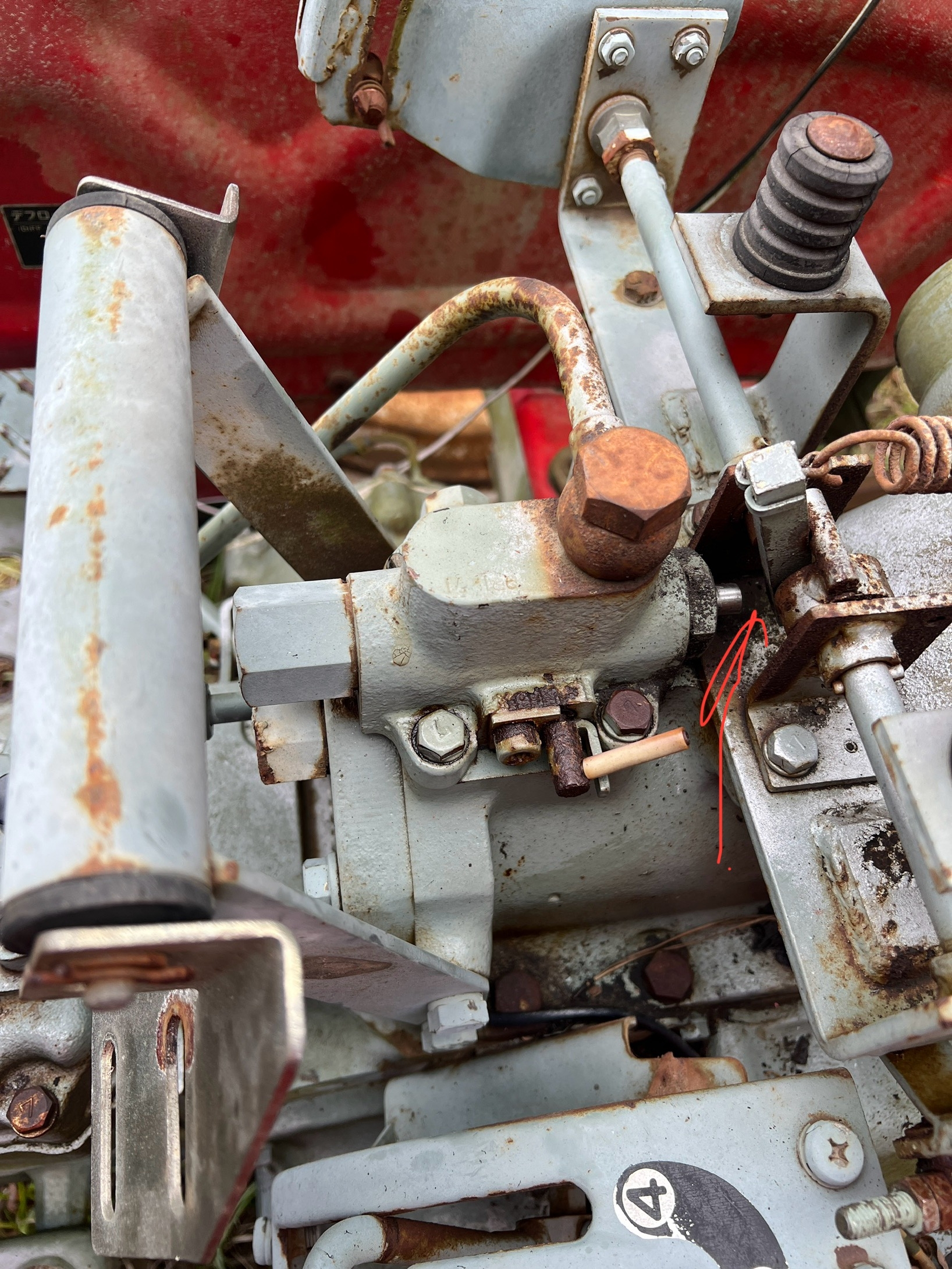

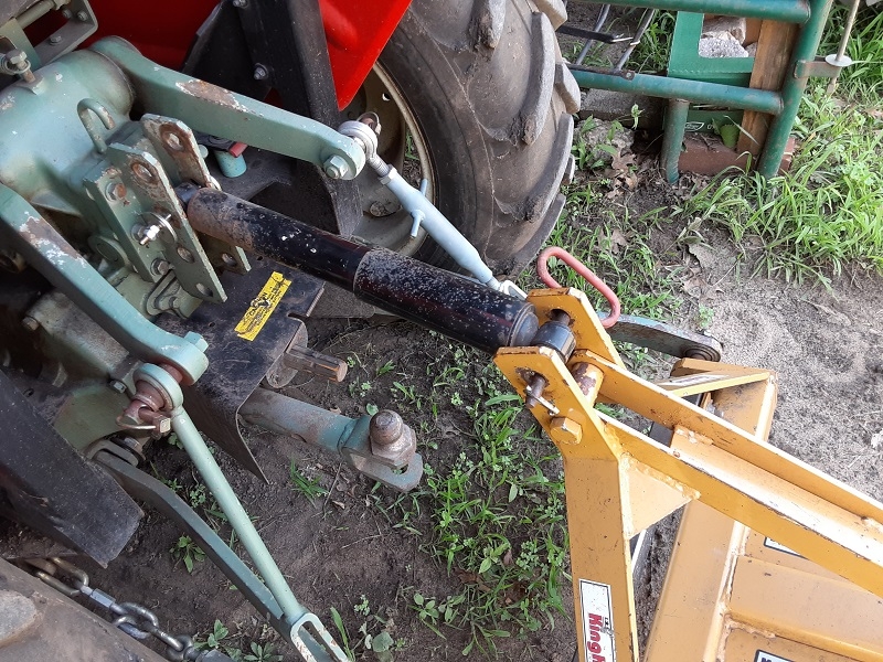

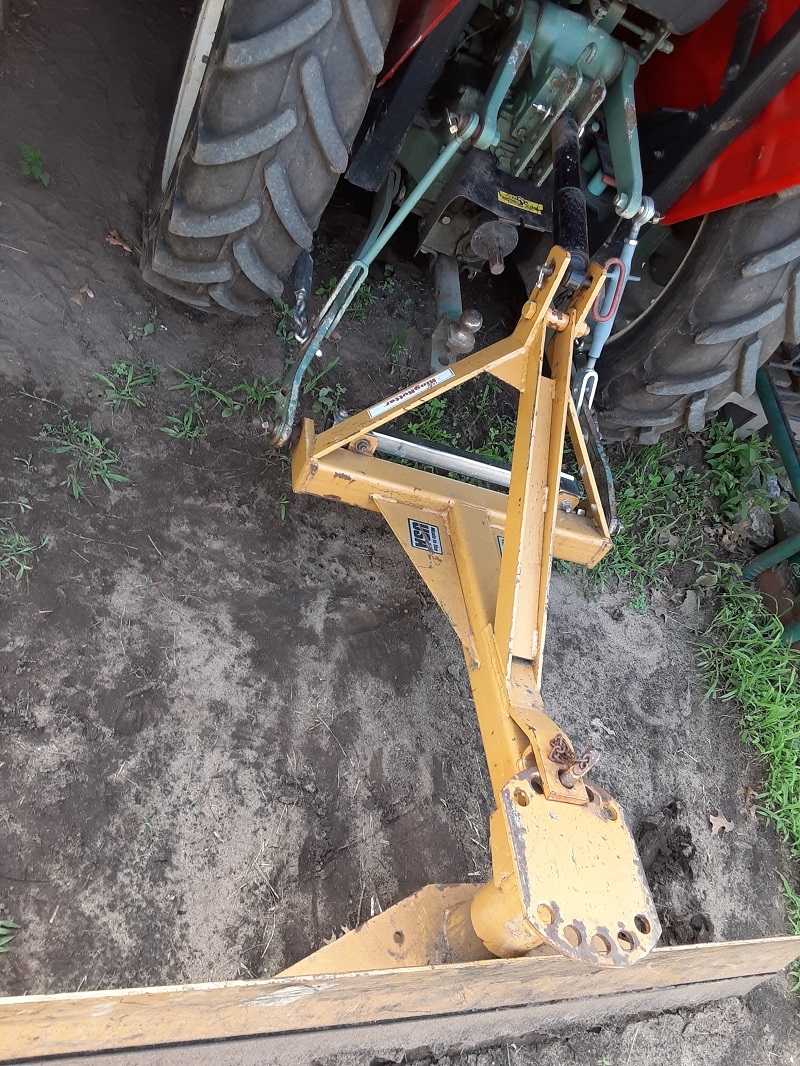

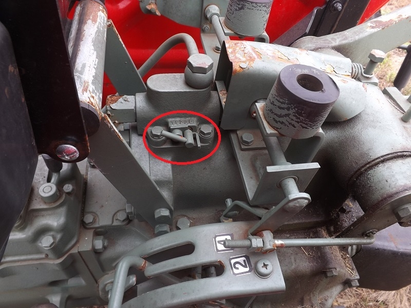

your Yanmar YM2610 three-point hitch won't lower, the first thing to check is the lockout valve (usually located between your knees, under the seat). Ensure it's open. If that's not the issue, inspect the linkages between the valve and the handle for any damage or looseness. Additionally, check the hydraulic fluid level and for blockages in the hydraulic system
