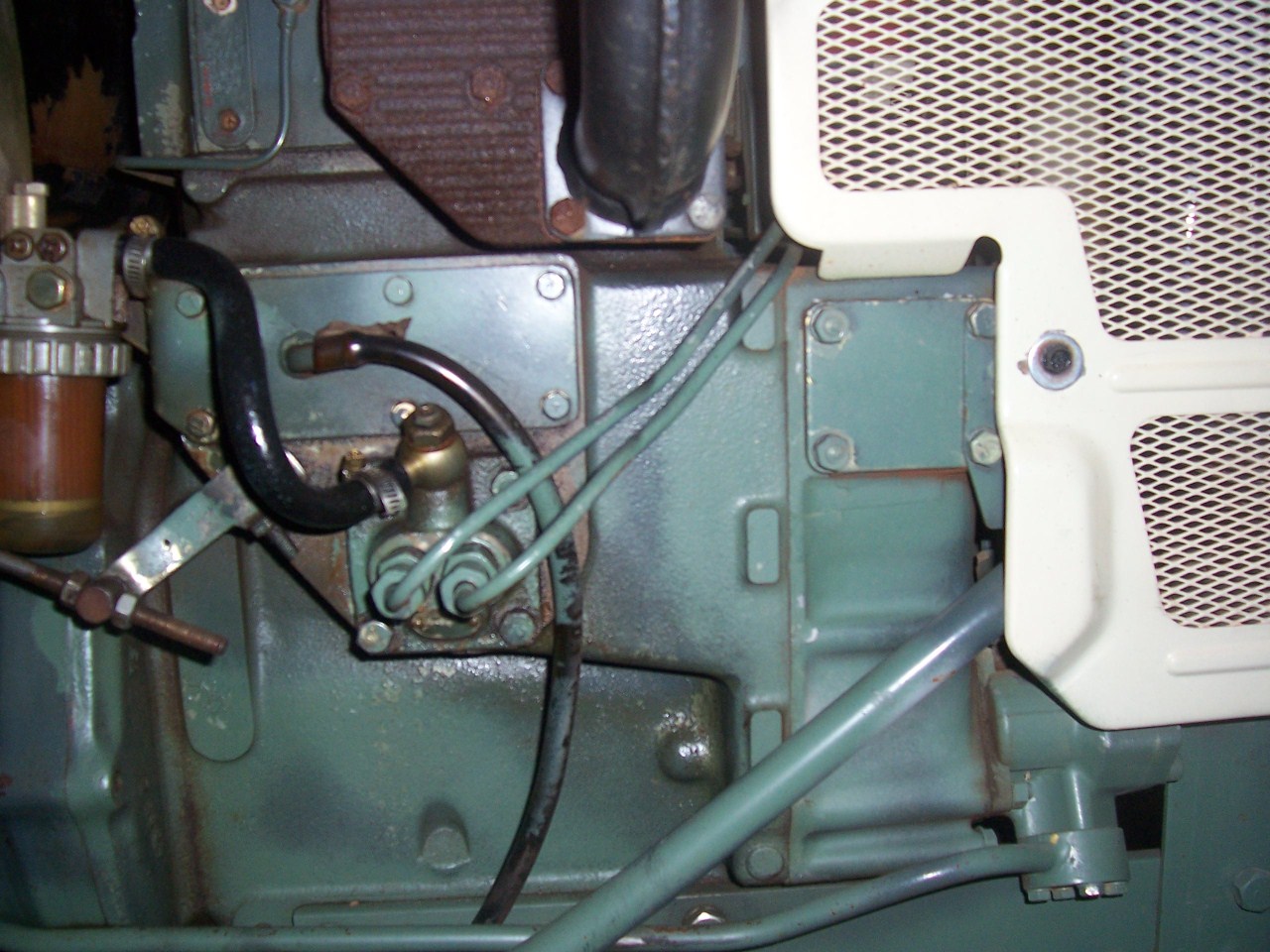

There's an idea ! You could be the 1st To make a you tube vid. ! :D I have never had nuch trouble getting the air out after a fuel filter change. I open the bleed screws at the filter & watch the fuel fill to the top of the filter cup. cranks right up every time. ,ve never had to bleed anywhere else

but the time I changed mine I had not a bit of trouble? Im wondering if you did it wrong the first time would it be hard to get the last bit of air out the second time/?

I,m gust guessing. If the air makes it's way to the pump.It's going to be difficult to get it out. I'm in the A/C business and relate it to the air getting into the hydronic system. When air gets in the hyd. pump .It seems to take forever to get it out

On Bleeding your Fuel I've done it a couple of times. But only when I changed my Filter. Once I've done the filter I clean and filled theFuel Bowl And then I bleed my Sys. or Lines. Starting at the Pump. and back to the Two on Top of the Filter/Fuel Valve. I haven't read all the reply's. Was on the 5103 Yesterday and I'm feelin like Old Uncle Joe " movin kind of slow" Today :confused2: There a fuel O-Ring that should be on the Fuel Bowl. If you go through it again check that it's there. For me the piece of mind and a couple bucks I replaced it if any doubt ...
