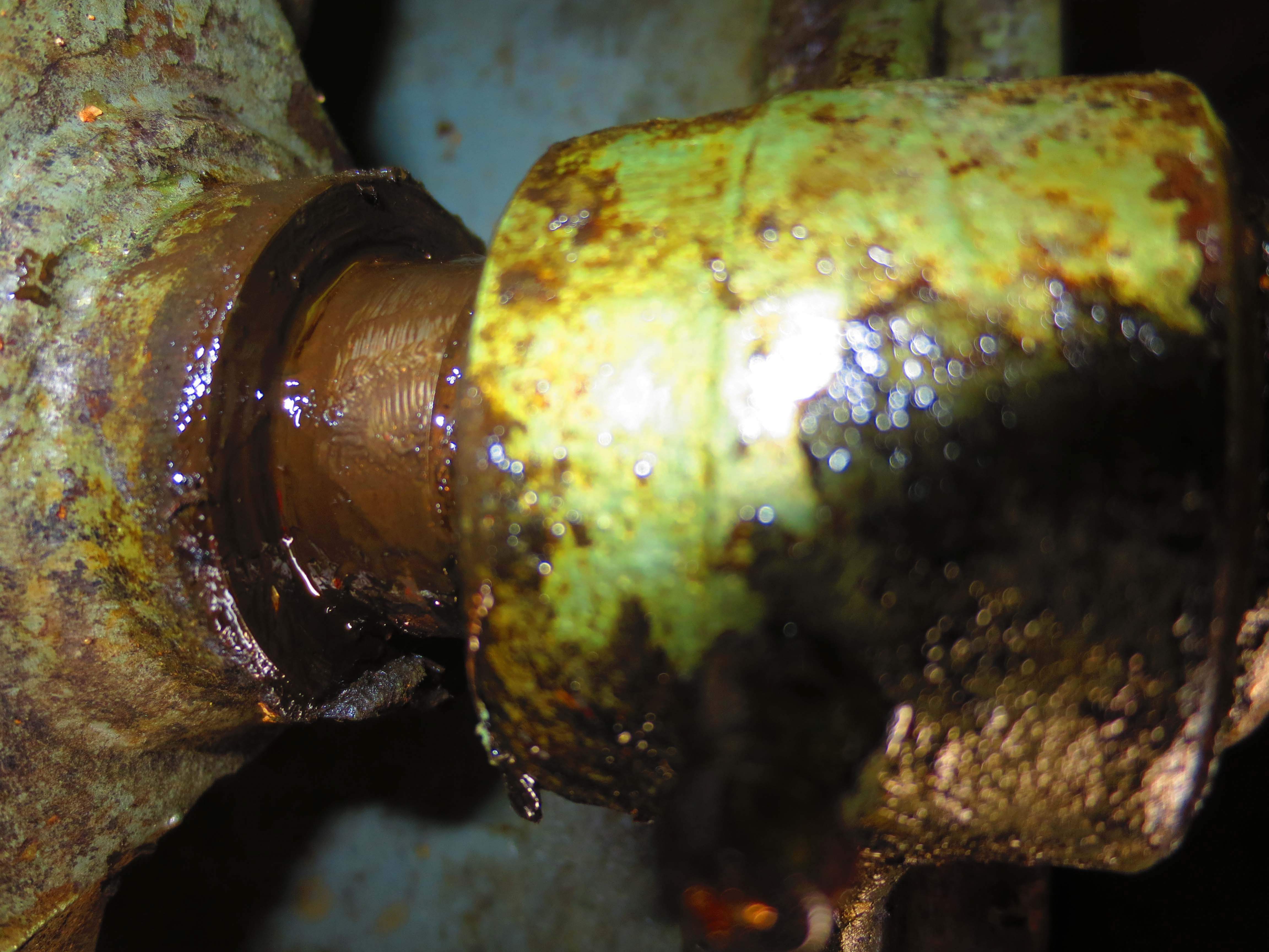

I have a problem with my front axle. I replaced the steering wheel gear box which certainly needed it when my steering wheel basically would just spin. After replacement, I noticed that my front axle would shift forward when I turned in either direction. After inspection, I noticed that I could literally pull my axle forward about an inch and a half and could visualize about a 1/1/2 inch section of my axle pin. I purchased two new center pin supports that include new bushings and grease fitting s thinking this may be the issue but I have not replaced them as of yet. As a shade tree mechanic I was just looking for some thoughts on my issue and making sure I am on the right track. Any advice is greatly appreciated.

I will send some pics shortly... Basically, there is a pin that runs through two housing. At present, the axle moves freely (about 1 1/2 inches) front to back on the pin....

The two housings are to far apart. There can't possibly be that much wear.

The pitman arm has nothing to do with your problem. The two housings that hold the bushings are to far apart. There is a cross member under the frame those housing bolt into. For some reason the housings are to far apart. Getting under and looking out there should reveal why. Just because of the 1-1/2".

Well that is good news. I looked under there and just cannot figure out why the separation. Hoye suggested I loosen the bolt, pull the housings back together, and tighten everything down for a possible solution....

Might work, can't tell from here. :thumbsup:

I guess it certainly could be but from the parts I have removed it doesn't appear that way. Is there anyway I could tell for sure?
