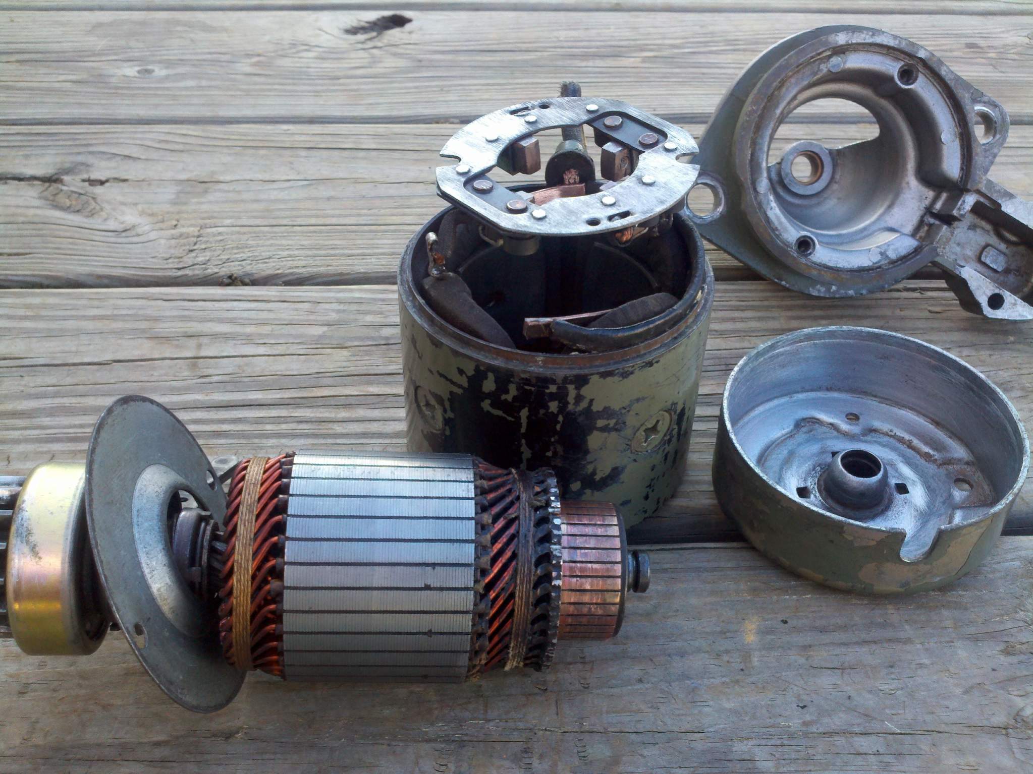

Sorry to drag this on but we had several days of rain (About 14" worth!) from T.S. Lee....I got back to the starter thursday and took it to Autozone to test it to narrow bad down Starter/Solenoid or both?
Employee said " it failed the test....its locked up" interesting i can turn the gear and it spins freely? Not satisfied with that test I returned home and decided to take the starter completly apart to inspect for burnt/broken wires. No broken wires but It was Very dirty so I clean it really good and put it back on and it started like a NEW one! :) I tired it 5 or 6 times each time it cranked right up! That was yesterday......Today I went to crank it....faint click :mad: :mad: feel solenoid its very warm. starter is air temp not warm at all. recheck connections and voltage...all good.
I'm going to bite the bullet and buy a Solenoid I can get one at the parts store but it's a 65.00 gamble cause its only exchangable...Thanks all for the input and help on this. If anybody has any ideas/advice i'm all ears!! I'm attaching a photo of the starter AFTER i cleaned it...sorry i forgot to take picture before i cleaned it.... I will update results of solenoid..

Nice picture! Next time you have it off and apart....
Those copper strips on the end of the starter shaft must be clean --shiny clean-- and have no "wipe-overs" from one strip to the next. Some emery paper or fine sandpaper can clean the copper up nicely, but try not to remove too much material. A solvent may work well here, too. Same for the brushes- make sure they're not carboned over excessively.
A pick or something similar run between the strips can ensure that there's no bridge connection between them; if that happens, the starter may "lock up" and overheat due to a situation that's essentially like a short. Try not to remove the laquer insulation between the strips. IFIRC, I've used a popsicle stick for this in the past.
If you had a starter shop nearby, they could test the rotor to be certain that all the windings are still intact; if any of them are shorted or open, the starter's pretty much history. (You might want to check around for such a shop, to eliminate some trial & error.)
As far as the solenoid goes, if it pulls in OK when the elctromagnet's energized and the contacts that feed the starter are in good shape, there's not too much more to it, other than mechanical wear & sloppiness...
Have faith! I kept the original starter in my 72 Blazer (307 V-8) going for over 30 years with an occasional tear-down, clean-up and throwing a small glob of grease in the endbells for the rotor shaft....:thumbsup:

You need a starter armature tester called a "growler" to determine if its bad an automotive or truck shop may have one. It will be under a pile of dirt but we all used to have them until the throwaway days arrived.
Check around for a starter re-builder in your area let him check it before throwing parts at it you cant return. ;)
