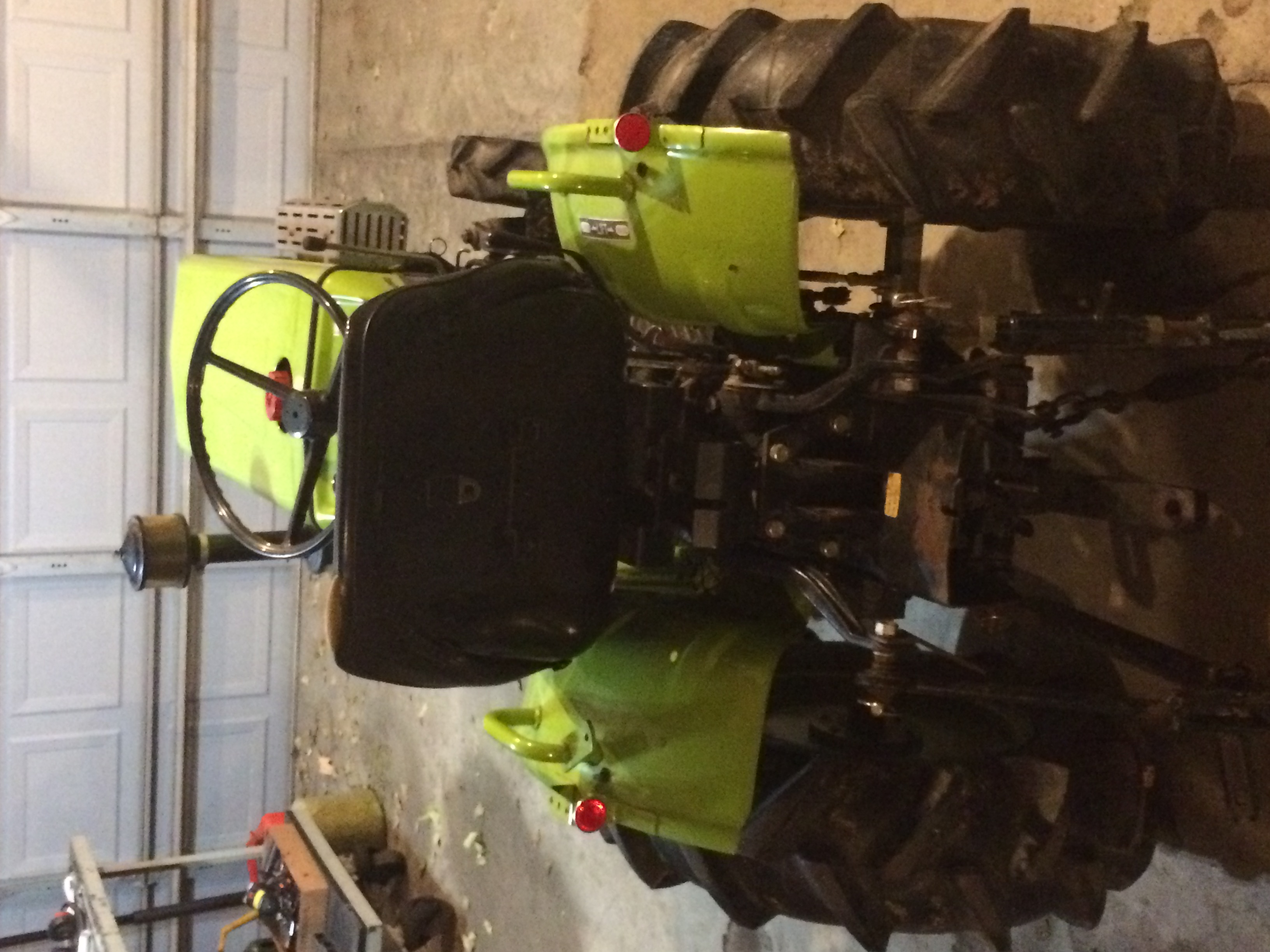

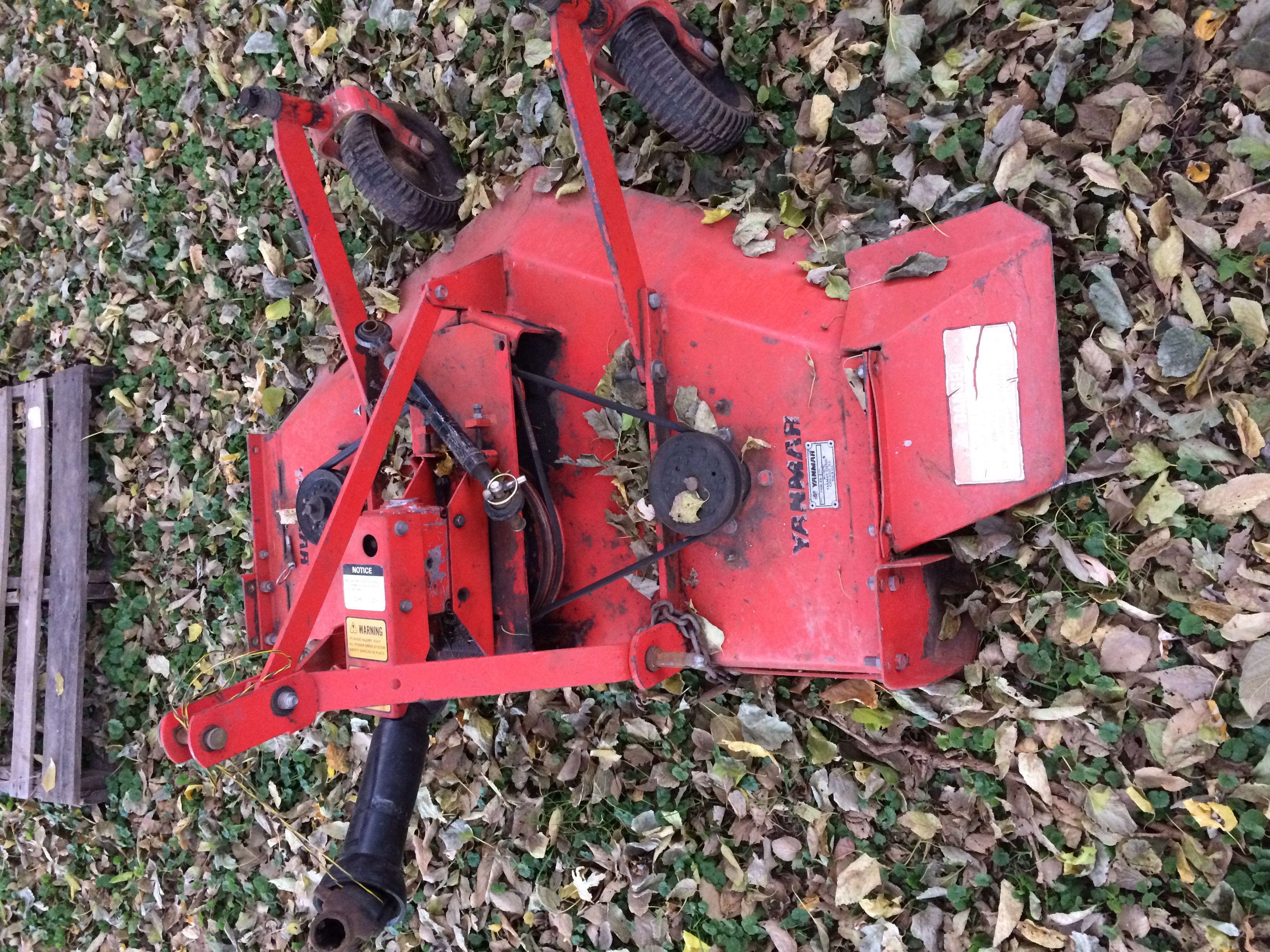

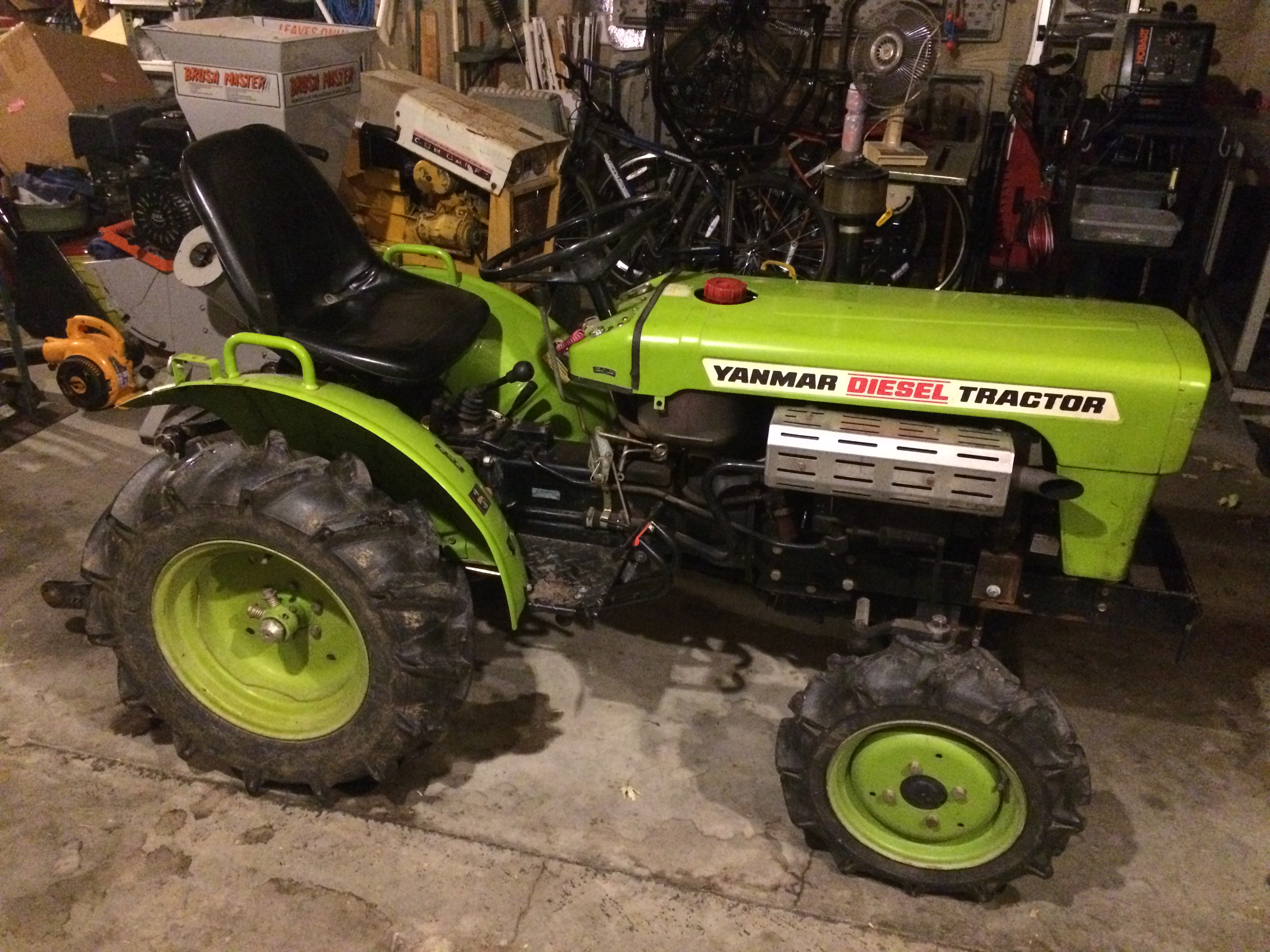

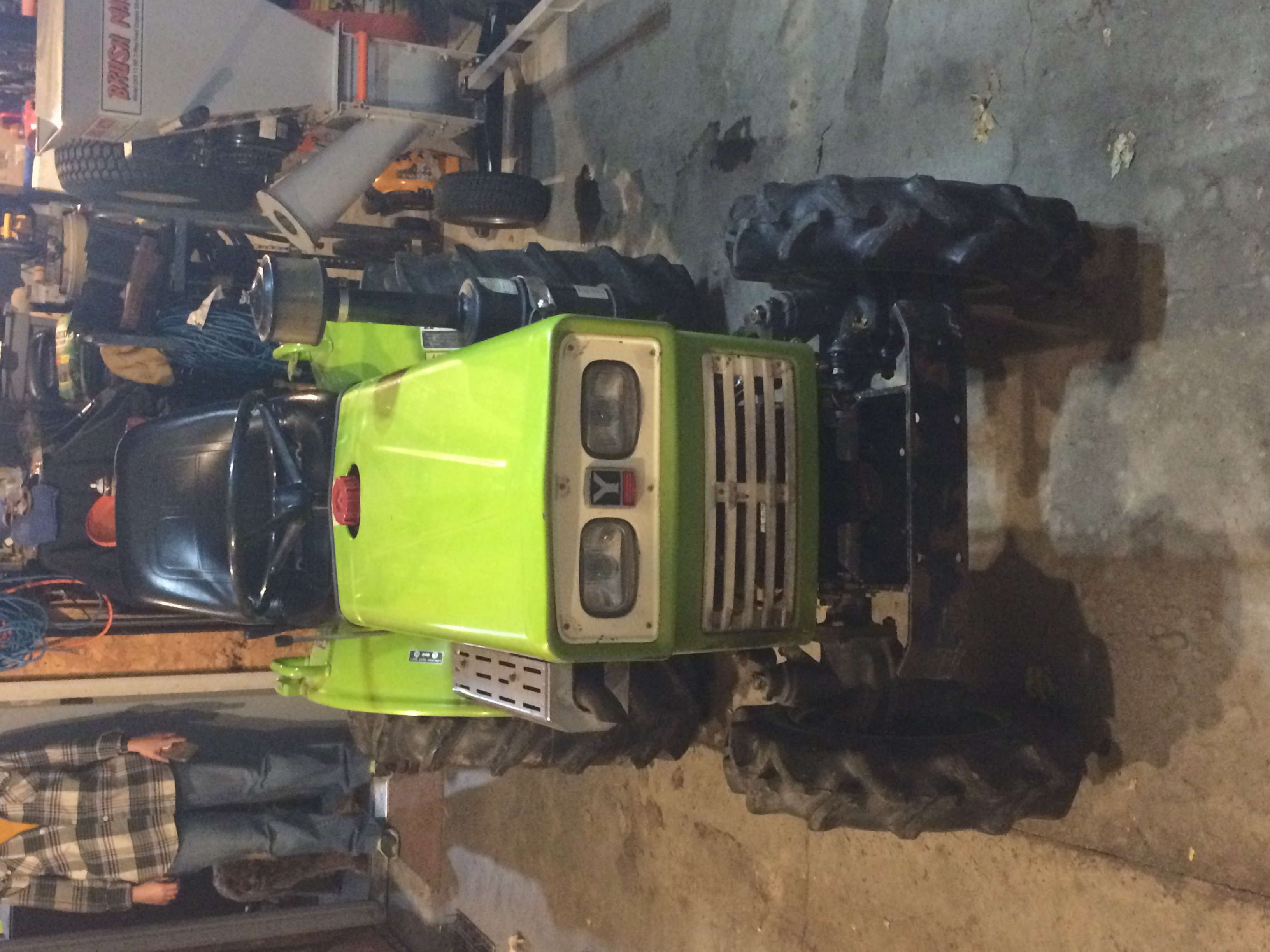

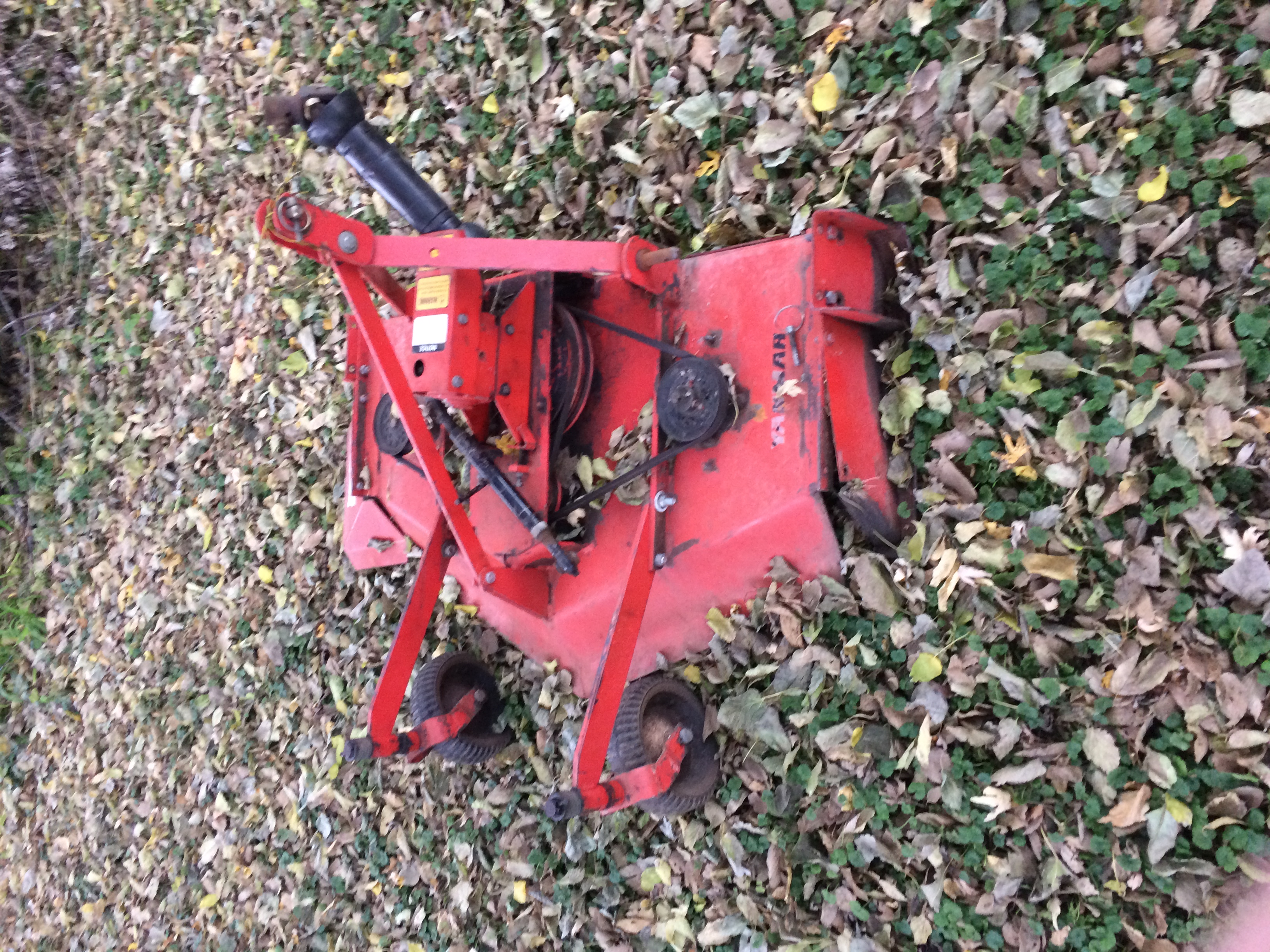

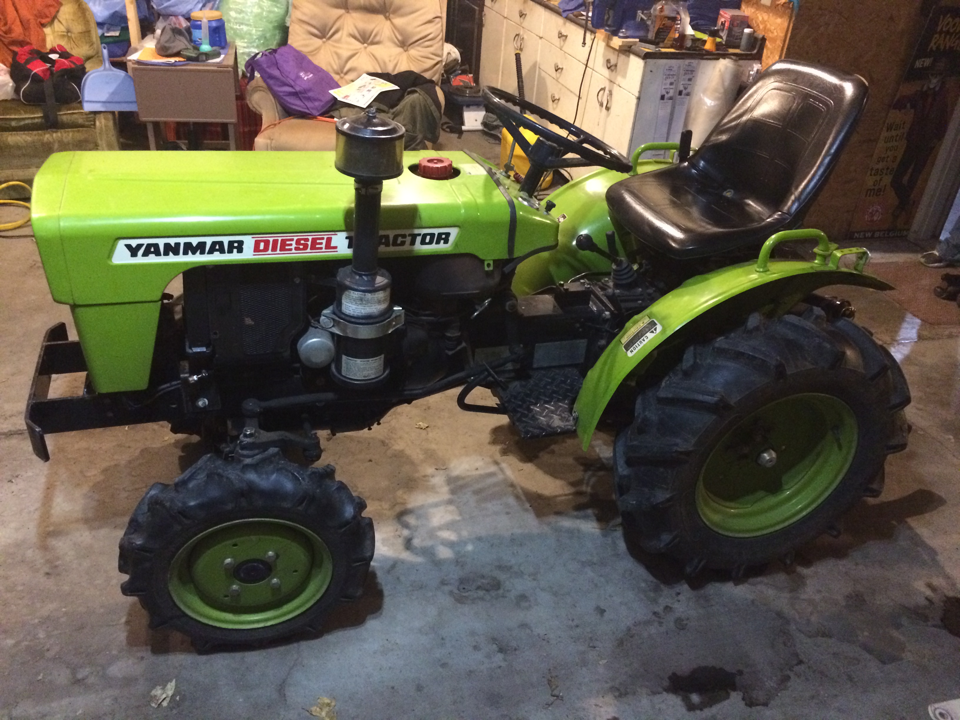

Sorry this took so long, but I had a busy weekend. Here are the pictures of my recent 155d purchase. I took the mover off the tractor for now so I an do some maintenance on the little guy first. Let me know your thoughts. View attachment 576650View attachment 576651View attachment 576652View attachment 576653View attachment 576654View attachment 576654View attachment 576655
Is that mower a rebranded Bush Hog brand. Looks very similar to an old one i have that im trying to get going at some point

I don't know if it is or not Clemsonfor. It does have a genuine Yanmar tag on the side plate with a serial number. Now that doesn't mean that Brush Hog didn't make it and put a Yanmar tag on it.

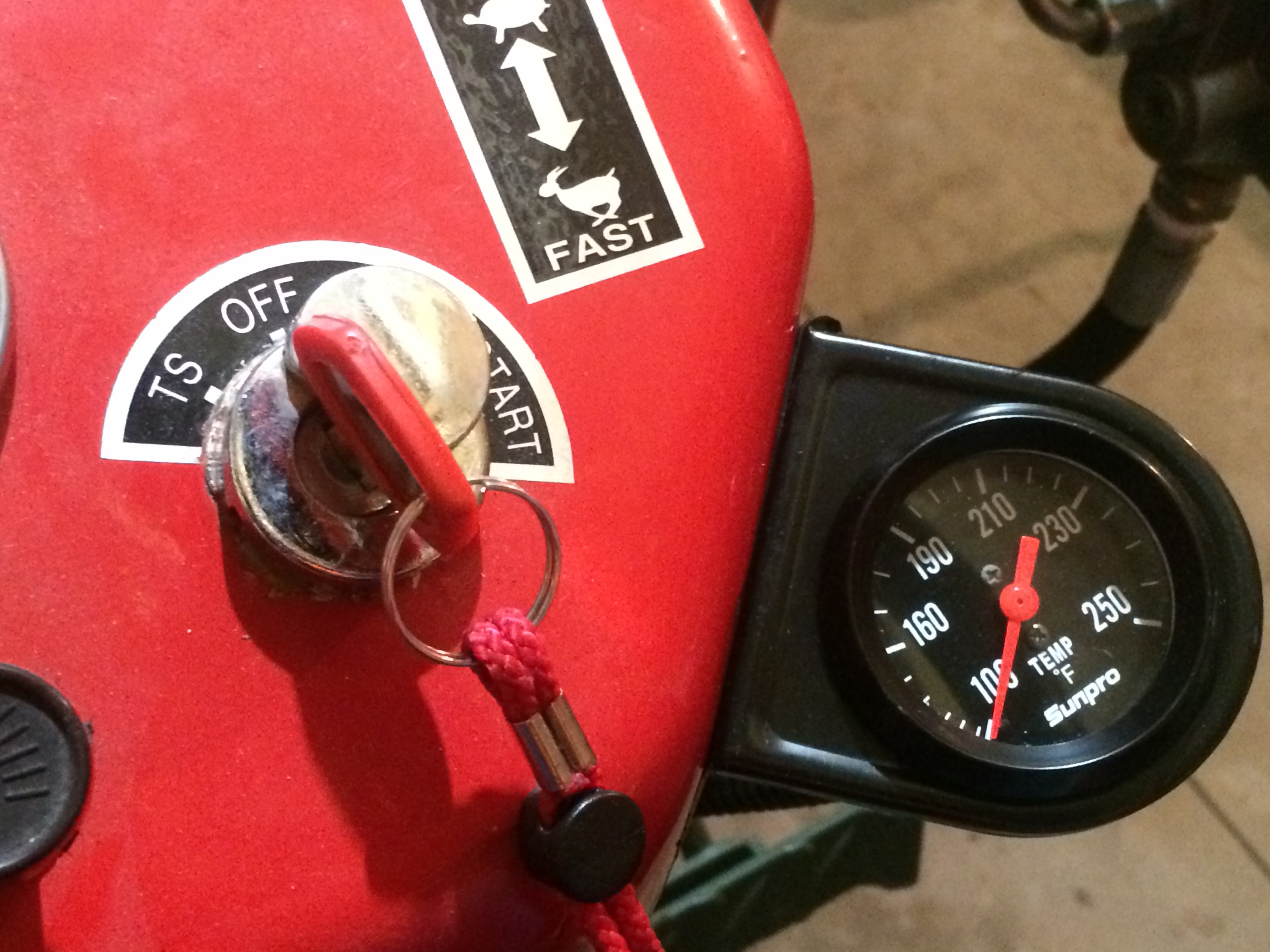

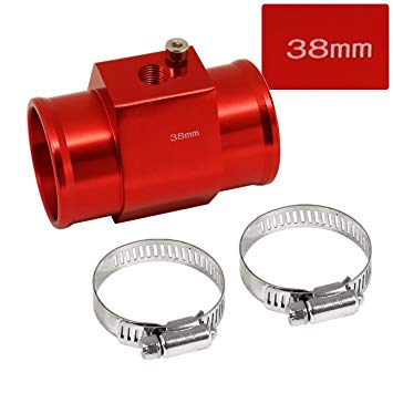

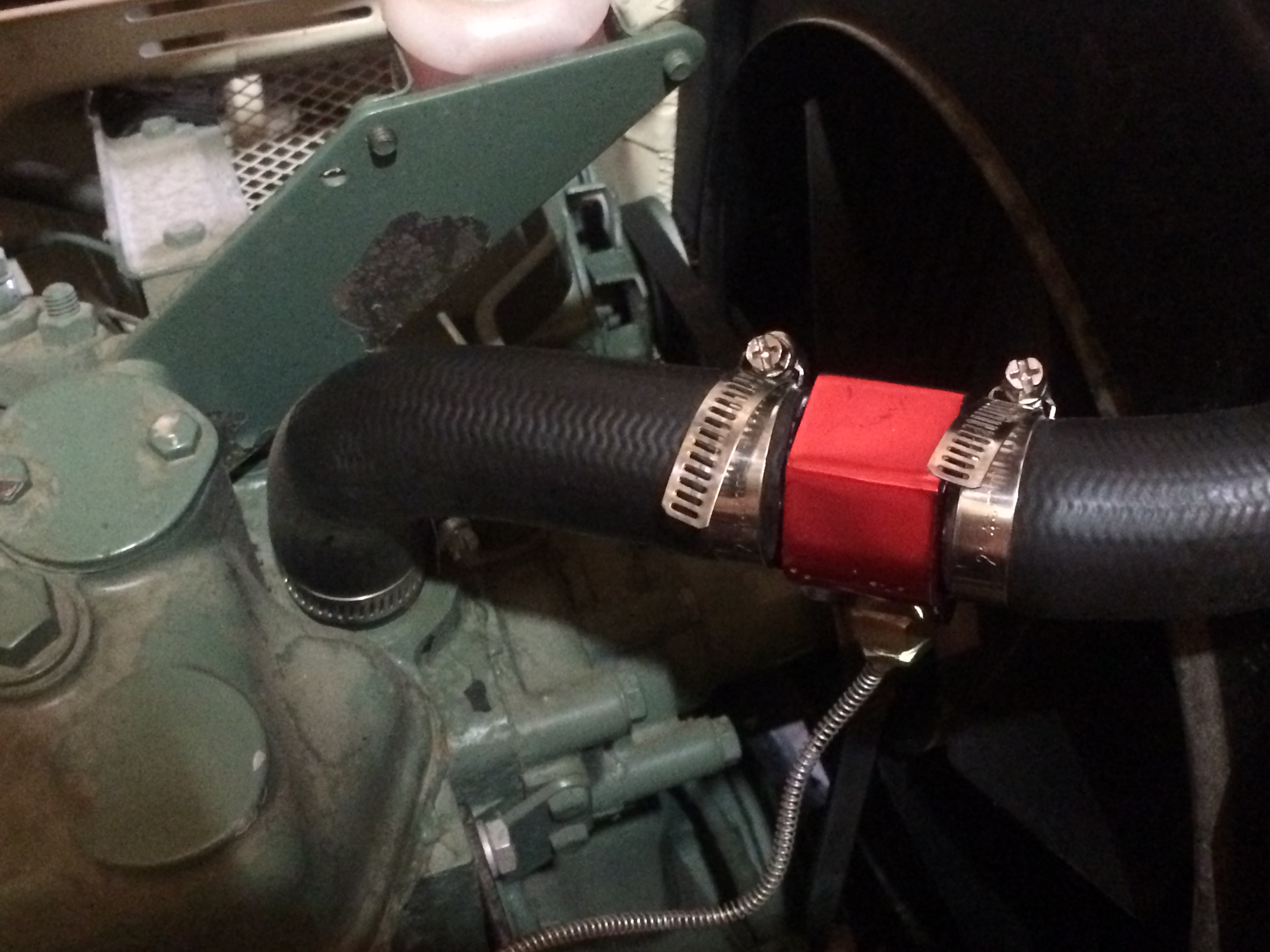

Thanks for all that great information rScotty. I guess I did not specify very well in my post. I do not plan on putting in an extra thermostat, I plan on using a temperature probe in the upper radiator hose as I did on my 2210d. See the pictures I have attached. The probe shouldn't restrict much flow if any at all, this way I have an actual gauge and keep the dummy light in place too. rScotty do you have printed information on the coolant mixture that I could refer to? I live in Nebraska and it gets hotter than **** here in the summer and colder that a witches tit in the winter so I will have to keep an eye on my ratio for sure since this is a therosiphon system. As for the block heater, I have not been able to find an actual Yanmar one, however chevy791979 did provide the JD part number for their tractors which also have the same Yanmar engine as mine would, well maybe not the exact one, but a Yanmar engine for sure. Also I did notice that Hoye also sells a block heater and I would like to think that he would have the correct threads for it, but I could be wrong. Let me know your thoughts on this. Also I am digging up information on the appropriate size 3PH snowblower for this thing. I am thinking a 50" is the biggest I would be able to go, only because that is the only size I can find around here. Temp probe.jpgTemp probe 2.JPGTemp probe 3.JPG

Thanks for all that great information rScotty. I guess I did not specify very well in my post. I do not plan on putting in an extra thermostat, I plan on using a temperature probe in the upper radiator hose as I did on my 2210d. See the pictures I have attached. The probe shouldn't restrict much flow if any at all, this way I have an actual gauge and keep the dummy light in place too. rScotty do you have printed information on the coolant mixture that I could refer to? I live in Nebraska and it gets hotter than **** here in the summer and colder that a witches tit in the winter so I will have to keep an eye on my ratio for sure since this is a therosiphon system. As for the block heater, I have not been able to find an actual Yanmar one, however chevy791979 did provide the JD part number for their tractors which also have the same Yanmar engine as mine would, well maybe not the exact one, but a Yanmar engine for sure. Also I did notice that Hoye also sells a block heater and I would like to think that he would have the correct threads for it, but I could be wrong. Let me know your thoughts on this. Also I am digging up information on the appropriate size 3PH snowblower for this thing. I am thinking a 50" is the biggest I would be able to go, only because that is the only size I can find around here.View attachment 577026
Yanmar printed a number of technical bulletins about ethylene glycol mixtures for their thermosiphon systems. They all say about the same thing, but as time went on they tried to make their mixture recommendations more "user friendly" and less technical. I've attached here a printed copy that has what I consider to be the best info.
I don't know what to expect from your radiator hose temperature probe in a thermosiphon system. Let us know how it works.
My guess - and it is just a guess - is that it would read a couple of degrees higher than a measurement made at the location of the block sensor that Yanmar used for their idiot light. Water pump systems circulate the water a lot faster than the thermosiphon so you can expect your temperature probe to show a bit differently on the YM155 from the 2210d. At least I'm assuming that the 2210d has a water pump .... I don't know the gray market Yanmars as well as I know the US models.

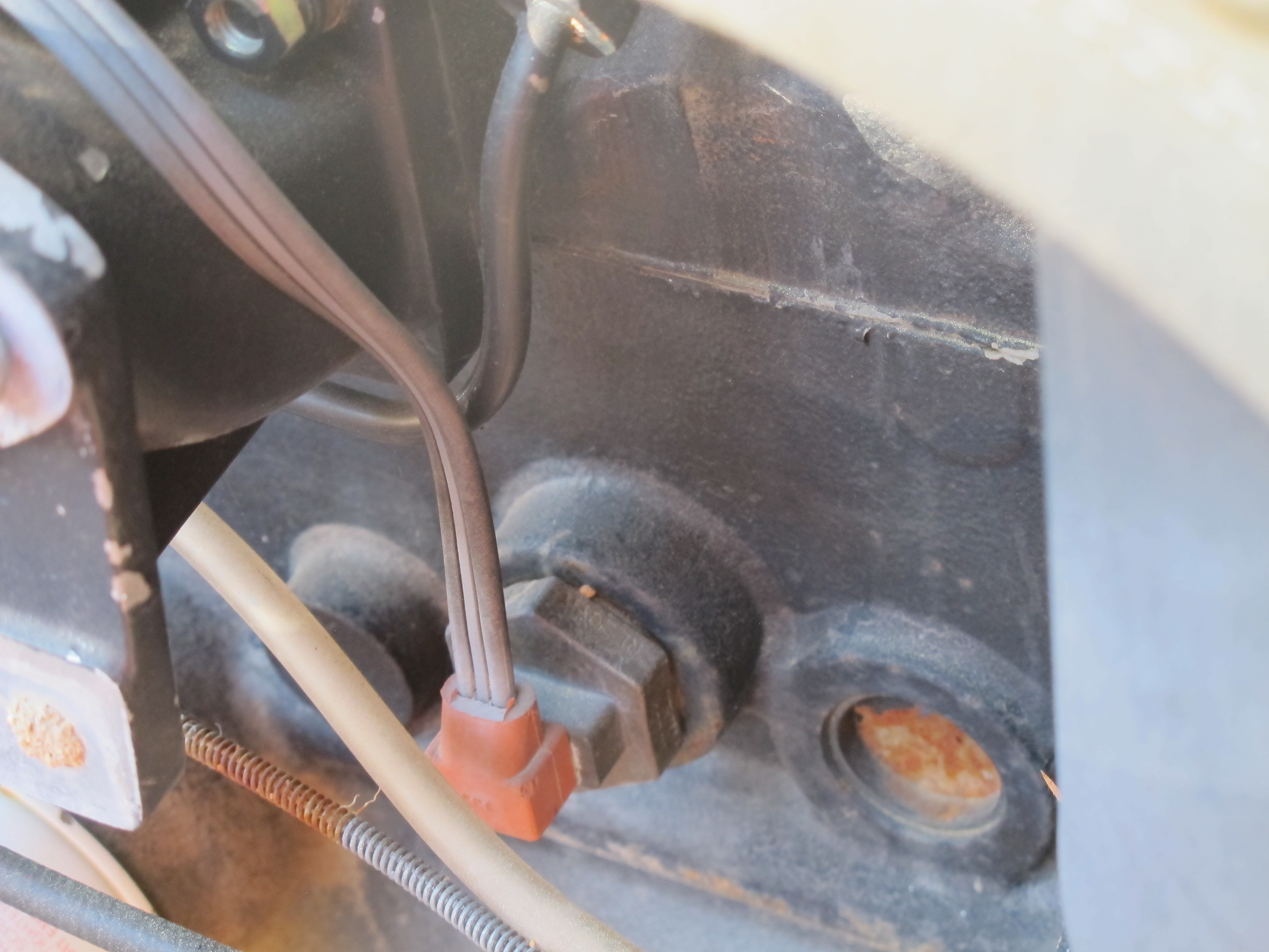

On my YM165 (same engine as the YM155) I replaced the on/off idiot light sensor in the block with a regular analogue temperature sender and gauge.
Here is also a photo of the analogue sensor. The sensor required an thread adapter to go from the
BTP tapered pipe threads in the Yanmar block to our NPT thread.

The 2210d does have a water pump and I would agree with you on the fact that the temp probe for my 155d would read higher if I would install it as described. I could just remove the dummy light sensor and put probe in like you did your YM165. Do you happen to have the thread adapter size that you used for your temp sensor?
