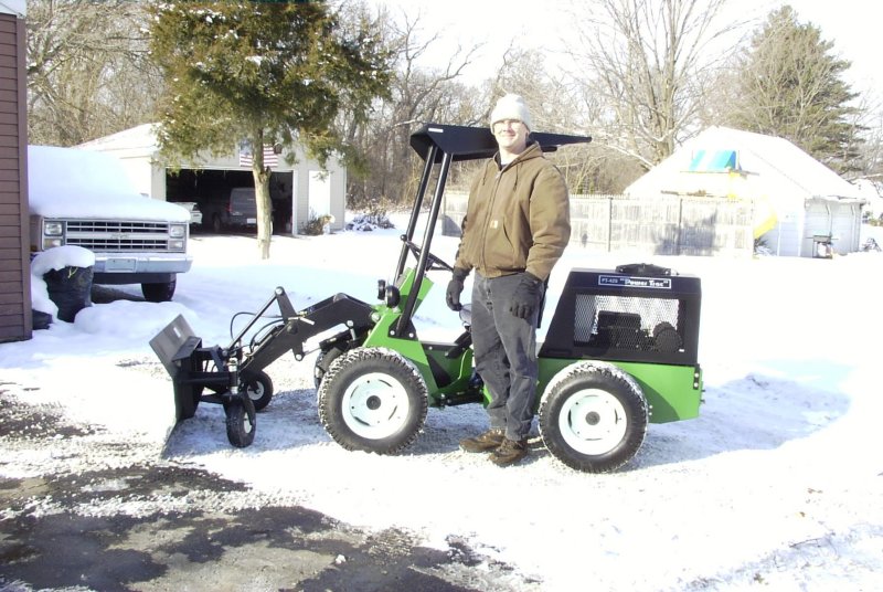

The FEL mounted front blade works best for me.
I use a 7' front mounted blade on the loader, goes on/off quick and easy (skid steer type QA), and works very well.

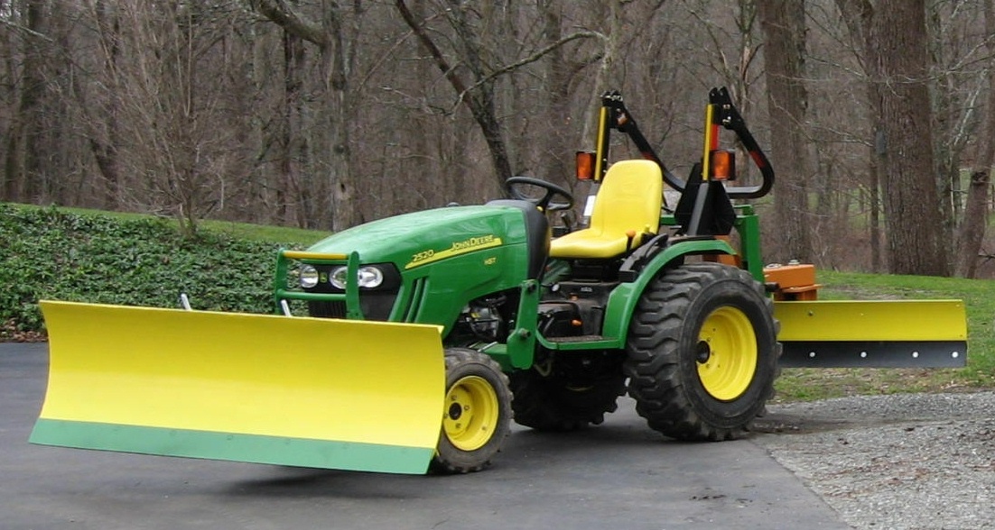

I used this setup last year. Now the rear blade has been replaced with a Metor 75" blower. The banks got so high last year that when the wind blew it drifted over as high as the banks, almost 5 ft.
