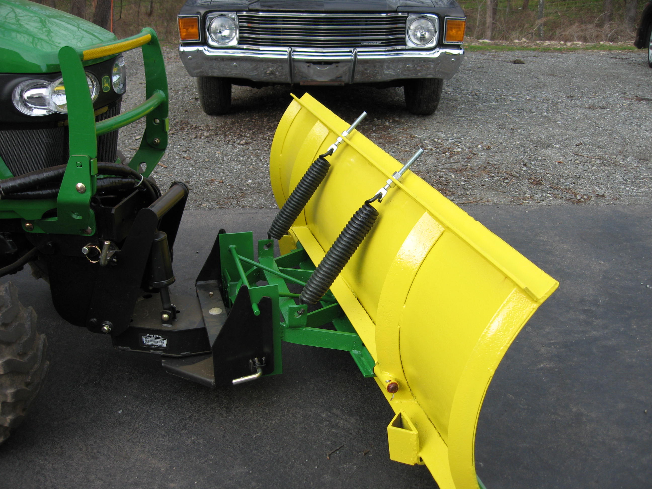

I bought the factory JD quick-hitch/hydraulics (+/- $550), then found a donor Meyers 6ft plow and adapted it to the quick-hitch for about $50.

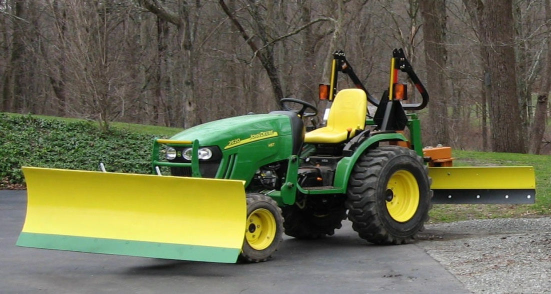

I move the 20" with my front blade, then use the rear blade to clean up and push the snow back a little more!

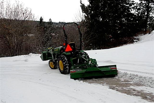

The rear blade FEL combo has worked well for me too. Depending on what I'm doing I use both at the same time, esp if I'm doing my parking area. You can move snow forward and reverse.
I use a 7' Frontier rear blade on a 3720 and a 6' on a 755.
A front blade was nice to have but I found R&R the front blade and its subframe assy just too time consuming when you have a FEL.
