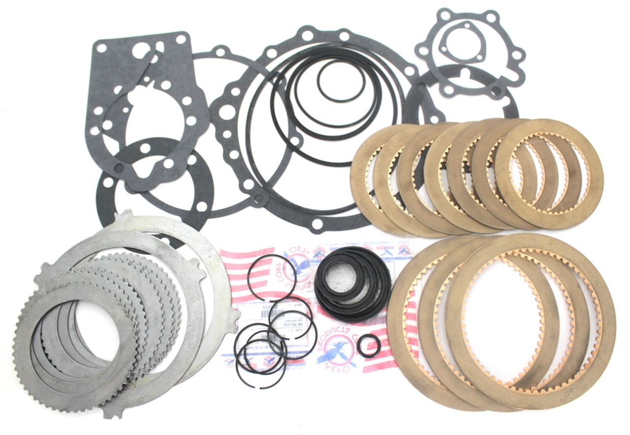

Has anyone sourced clutch
friction disks for the shuttel shift transmission on these chinese dozers? I've been told to call a couple different companies with no success. Seems like nobody can get them. Just wondering if anybody has actually ordered them through a company and got them in hand or is there a friction disk that someone knows will work?

Circle-G and Brismac.

I would also consider Velvet Drive marine transmission discs as an alternative if their dimensions match.

I will try the company names you listed. I can not find anything online with the same size ID and OD measurements as what I have. I even checked about trying to get them recoating with the bronze but have had no luck finding a company that does this. Really sucks. The friction disks that are in it are sintered bronze and are not terribly worn but I thought since I'm opened up I might as well change them out for new. Hopefully the couple company's you listed can get them, and if not she's going back together as is. Thanks Bob

No one seems to be able to get them they have 60 Teeth and have a ID of 3.50" in with a OD of 4.75" in.
